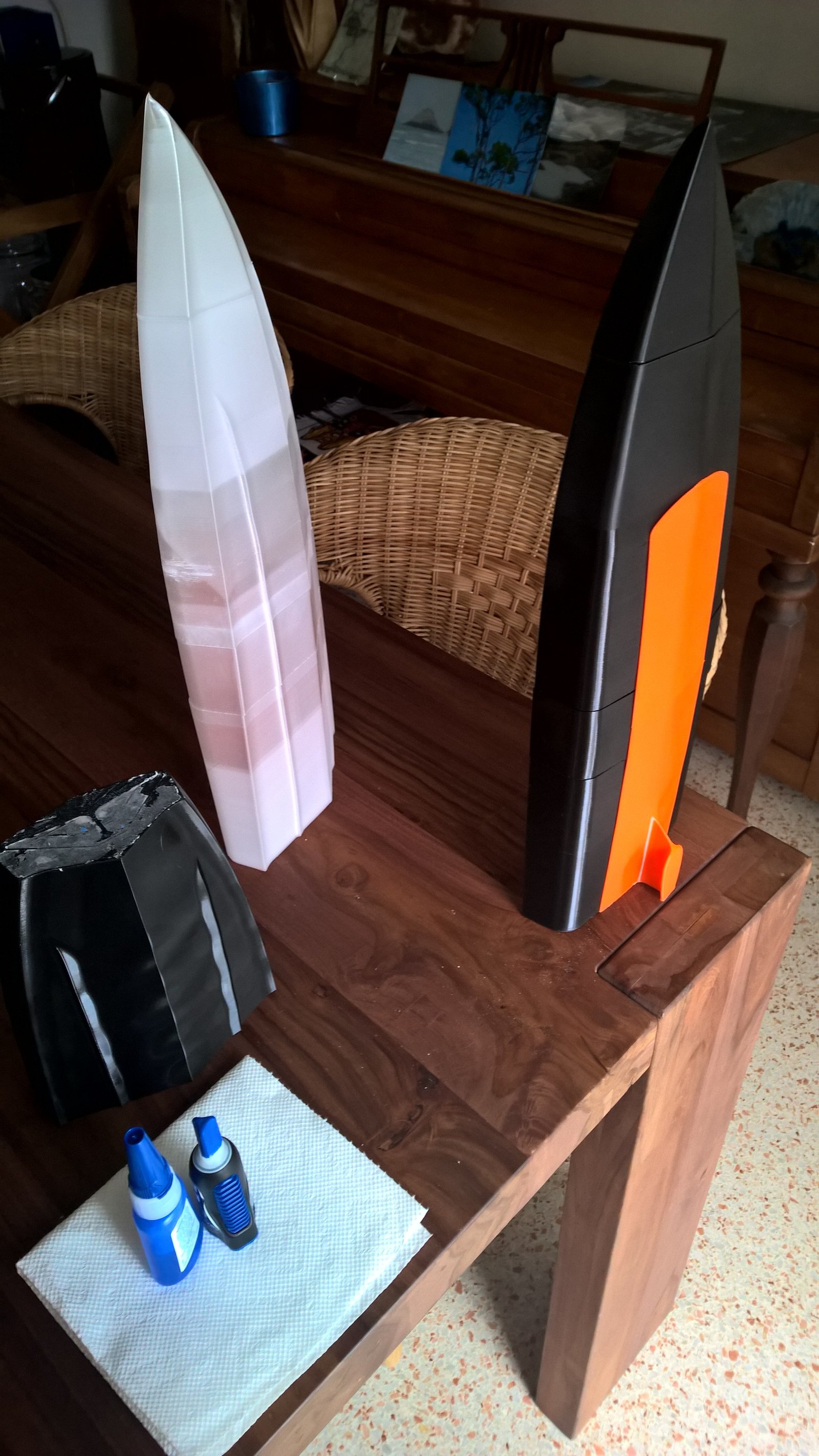

PET is one of my favorite materials but can be a little tricky, especially if you don’t know its limitations. It is best for solid things that need to be strong. While I have had success printing single wall with spiral vase method, anything with thin structures or small details will lead to frustration. Bottom line, if the print involves more than a little retraction you will have a tough time. For temp, just like any other material, increases heat untill it oozes out the nozzle on its own and dial back. That is your starting point and when in doubt, increase heat. Two more tips, print with a large brim to avoid warp and print slow. I included a picture of some single wall boat hulls I printed to give you an idea of what’s possible.
Good luck!
