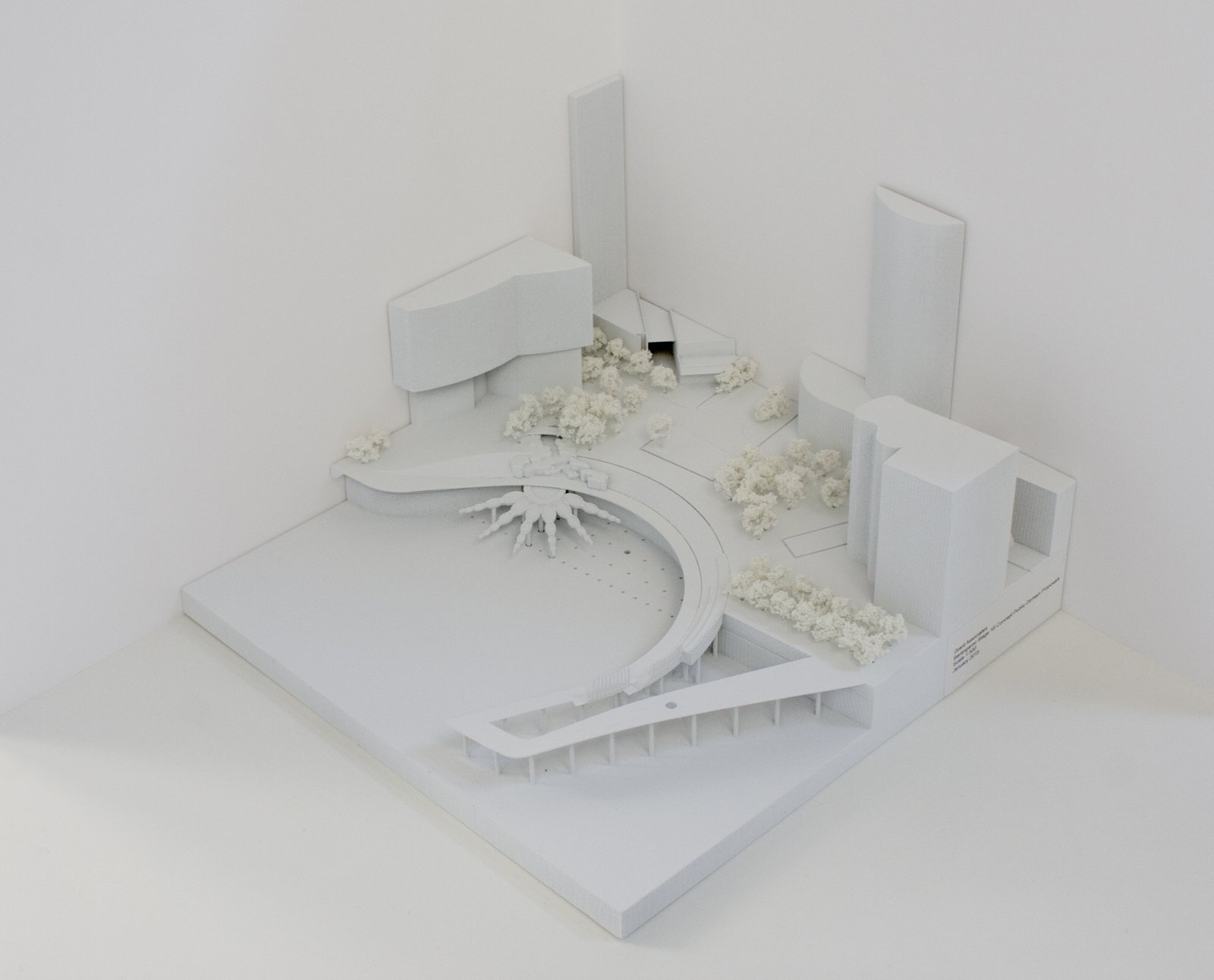

One query, suppose I wanted to print some of the typical work shown with a Wanhao Duplicator 5 or the Creatr XL would I have to rotate the model 90 degrees so that it renders it length ways where this kind of printer has the larger build volume, if it’s printing buildings for example that have been rotated 90 degrees will they have enough support? If that’s not well explained please let me know and I’ll post an image.

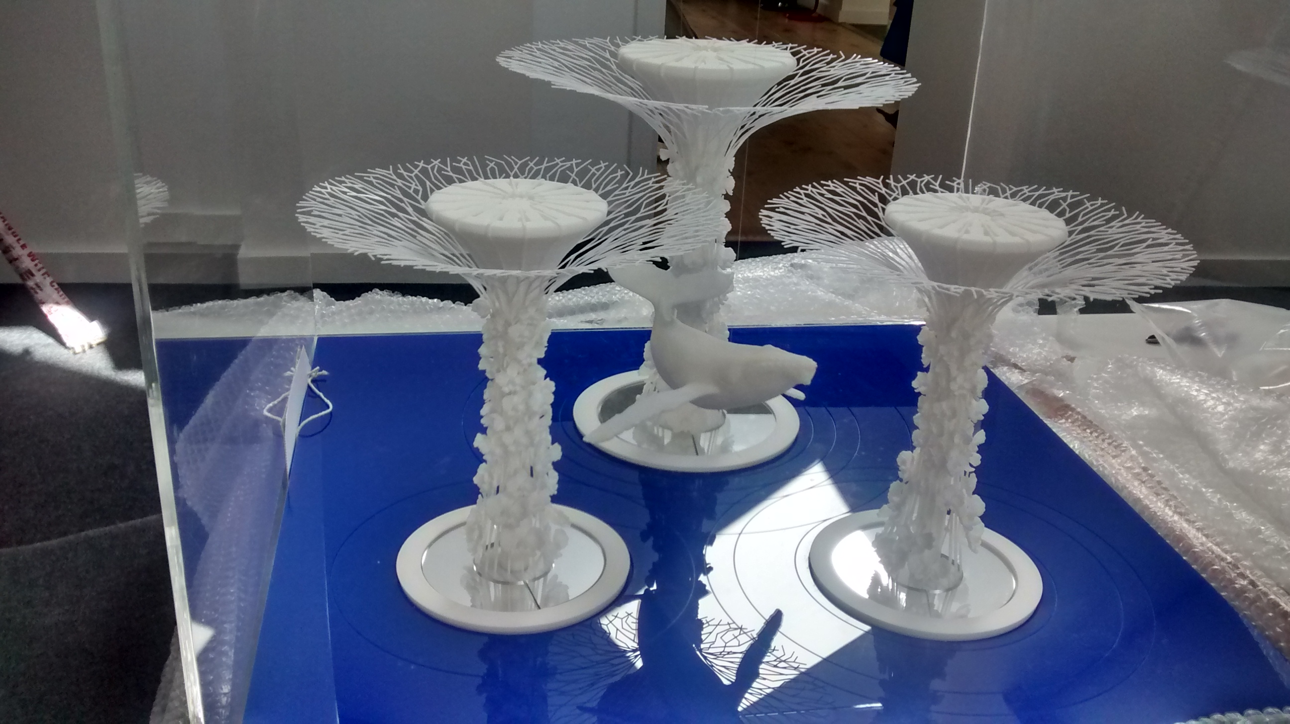

I have attached a sample of typical work we’d need to produce and also a not so typical piece of work which is the print with the tree forms, though we often do organic forms so we might need to print all sorts of forms. Am I right in thinking that an FDM printer might have issues with overhangs/undercuts or is that more to do with the skills of the person working on the mesh/printer?

Can you tell me the outer dimensions of the first picture? Especially the bushes (or whatever the yellow-white stuff should be) would turn out much better on SLA printers. I’d go for the Creatr XL or Creatr HS and an form 1+. The Form 1+ is way smaller in build volume, but better for detailed prints and very tiny features. You could print a base or similar on the Creatr (either version) and add details with the Form 1+. M preferences would be the Creatr HS as it’s more faster and generally more comfortable to use (standalone printing via USB). The XL is just the normal Creatr with extended Z height it’s still fairly slow and doesn’t have that greatly designed mechanics. I own an HS and have designed and machined my own.printhead. So I’m using the Creatr HS motion system (which is very nice BTW) and have added higher quality hotends (by e3d) to enable a wider variety of nozzle sizes (resolution) and more flexibility in material choise. Depending on where you live I could not Only share the 3d files to make that printhead, but I could also install that for you, leaving less room for errors. If you’d like print samples from my Creatr HS, then just contact me via my hub by clicking on the icon below. Cheers, Marius Breuer

The outer dimensions of the first picture are 300mm x 300mm, it’s all 3D printed apart from those yellow-ish bushes, for smaller features like cars/people/trees we would just buy them, much cheaper, so we probably wouldn’t need Form 1+ - not saying it wouldn’t be nice to have.
For the second picture of the tree kind of forms, the largest one was 300mm high.
