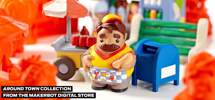

I don’t have the slightest talent for all this paint magic, but my wife sure does. She uses a primer spray on the models first. There is a brand especially made for miniature painting (eg: http://www.games-workshop.com/de-DE/Chaos-Black-Sprühgrundierung;jsessionid=B2C62C716B5B29F644A507895F3D252C) . Then she paints on it with revell model acrylic colors. these are quite expensive, but the results are very nice:
https://thingiverse-production.s3.amazonaws.com/renders/9f/84/b5/22/ab/td_on_mars_display_large.jpg
Image of a painted model.
