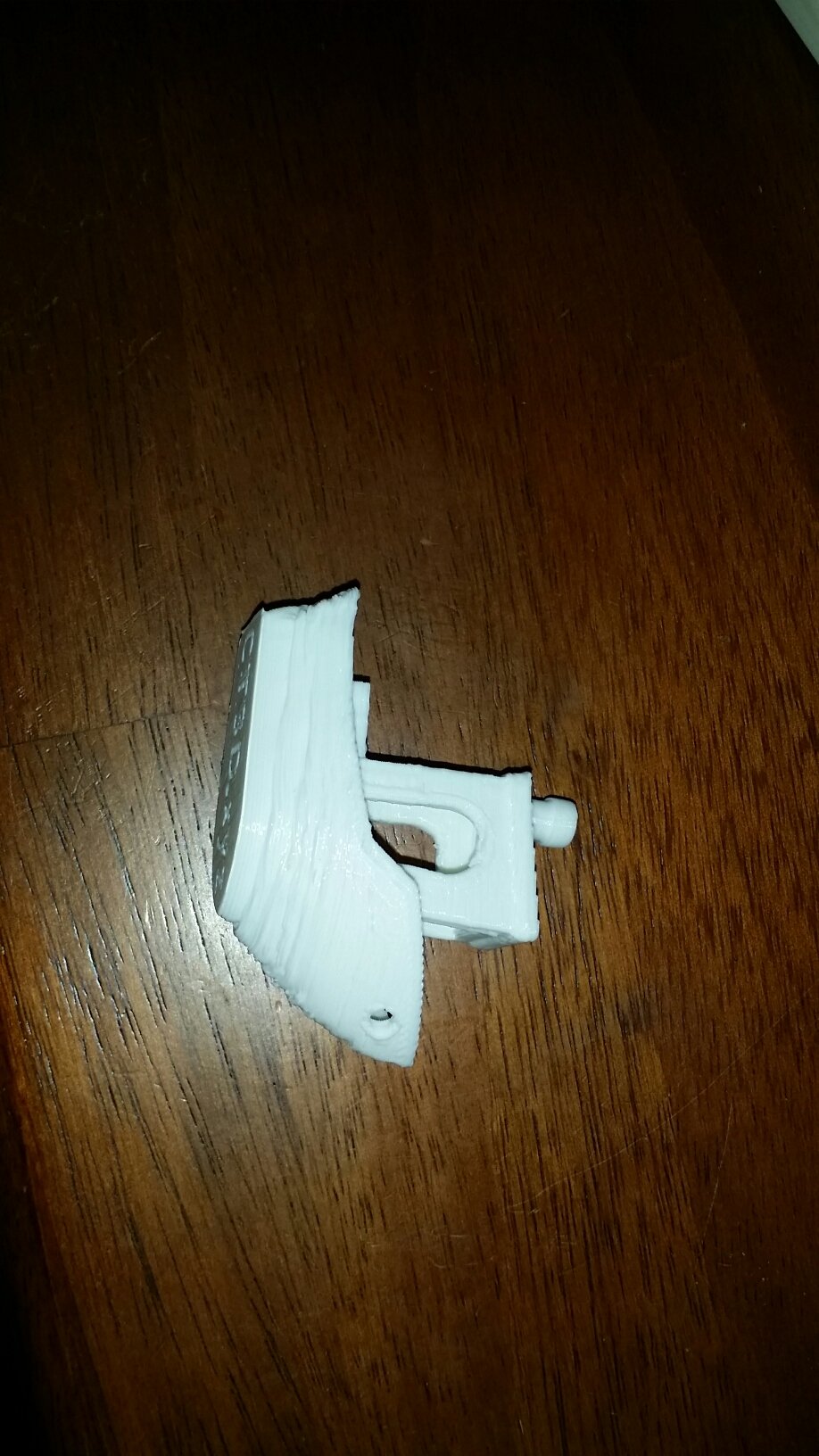

Afternoon all. I’ve started trying to print 3d Benchy tugboat as a way to verify print quality on new materials (#3DBenchy - The jolly 3D printing torture-test by CreativeTools.se by CreativeTools - Thingiverse). I started with PLA since its the material I’m “Best” in and the results are humbling.
Attached is a photo. Before I even get into if the dimensions are good I have to address the terrible state of benchy’s undercarriage. Any suggestions?
Note: I’ve printed twice at widely different extruder temps with the same results. Bed temp is 70°C, no supports, and fans are off. I am keeping fans off because they tend to warp larger prints beyond usability.

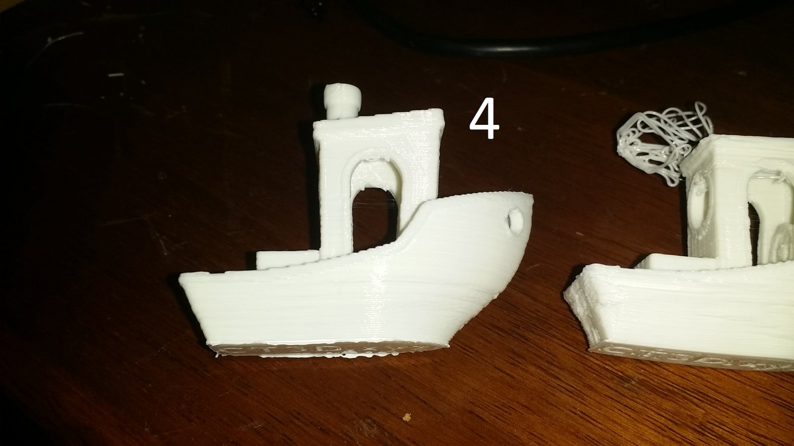

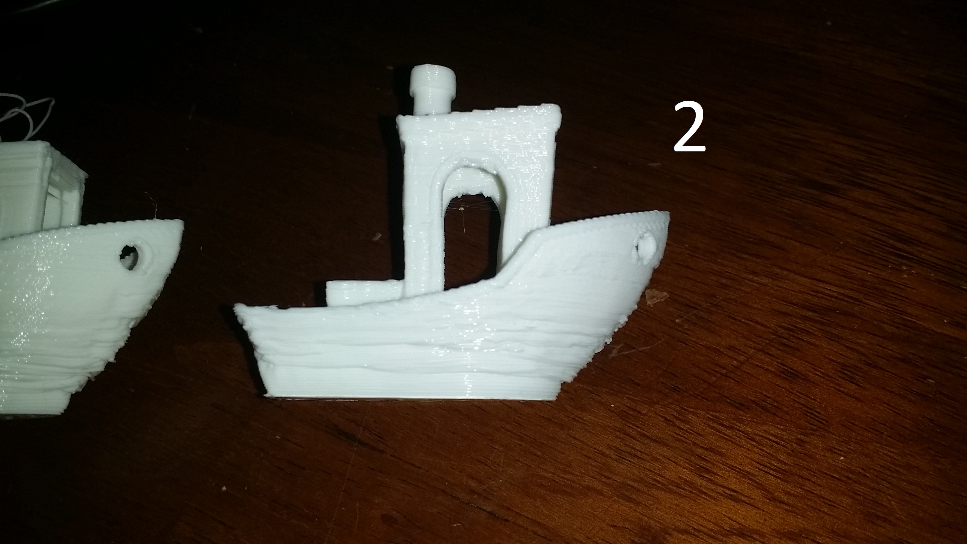

Print 2: benchmark. fans off. no min time per layer. awful but finished.

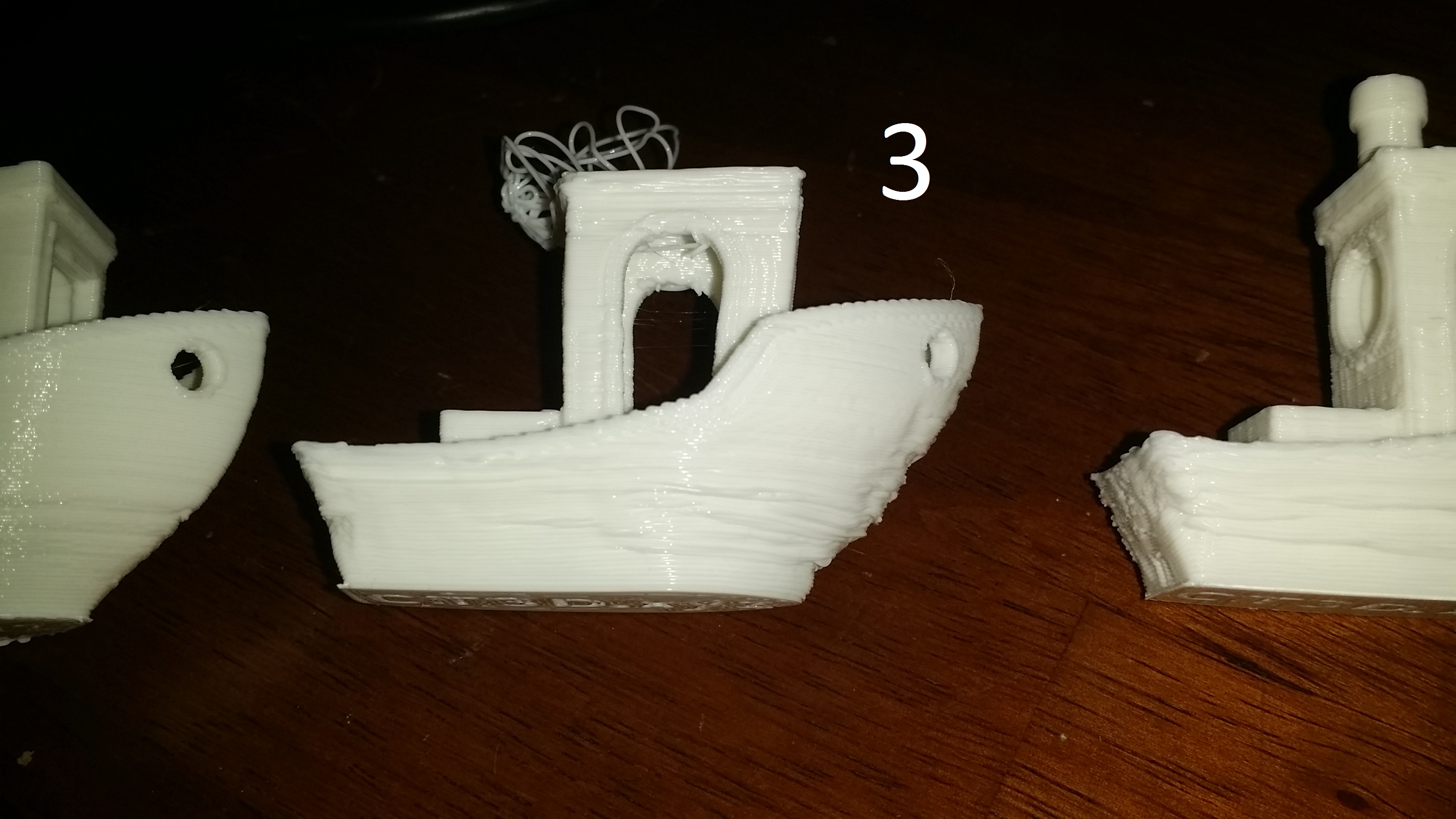

Print 3: fans on after layer 3. no min time per layer. failed before print completion.
Print 4: fans on after layer 3. min time per layer 1 min. way way better.
So the problem was that the previous layer didn’t have enough time to cool before the next layer came down. Thanks everyone for your help. I’m going to take dimensions on it and post to this thread.

Photo is not that clear, so I’m guessing over extrusion; check your steps per mm value on your E stepper motor
Also looks like layer shifting upon on one axis so check your belts are tight.

Second this as this reminds me of prints I was getting when I was printing PLA small objects with no fan. The plastic was not having enough time too cool before the next layer came around and hence previous layer would get pulled around by the next layer. Corners would curl up as the previous layer wasn’t cool and solid enough to pull the heat out of the next layer and hold it in place as the head continued on. Currently for small objects I run the cooling fan 100% the whole time on PLA and am getting wonderful prints finally.
