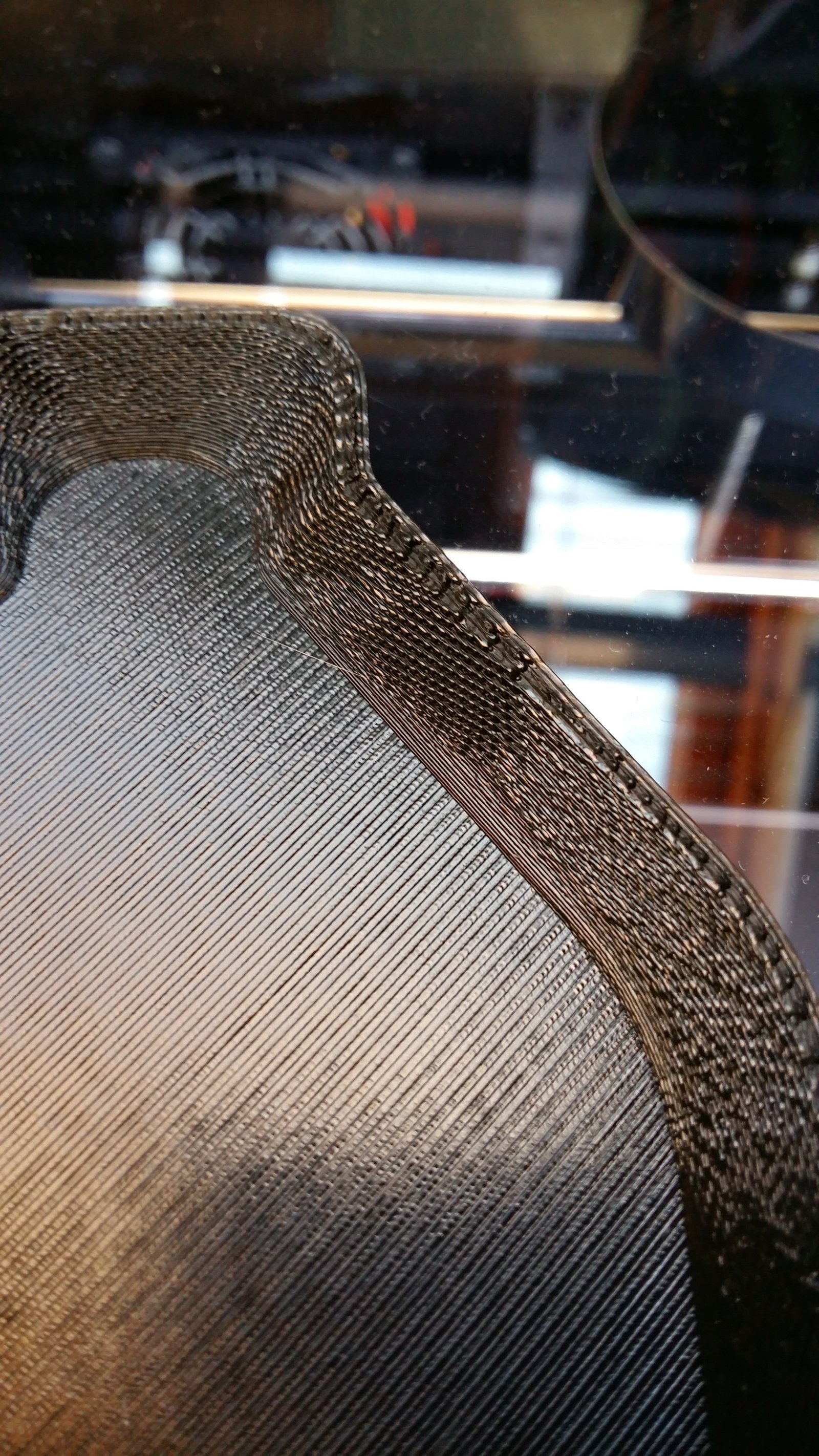

Over extrusion solid infill

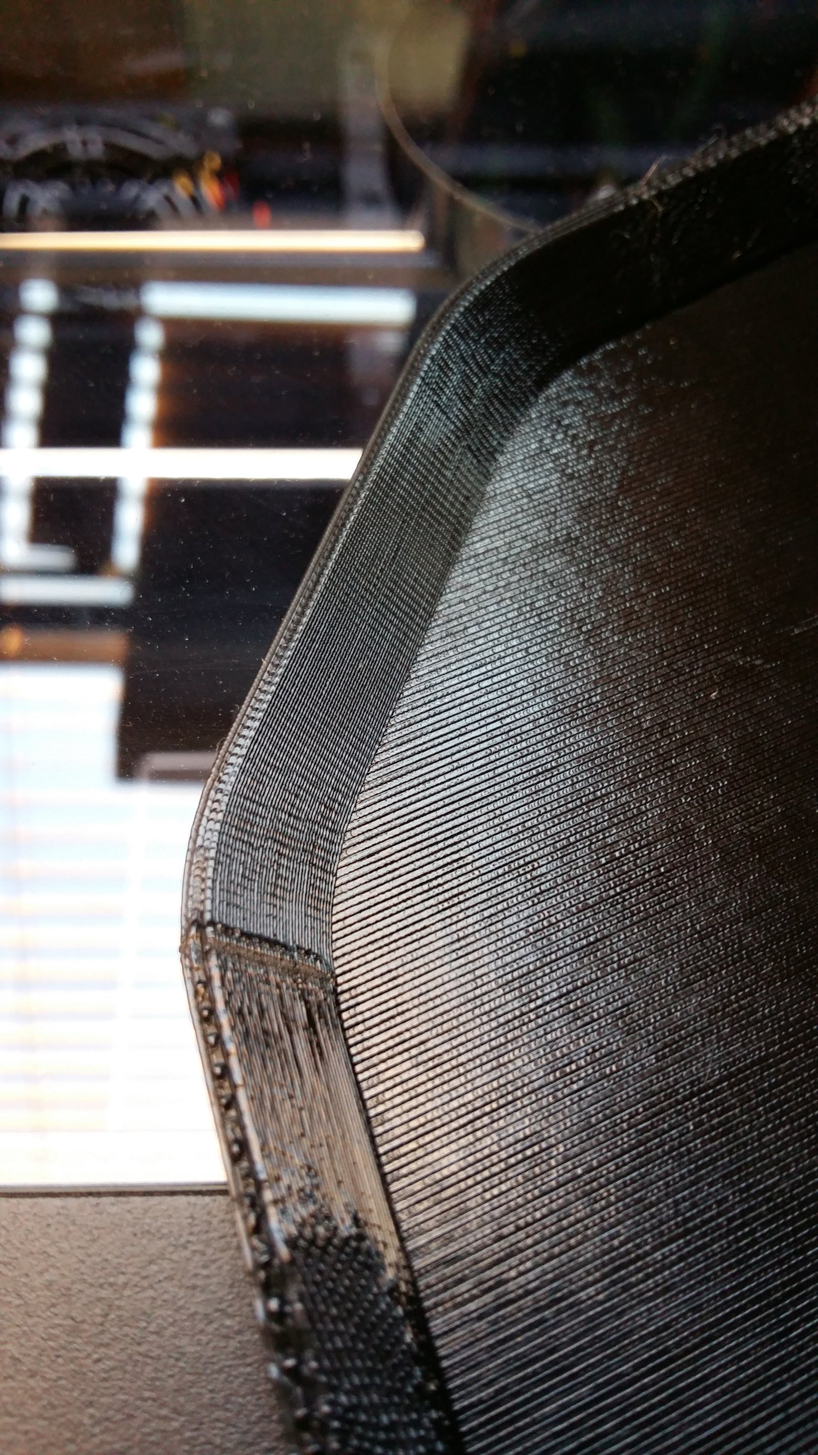

My problem is that the printer extrudes too much material between the perimeters (solid infill):
but if the wall doesn’t needs infill, because of its width, it’s perfect:
This over extrusion only occurs at certain wall thicknesses, and I couldn’t fix it. I tried to adjust the solid infill width 0.67->0.4. I tried to set the perimeters/infill overlap 15%->0 , etc.
I usually print with 0.9 extrusion multiplier, and it works in the 99% of the time, except in these situations. I tried to lower it to 0.8, but it just slightly changed the thing.
Is there anybody who could help me?
