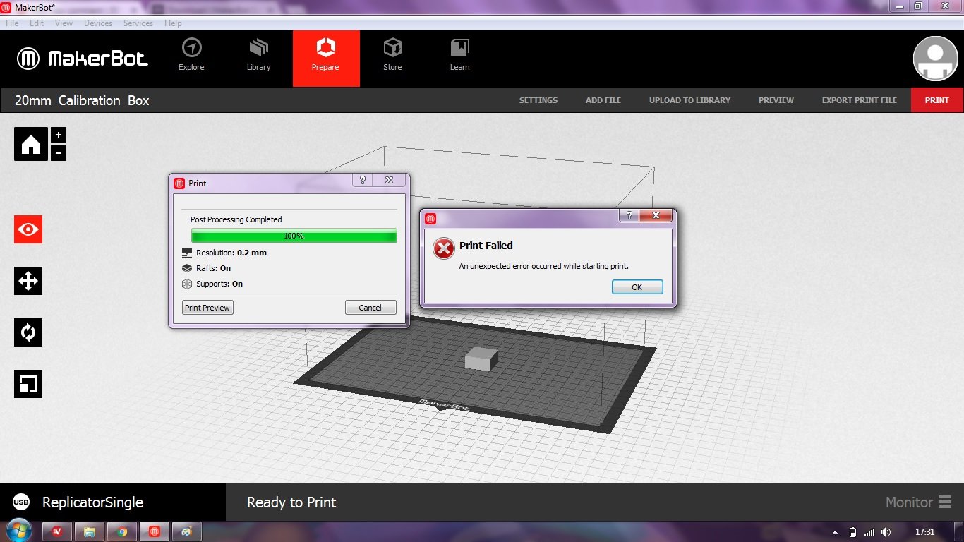

I installed software from Makerbot but when I try to print from Makerbot Desktop it gets to 54% then says that the prit failed

When buffering to the printer, it actually goes to the “post processing” phase and then says it fails.

It’s possible there is something wrong with the stl file. The Desktop App has example files. Try printing one of those. Start with the 20 mm cube.
Didn’t work. Printing from the Desktop app, just got the “unexpected error occured while starting print”.
