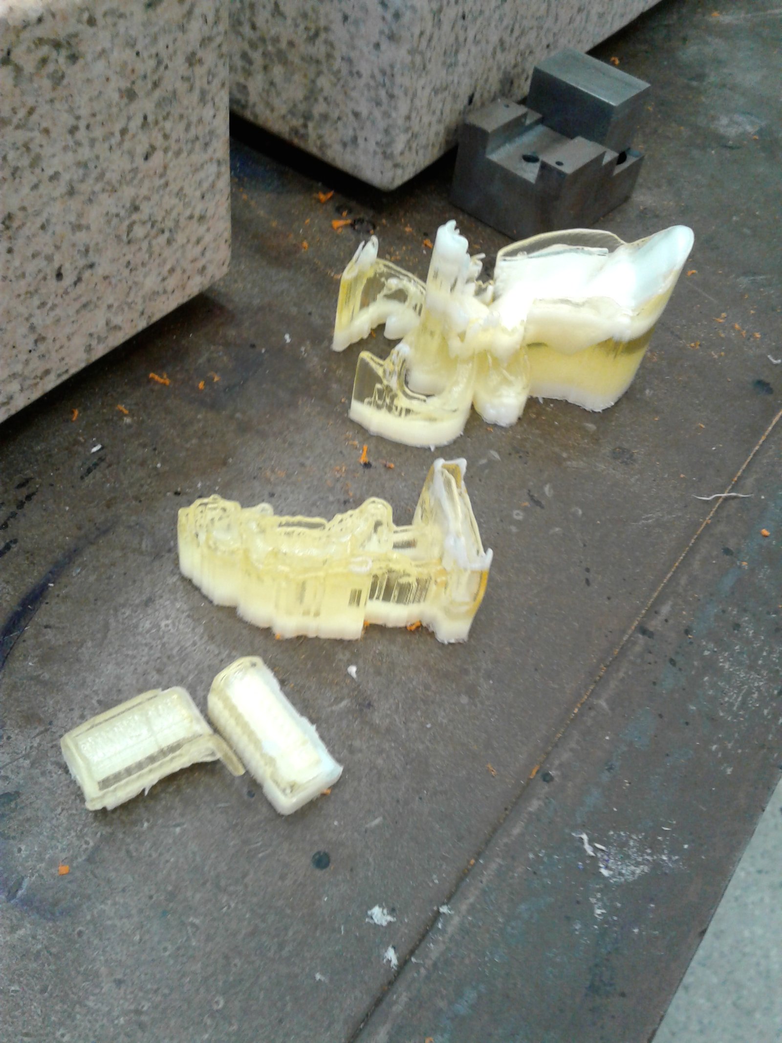

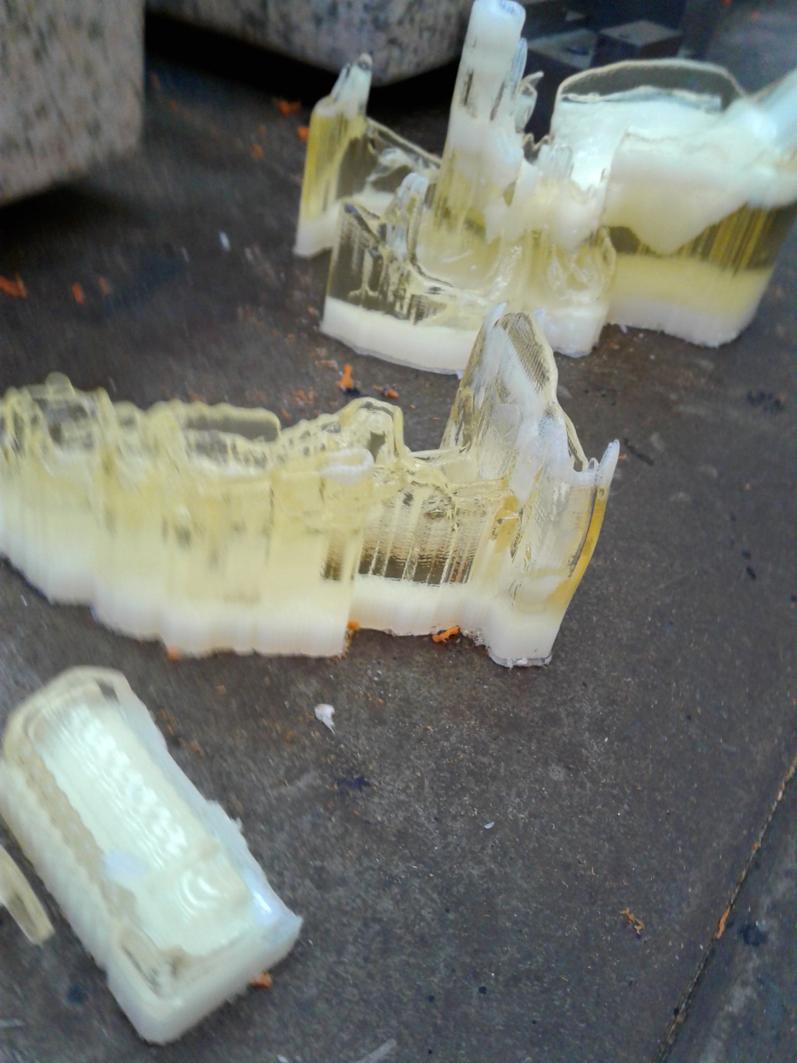

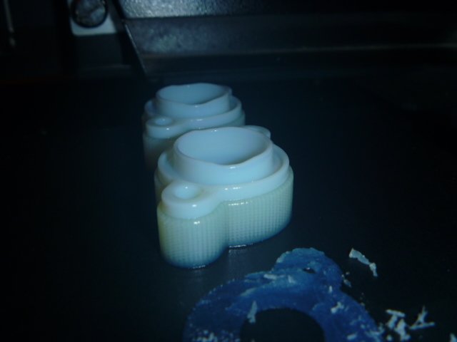

We have O24 for two and a half years, and we are having some trouble with printed parts. The most common situation where the problem appears is when we print parts that have “tubes” in vertical orientation, in glossy option. It looks like VeroWhite doesn’t fill the part, it looks like melted. Another thing, is that it usually happens when more than one part is printed together. Here a photo attached showing the problem. Does anyone experience this? Thanks!
How often are you restarting your main computer thats running the objet printer? We’ve had “encoder” issues that causes some bad prints that look like this. To fix we’ve been restarting both the main computer and objet studio computer once a week. If that doesnt work - How often are you cleaning the heads? Thanks.
It happened to me too and the problem was fixed after a reinitiate procedure. Restarting both server and printer pc’s is also a good thing but will do nothing for the print heads if they are partially beginning to clog.
Thank you both for your responses. About cleaning and restarting, I keep a regular schedule with these actions. Cleaning every time after last printing or several consecutive prints. I also do wipe cleaning, purging , pattern and aligning almost every week. Not so sure about weekly restarting, but I do it. Another thing is that model head has began to make trouble when you see test pattern. Sometimes it takes more than 6 cycles of purging + cleaning until I get a good pattern. I never changed the heads or light

You need to launch a reinitiate sequence that will purge from 20 to 40 grams of material (not support) in one shot. This can fix your nozzles clogging. Sometimes the pattern test seems okay but some nozzles can be partially clogged resulting in not enough material deposited only showing after multiple layers have been stacked.

We had a “Z Start” setting that was too high. It put too much material on the part and it’s wouldn’t harden on a pass. It was really noticeable on thin wall. Plus our roller waste tray would get full and clog. Since it was adjusted the whole machine does a better job.
