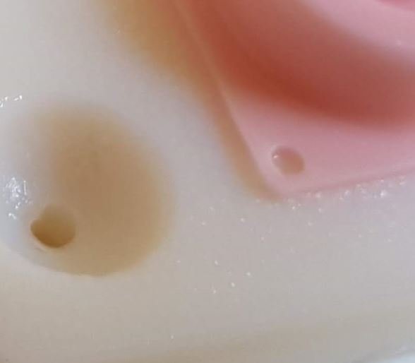

UPDATE 2018-08-20
Below is a silcone part (Smoothsil 940) made with Verowhite (Objet 24) using EaseRelease200 as the mold release . I was able to make this part with two different molds, one was waterjet cleaned and the other waterbath. Both molds were demolded at 24 hours (as per datasheet). The extra material was well cured at 16 hours for handling. The parts were like 90-95% cured which had a wall thickness varying from 1 to 2mm. The film between the mold halves was still sticky :sob::sob: But after a couple of hours, I felt comfortable to remove from the mold. After three days I went to clean the molds. I noticed that the waterbath mold was all cured while the waterjet mold film was still tacky.
Conclusion, there is something going on that inhibits the curing process. This process can work on large parts, but care and patience must be employed and for larger wall thicknesses. If done right, this is a fastest way I know how to prototype. If anyone else has some insight, I would love to hear back!

Some sticky silicone after 24 hours from mixing

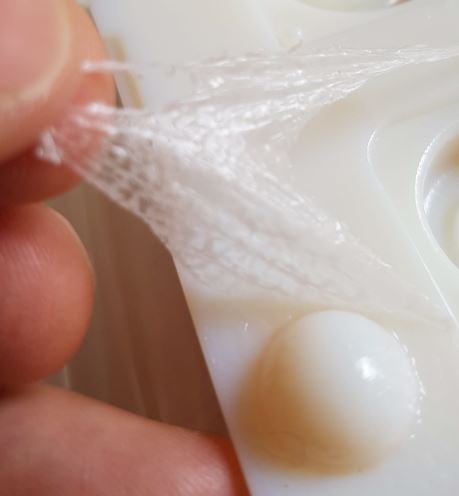

20180820_waterbath_cured_silicone_film_closeup
dried film from objet 24 after 3 days of curing, this was sticky when demolded.
