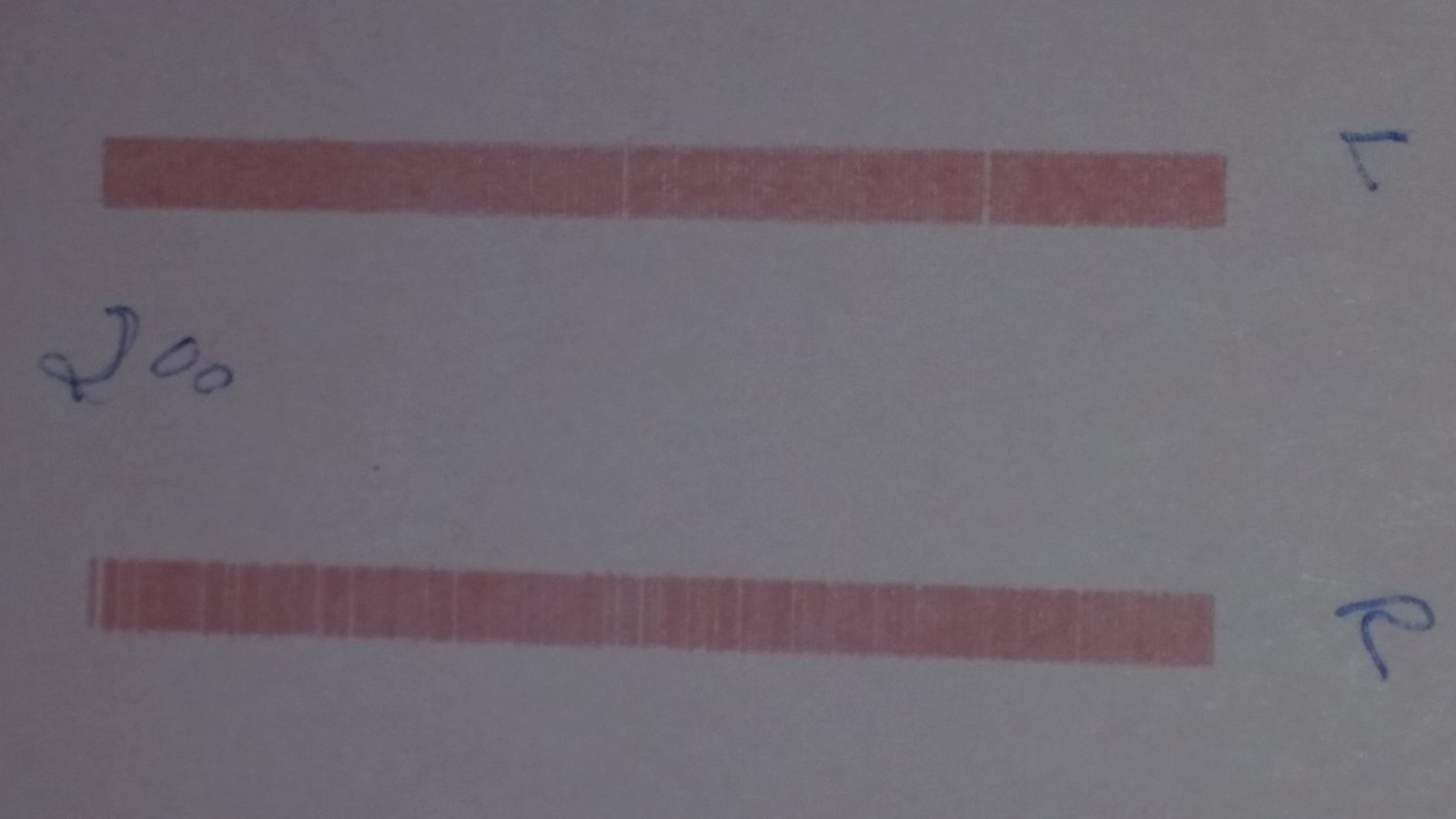

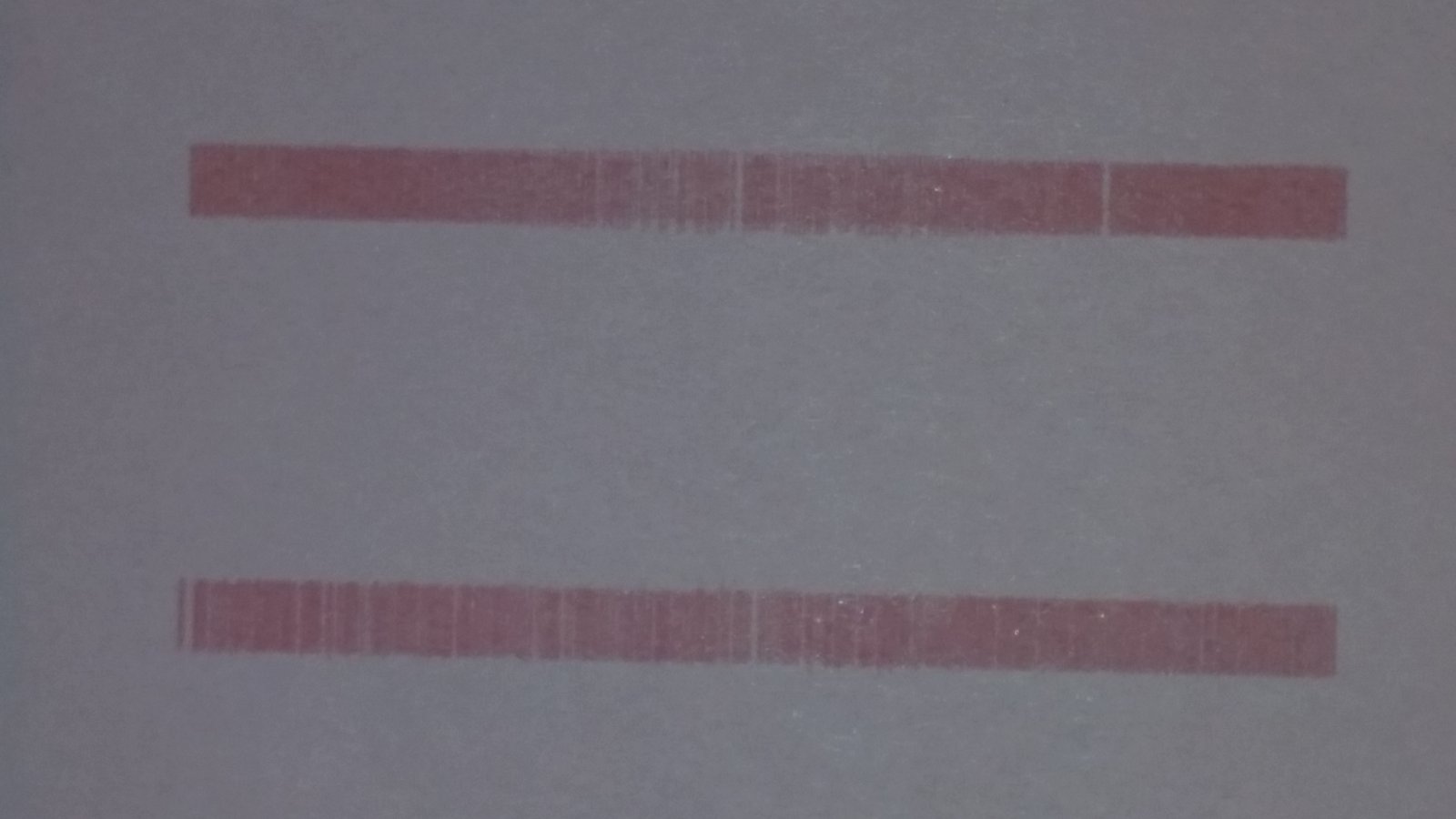

I just ran a pattern test at 1:40pmEST, did a heads cleaning wizard and ran another pattern test at 2pm. See images attached. I think the support (left) has two definite voids. The right head (model) many but they’re spread out. There is definitely a difference between before and after the heads cleaning wizard. I think I ought to run that about 20 more times…! What do you think? Thanks, Juliana
