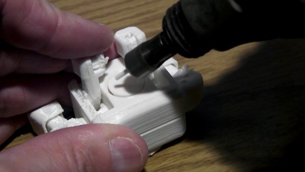

Far as actually gluing Nylon is concerned, same issue, really. Don’t even bother with Epoxy or Cyanoacrylate adhesives. They may stick for a short while but the bonds won’t last for long. I’d say your best bets would be Hot Glue and Nylon itself. Hot glue’s pretty much self-explanatory. With Nylon, what you want to do is put a short length of filament in a Dremel and weld the two parts together with friction. This actually works really well. Maybe best to do a combination of both. Make sure the surfaces you want to bond are really scuffed up, with sand paper. Use the hot glue to bond the surfaces and then weld the seams with the Dremel.

Thanks for all the information! Some guides in the internet recommended a welding knife to heat the surfaces that get stuck together, what do you think about this ?

Yeah. That could work. I guess you mean a soldering iron?? It’s probably a bit smelly and smoky though. If you have a Dremel, I’d definitely recommend welding with that. It’s a remarkably effective technique.
I also thought they mean a soldering iron, but maybe a soldering knife is just like that but with a larger plate instead of a tip, then it would be possible to heat the whole surface easier.
How exactly do i weld the parts together with a dremel ? If i understood you correctly you mean that i should put filament around the dremel head and rub this on the surface that has to be glued ? or how should i get the friction on both parts that have to be glued ?
Maybe you have any link or video as reference
Its called friction welding.
