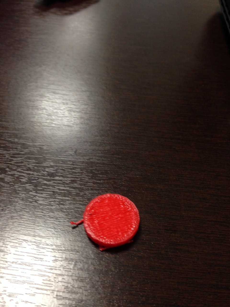

Hello,
Running 1.75mm Nylon @240c and im getting a jam every now and then somewhere, please see the pic for what it looks like.
Thanks for any help
What printer? My guess is trying to print to fast for the extrusion and temp. Here is an interesting read on nylon.
Sorry it’s a robo3d r1+
Don’t be so lazy it would help to add
printer
the speed of print
what slicer are you using and settings
apart from jamming does it click ect
what nylon are you useing
this would help a lot in getting a answer
