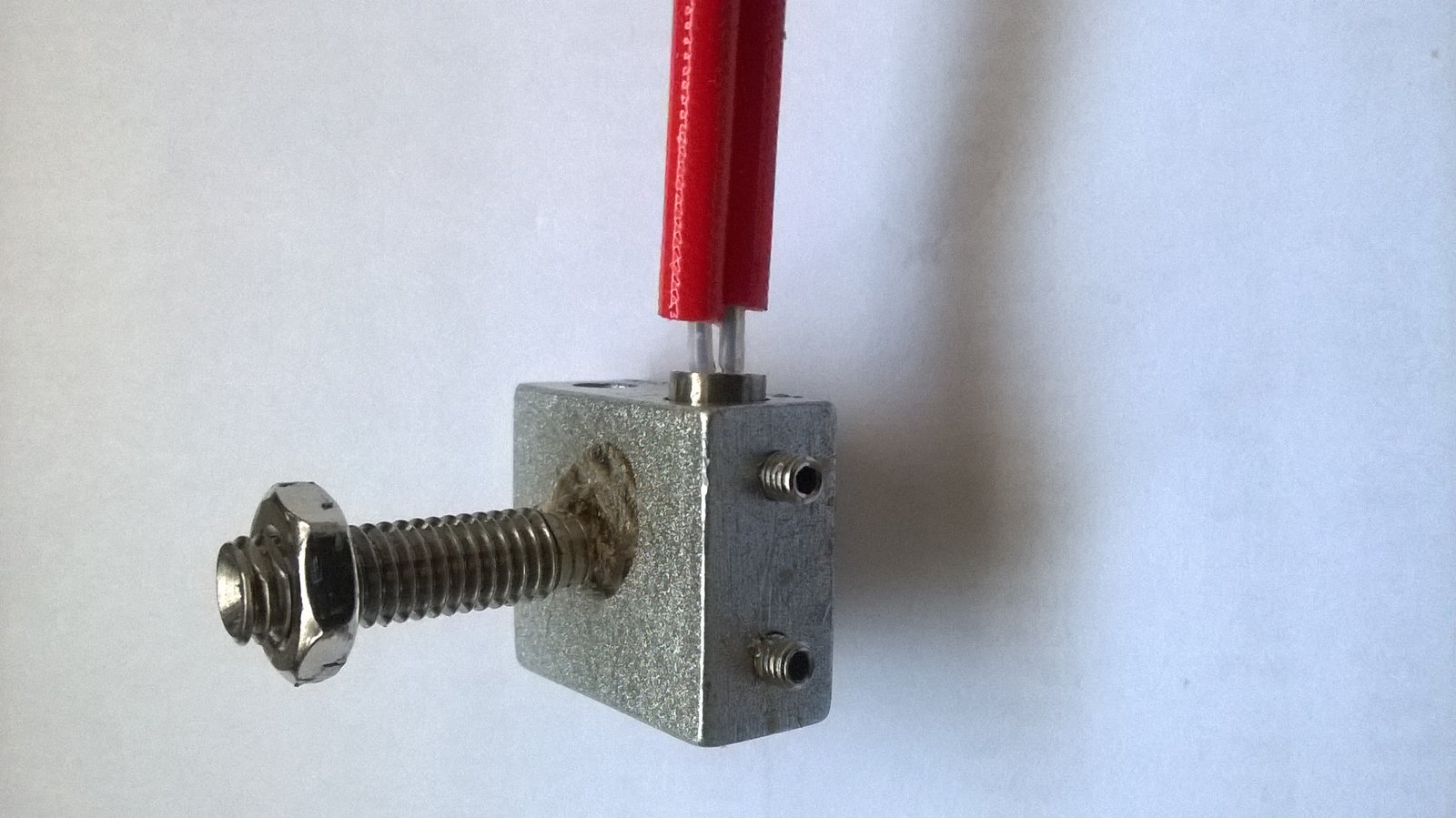

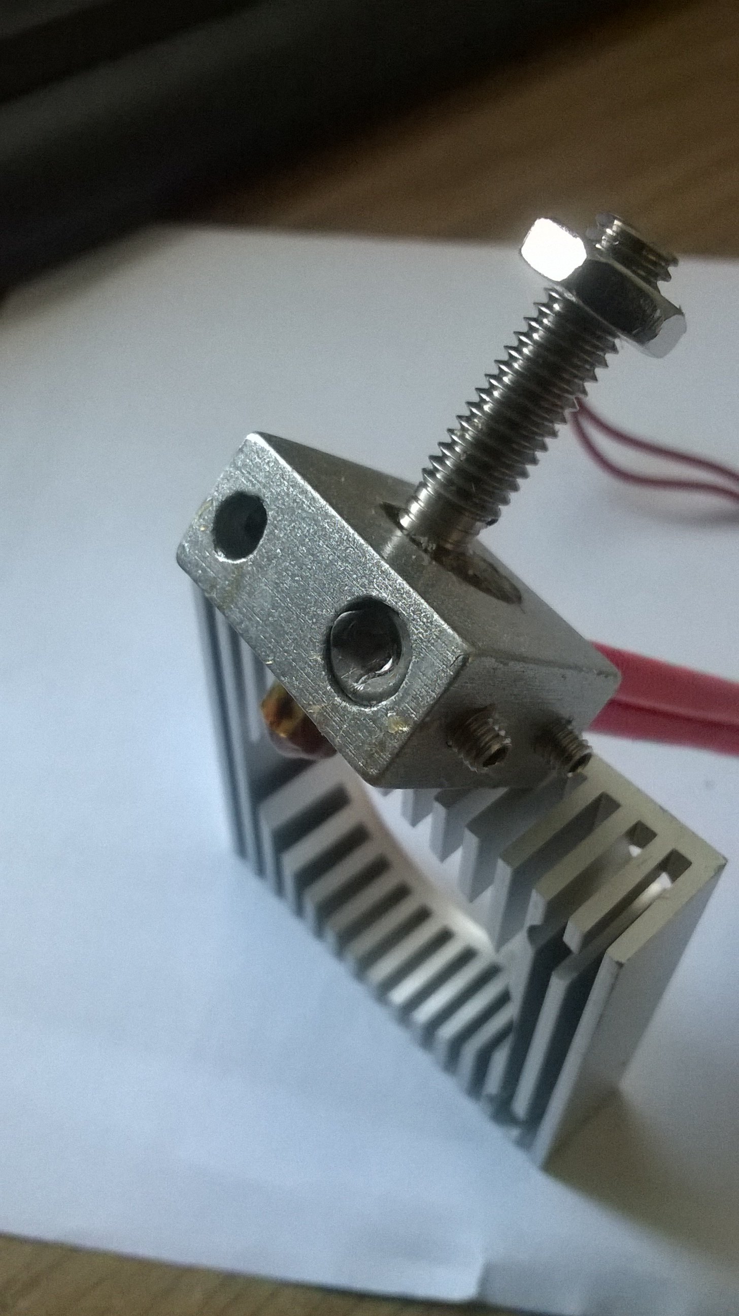

I think you are correct in your diagnosis. The printer is the V3 , I haven’t checked the motherboard. I have taken the print nozzle out of the printer and I remembered that the heater did not fit fully flush with the block when I first assembled it - it is about 2mm proud of it and I couldn’t get it to go any deeper.
I can’t extract the heater from the block.
Also I am not sure if the end of the heater should be concave.
Please see the attached pics.
