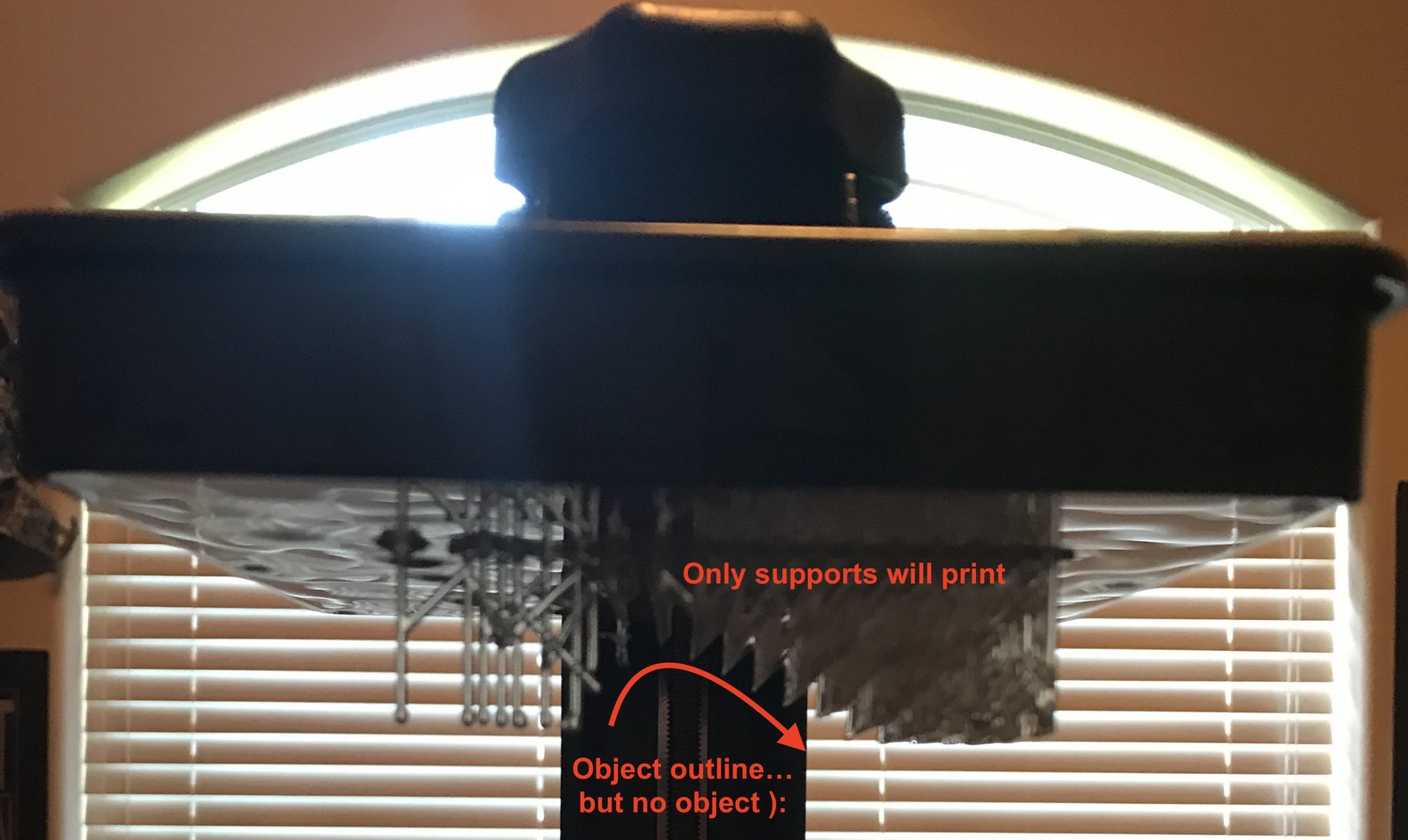

The printer goes through the entire process, but it will only print the supports. I have been able to see the laser and the bed goes up each layer. With my last print, there was a very thin film of cured resin at the bottom of the tank; it looked like it was the beginning of the object forming, but perhaps it didn’t stick to the build plate? It is not a heavy object, so I’m not sure why this is happening.
I tried increasing the power on the Nobel laser to 2+, but this did not make a difference.
I attached a picture to show how it is printing.

That’s not a curing issue, just turn the laser back to zero.
You need to level your print bed very precisely. First take it off and wash it, dry it and check if it’s completely flat, you can compare it against windows or mirrors. Mirrors are better because you will see the reflection and helps you to find any imperfection on the borders. If it’s totally flat put it back on the printer and re-calibrate the bed but don’t follow the instructions from XYZprinting. Unscrew all four screws of the bed before it’s down and touching the bottom of the tank, push the left side down first to the point that if you push more the right side of the tank starts to go down (don’t go too far and let the metal edge of chassis stay in contact). You can see the screws on the build plate in the reflection of the tank, make sure to leave no space on the left side before tightening the two left screws of the bed. Hold your thumb and index finger (right hand) on the left edges while you are tightening the screws with your left hand. This part is very important to get it right otherwise it’s not calibrated. Then push the right side down with your left hand and don’t let the tank to go down and tighten the right screws. If you do this properly you can even print models without brim. I have done this many times on both Nobel 1.0 and 1.0A and works perfectly all the time. Before printing your own model go to thingiverse and try to get a calibration object like a cube or cylinder and print it. Check the dimensions and see if any axis is way off from the others.

Thank you! I will try this ASAP and check back with you. Much appreciated!!
