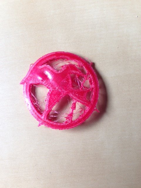

I have tried with: 210°C and speed 20
Tis is the result. Shoud I lower my temp some more or increase it a bit? Or change my speed?

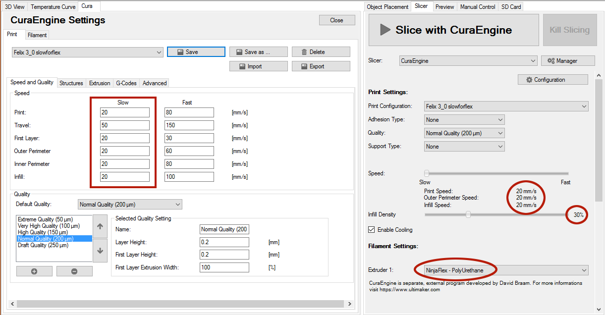

Is this result an improvement compared to your previous settings? As I said, the default cura profile is 200C, can you try printing using the default profile? How did you set the speed to 20? It looks like the first solid layers were printed quite well, but when it started the infill layers things got worse, which tells me that you might have not slowed down the infill speed. All speeds (except travel movement speed) should be set to max 20mm/s for flexible filament. Also what percent infill are you using? I think that you might want to set the infill to 30% and above so that the print holds its shape better while printing because of being a more solid object. Look at the settings highlighted in my screenshot and give them a try.
It also looks like you may want to increase the retraction a bit. I have also found that sometimes playing with the retraction speed can help as well. Too fast, and it tends to just suck up a bubble, and then drool, too slow, and it can leave blobs. Also, make sure you have z-hop enabled, and make it at least 0.3-0.5mm. I have also found that the wipe while retracting feature in Slic3r really helps with strings. Finally, non-print move speed should be as fast as your printer can handle, as this helps to break strings.

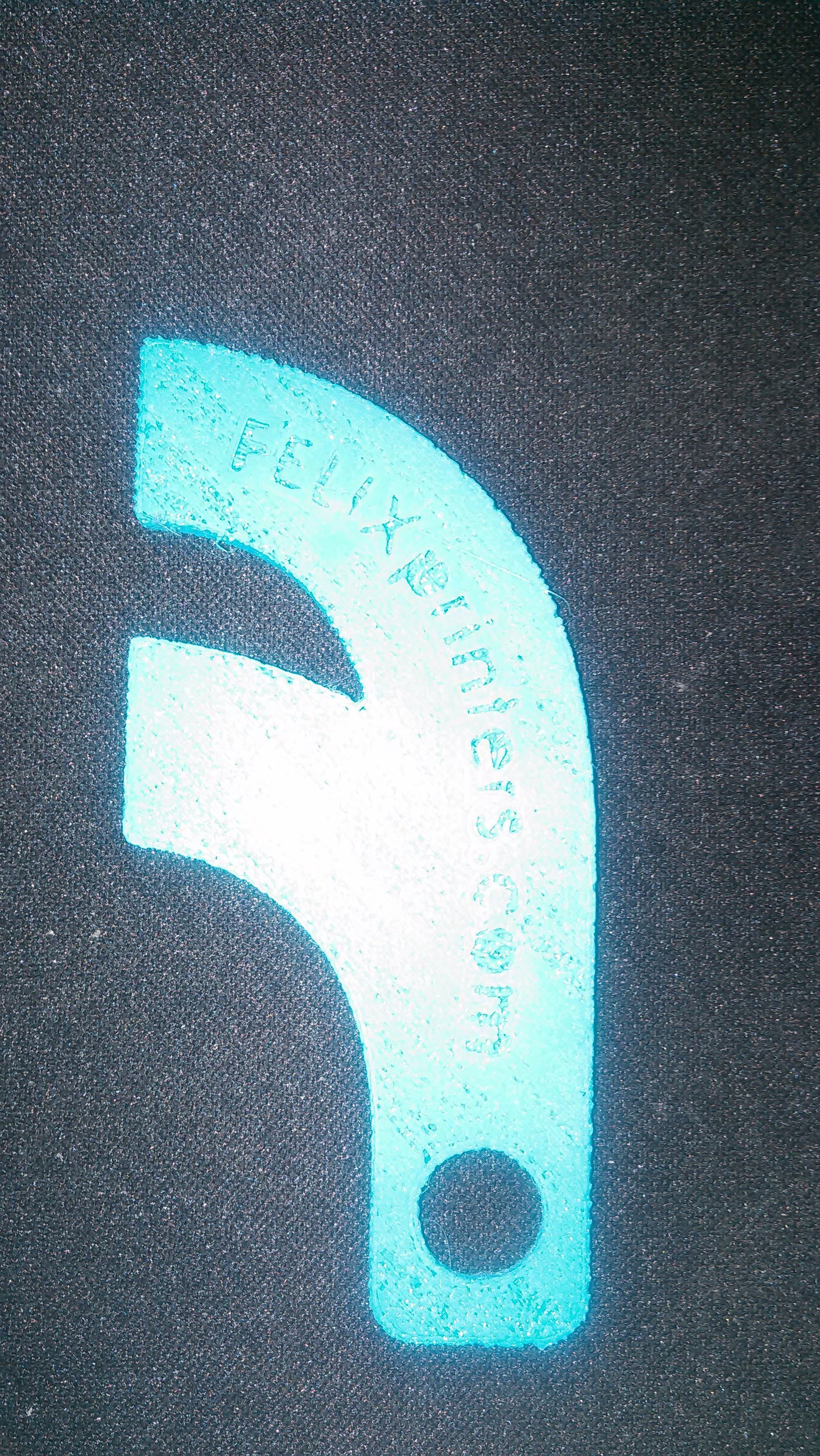

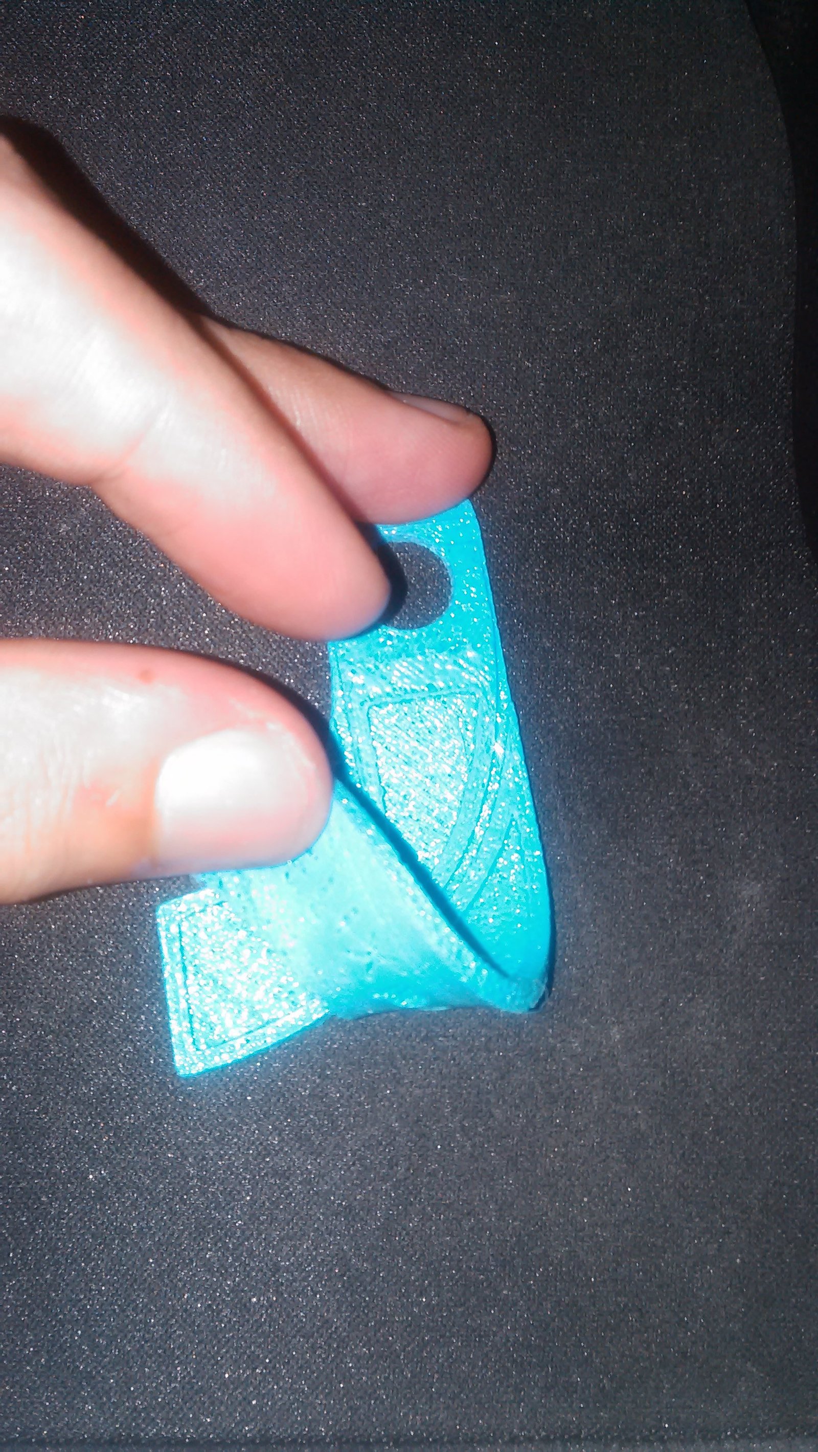

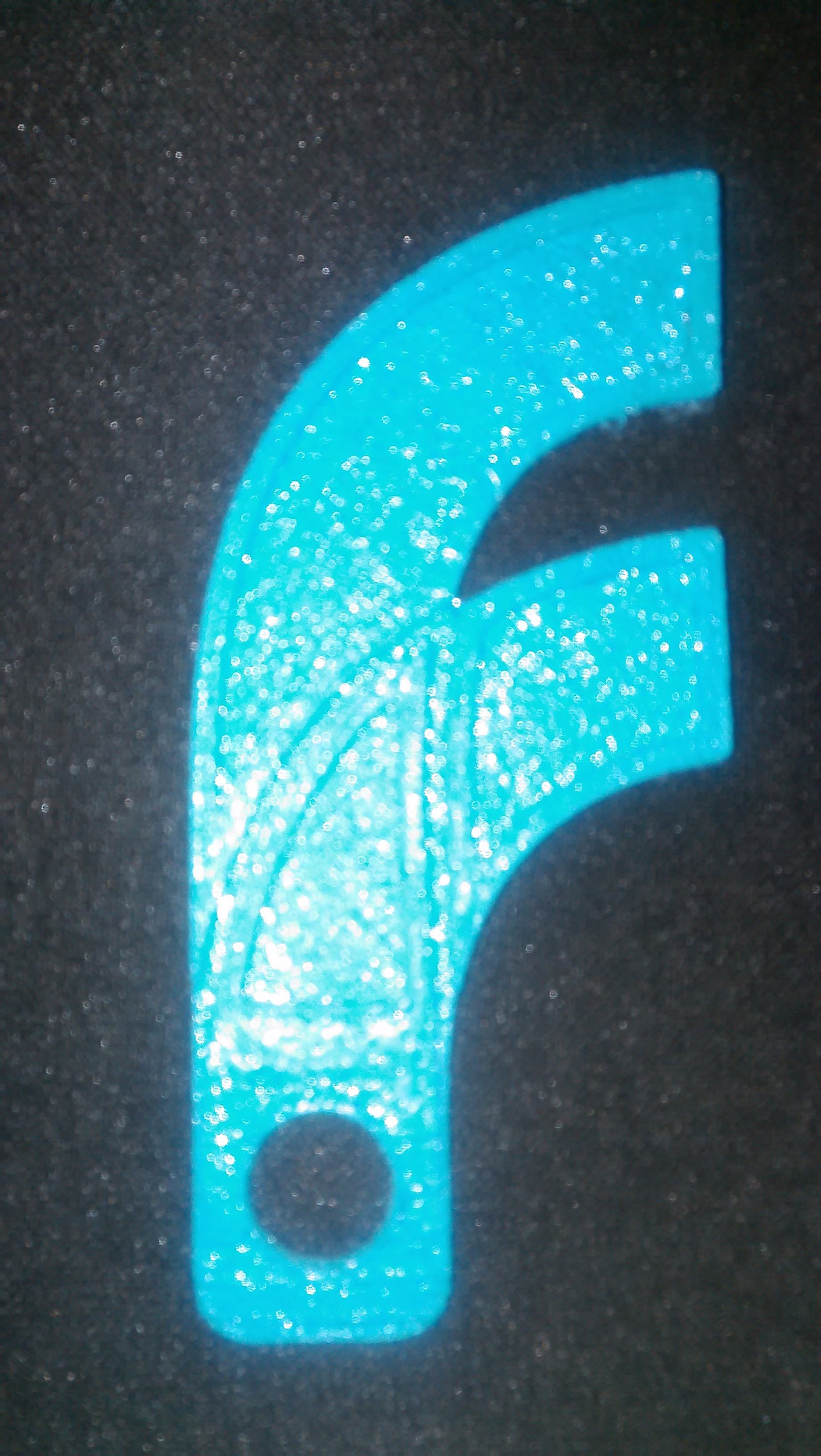

I got a sample of filaflex. The filament specs list 220-260C temperature range.
I did a simple first print (the felix gadget) with the speed settings I suggested.
Slic3r speeds set to 20mm/s, hot end set to 225C and bed to 40C. Flow was at 0.95 and layer height at 250.
Pretty good result for a first print. I think I need 1.05 flow and the end result would be better.
