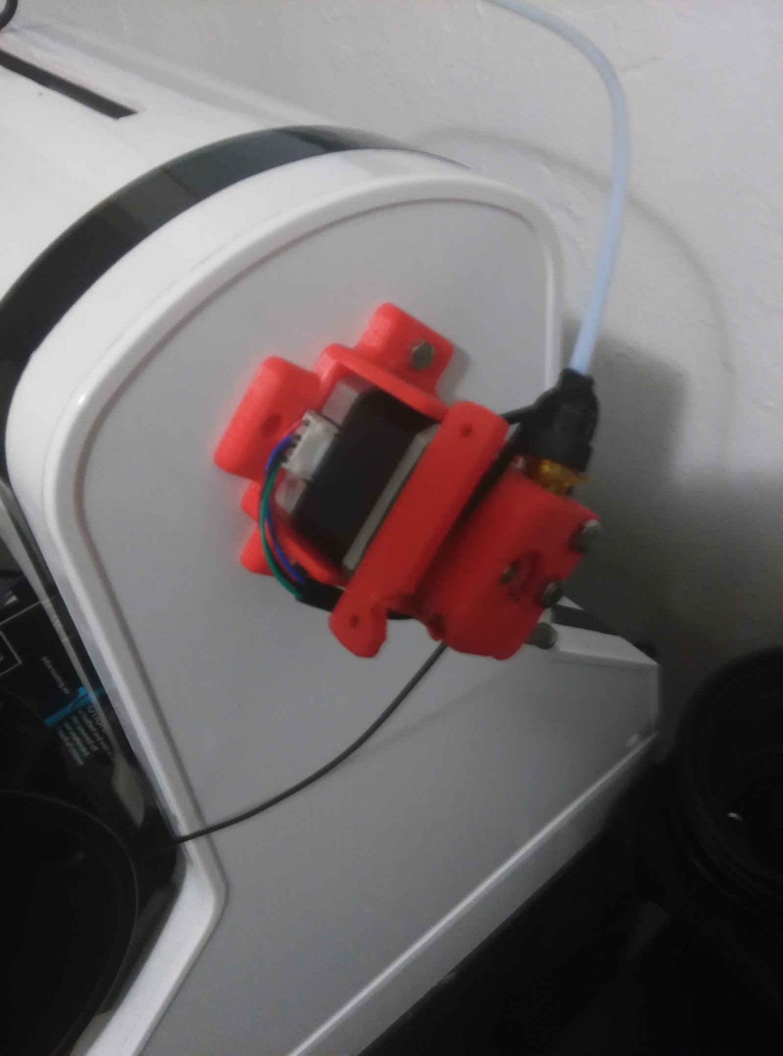

I built a external direct drive and bought a e3d extruder with Bowden attatchment. But note you will have to callebrate direct drive to extrude the right amount of filament.

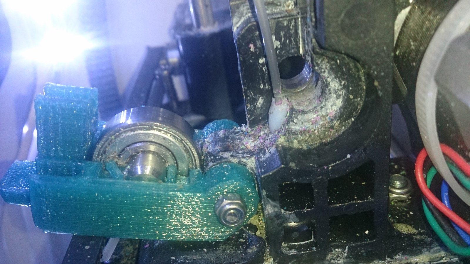

The problem for flex feeding is the large gap between the bottom of the hobbed bolt and the entrance to the hole in the extruder frame. Some people put a small metal bushing (from a ball point pen) in the gap. I removed everything and drilled the extruder out so I could put a Teflon Bowden tube from the hobbed bolt all the way down to the entrance to the hotend.
I still have to run 210c & ~20 cm/s (as opposed to 205c & 60 cm/s for normal PLA). Looks like I need to clean out the shavings again…
