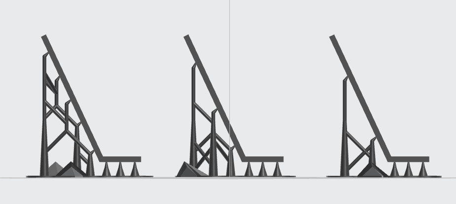

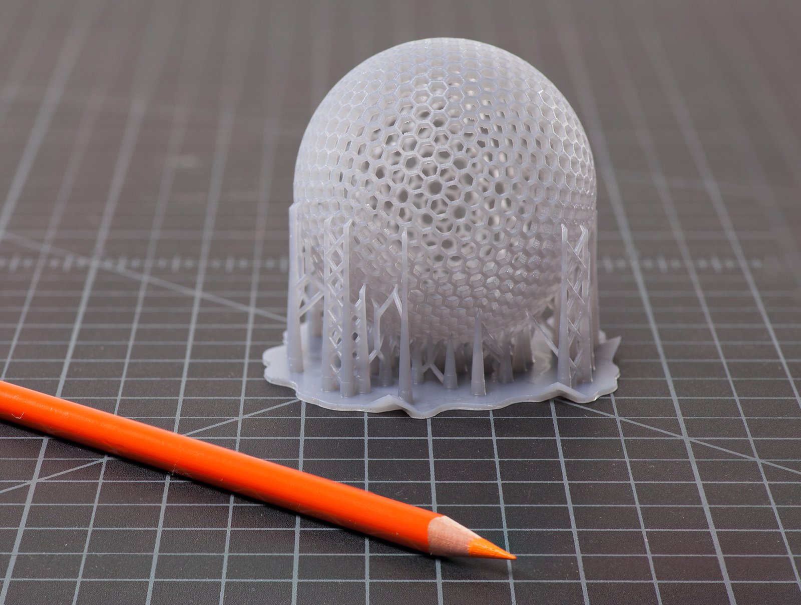

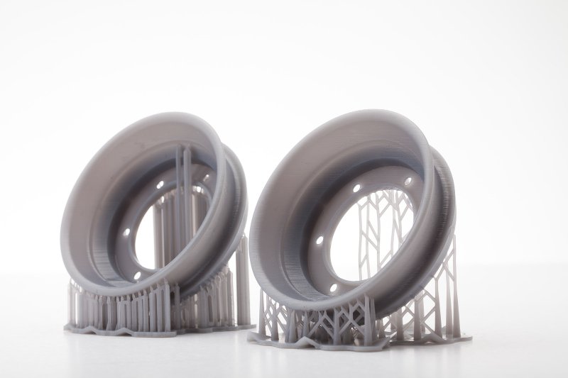

When printing with SLA machines like the B9 Creator and Form 1+ you can spend a lot of time on generating and perfecting the supports, as it has a big impact on the quality of your print. Today Formlabs announced a new release of their Support Structure Design in the PreForm software (info/download). Looking at the pictures it seems they have reduced the material required quite drastically and added more powerfull controls for editing the supports.
