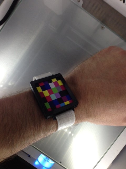

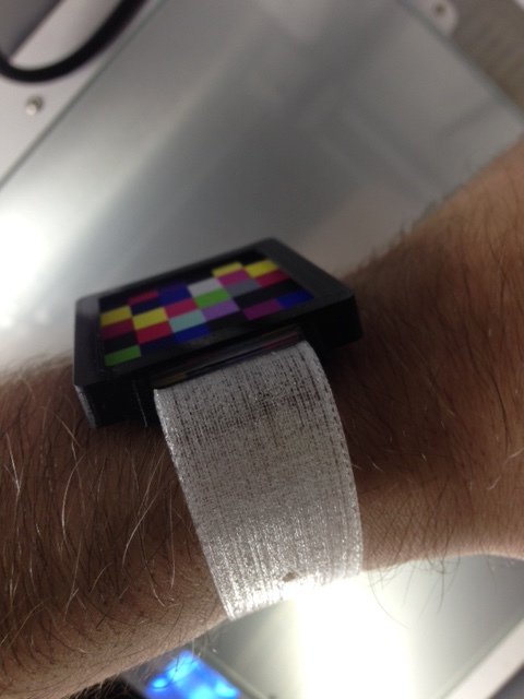

Enjoyed the FlexSolid workshop at Fablab London last night - thanks to the organisers. I tried out the 2.85mm filament with my Ultimaker with default PLA settings - printed out a (very basic) watch strap which turned out pretty well. I like the texture and semi transparency.
@tmlowe this is fantastic, I kind of want one :P. Did you make any adjustments to the guide tube?
@cinter thanks, I can send you one if you want! I didn’t make any adjustments to the guide tube and it worked fine. The strap is a very simple flat shape though - I’m not sure how it will deal with more complex shapes.
So cool!
Sam, this is so cool and yes, I want one too! :slight_smile: Would you be willing to start a new thread about this print, so it doesn’t get lost in this one? And please share the source of the design file too. It’s already day 6, how is the strap holding up?
Impressive documentation! I’d love to see some of the results, I’m sure they’re as impressive :wink:
Thanks all! The printed strap is very basic and the fastening isn’t very secure at the moment but I’m planning to make a better one soon - when I do I’ll post details on a new thread. The ‘watch’ part is my previous project - it’s kind of a card holder in the shape of a smart watch. I’ve put it on Etsy with a fabric strap: This item is unavailable - Etsy . I’ll add the 3d printed strap if I can get it working well.
