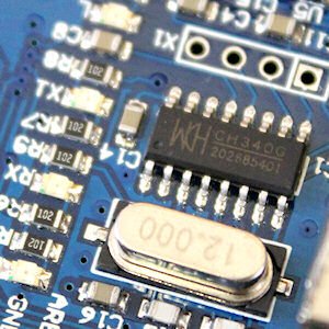

Which driver you need depends on what serial-to-USB-chip is on the board. Most cheap Chinese Arduino-boards nowadays uses the CH340-chip instead of the official Arduino-chip so that’s probably what you should be looking for.
Here is one link I found which has the CH340-driver for Windows 8 available for downloading and some instructions on how to install them. From my own experience you usually also need to reboot your computer after the drivers have been installed for them to work properly.

It could still be a driver issue. Have you installed the correct drivers? There are many different chips used on Arduino boards including CH340, FT232RL and Atmega16U2, but there may be others as well. To make sure you get the right drivers you should read the model number on the chip closest to the USB-port and get the appropriate driver. The FT232RL should be supported out-of-the-box in most OS:s, the ATMega16U2 requires Arduino’s driver and the CH340 requires it’s own driver as mentioned.
