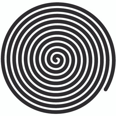

I imported it into tinkercad and it looks really good. And I realized, even though everyone seems to recommend Tinkercad, I cannot manipulate the shape you have kindly given to me. What I wanted to do was to “tighten” the spiral and add more rotations. I tried to kinda overlay it with a bigger version of itself but did not really manage to do that.
I’d like to have a spirale that kinda looks like this one:
and fits into a petri dish (so the area of a circle with a 90mm diameter, so about 3,5inch if you’re american).
The distance between the archs should be around 1,5 mm.
I feel really bad for just telling some stranger what I want, maybe if you can point me to an online CAD where I can do that?
I’m trying tinkercad atm, meaning right now I’m teaching myself to draw boxes and stuff in javascript so I can advance to a spirale.
Thank you so much for your answer!
I want the spirale to fill the area of a circle with 90mm diameter, the single lines should have a distance of about 1.5 mm. My goal is to reach a line thickness of about 0.3mm, but it is ultimately decided by the kind of nozzle, the pressure and temperature I’m using. So if it has the input of 0.3mm I can try and tweak my parameters to actually reach it. Tall, I don’t know, for the stl file I guess 1mm is fine? I want the printer to just print a single line, or better said, layer.
So I guess this makes maybe 17 full rotations?
