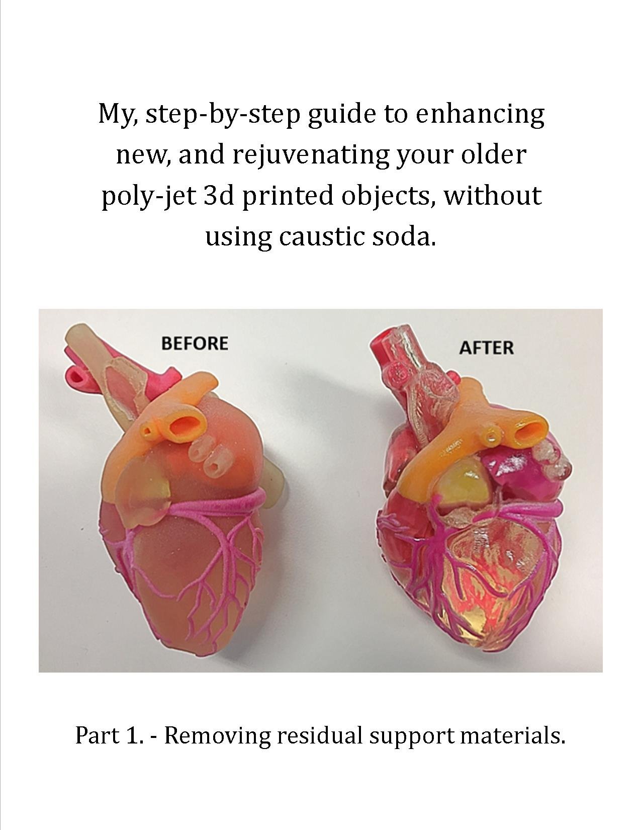

My, step-by-step guide to enhancing new, and rejuvenating your older poly-jet 3d printed objects, without using caustic soda.
