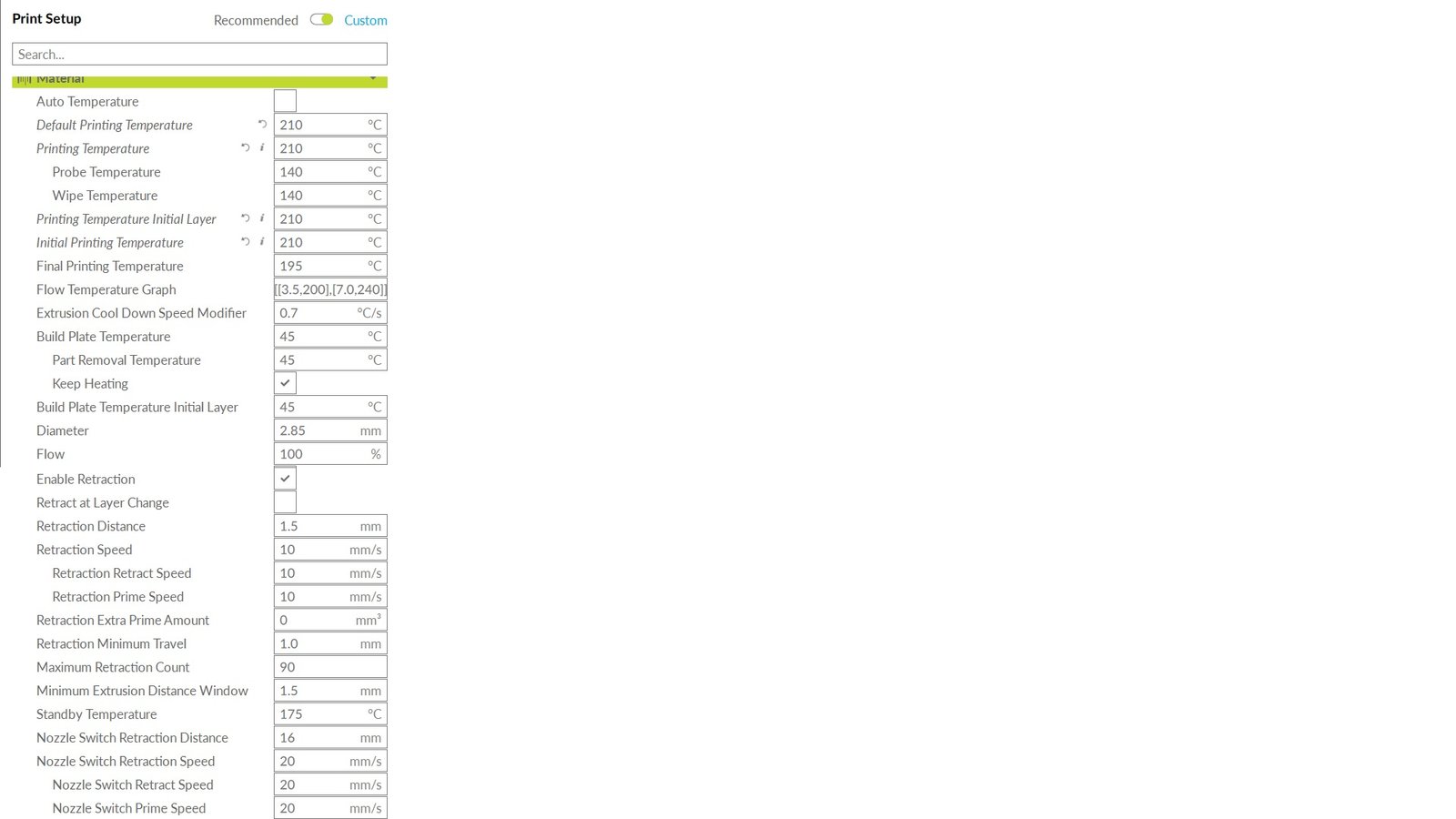

kindly check my settings, maybe there is something wrong with my settings and I did not notice. I attached the picture :slight_smile:

when it autolevels do any of the corners deflect down? Maybe the nozzle is dirty and autolevel not working correctly so first few layers too close causing filament to grind.

Why didn’t you say that to begin with? A 0.25 nozzle is going to require a lot more pressure to push filament through the nozzle. You need to slow down your print speeds a lot.
Put back a 0.5nozzle and see if that solves it.

Dina,
yes, it’s the nozzle size. The smaller hole makes it hard for the filament to push through. The only solution is to increase the temp and slow the print movement down.
