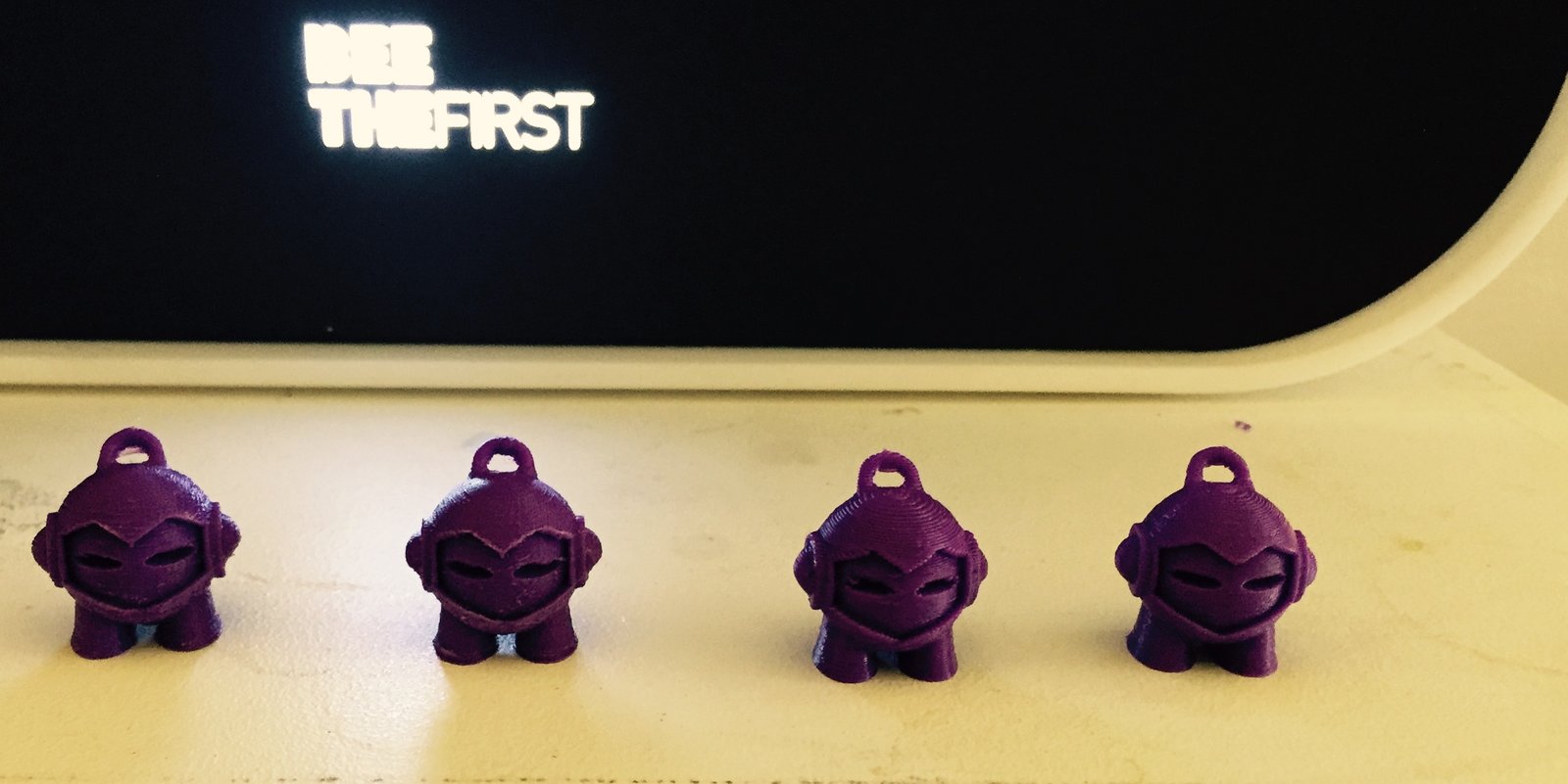

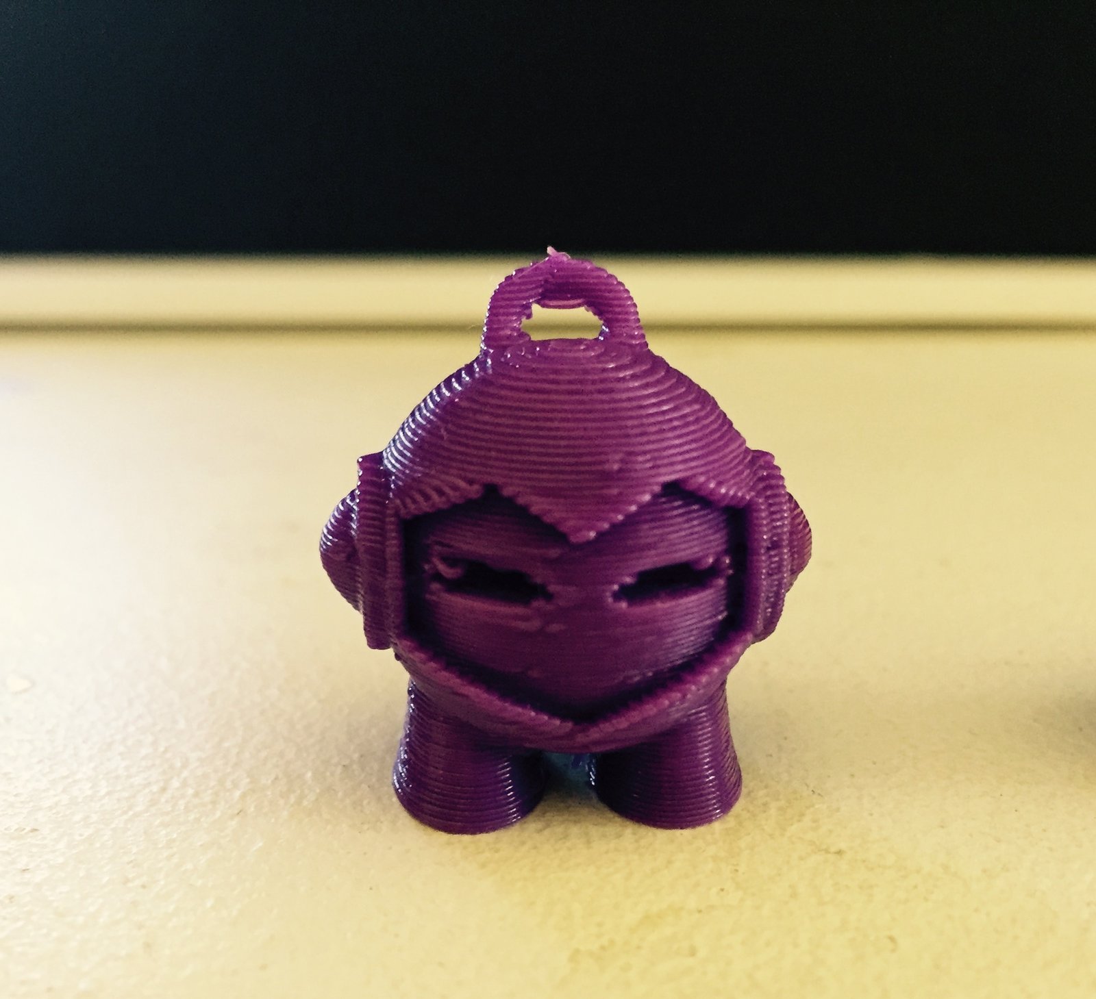

Naturally, I started with MAX on everything. So “high +” resolution and 42 on density. I must admit, I have failed to understand that density will not change the appearance of the Marvin so I tried one with low density as well. Here’s how they look:
So these were my first Marvins! I was pretty happy. They are obviously looking the same even though of a different density.The edges seemed alright, but from their faces they seemed to have had a pretty rough night. So I did not stop. I have tried the other extreme.

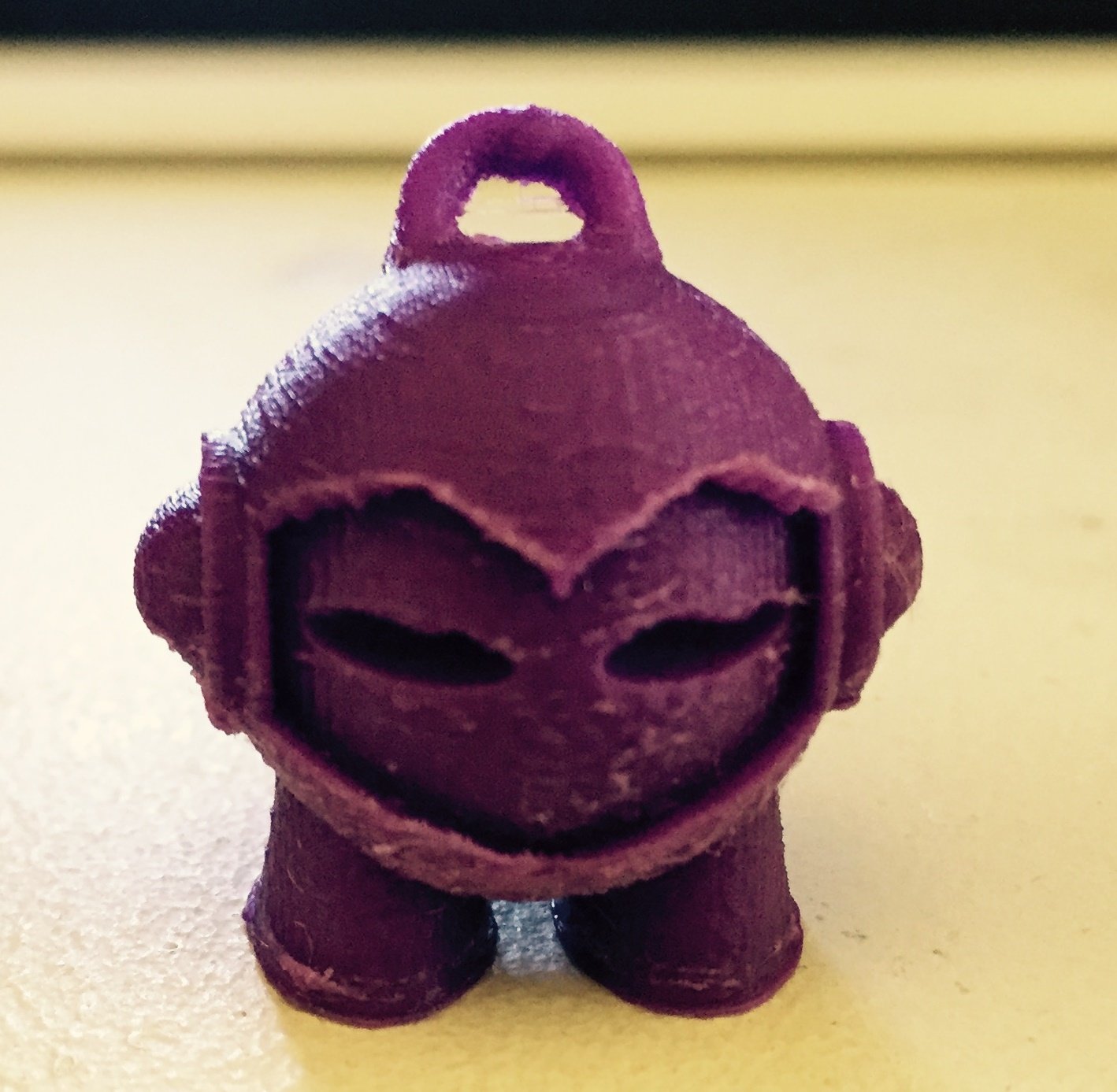

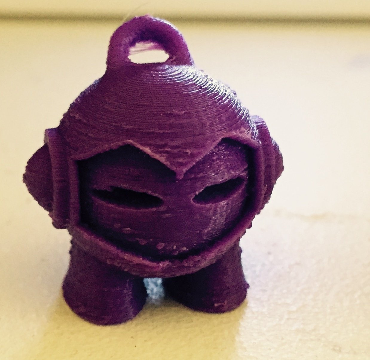

Everything on low:
So now instead of a sleepy Marvin, I have created a mummy Marvin. Mummies don’t fit in my family, it’s just the way it is.

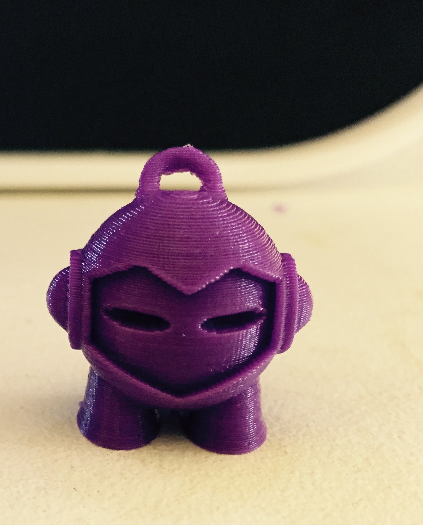

The Perfect Marvin
This is it! This was the best one of them for sure. You know how close-up pictures makes you insecure about those little details in yourself. This Marvin is also a little shy about his “Lines” , but in real life he’s a pretty handsome fella. Also, in this resolution there seems to be something hanging between his legs, which can be considered both a flaw or an increased chance of reproducing.
Summary
  • Printer: BeeTheFirst
  • Filament: PLA true purple
  • Resoliution: Medium
  • Density value: 15%
  • Print time: around 1 hour

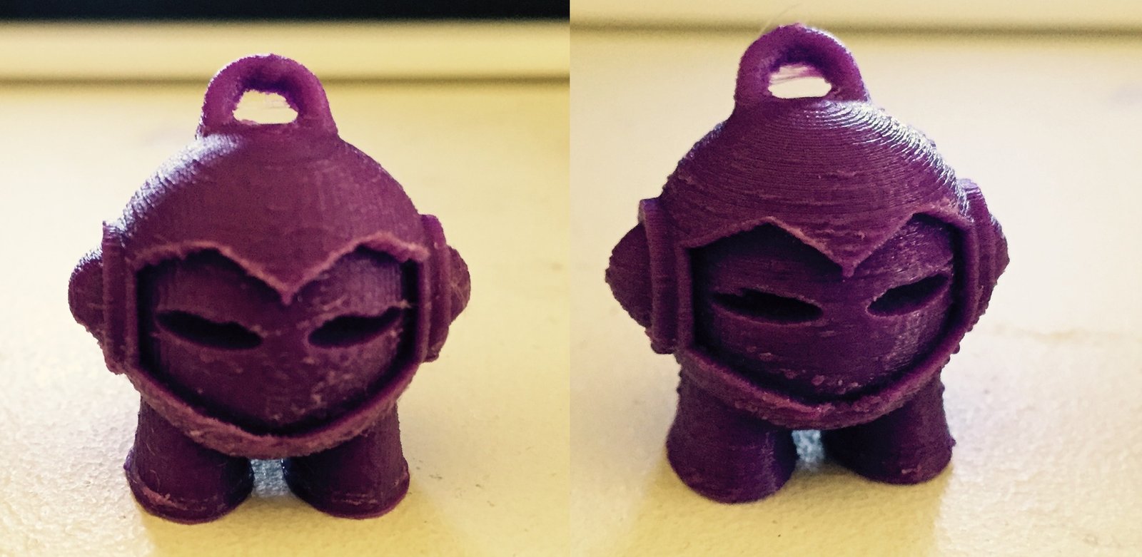

What resolution were these printed at? They look nice :slight_smile:
I’ve been playing around with the 3 out of 4 possible resolutions with this printer. First picture was on “high” the second Marvin was printed on “Low” resolution and the last (and the best) was in “medium”.
Seems those are 50,100,200,300 micron choices on that printer. Nice output :slight_smile:
