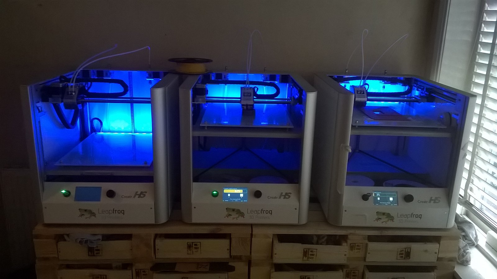

My experiences with the Leapfrog Creatr HS
In this post I want to describe my experiences with the Leapfrog Creatr HS and Leapfrog in general. Especially the negative ones.
Initially, I got the Creatr Dual Extruder from Leapfrog. The main problem with this printer was that the shaft of the motor for the movement in the y-direction kept breaking. To solve this problem, I got several new motors and also new printers, but the problem kept persisting. When they wanted to send me another new printer, I think the third one, the Leapfrog Creatr HS had already come out (at least on their website). It seemed like this was just the Creatr, yet it was improved on several aspects. Therefore, I asked them to swap my Creatr Dual Extruder for the Creatr HS. They agreed to do so if I paid half of the difference in price between the two printers. I was very happy to do so as the Creatr Dual Extruder is really a crap printer in my opinion.

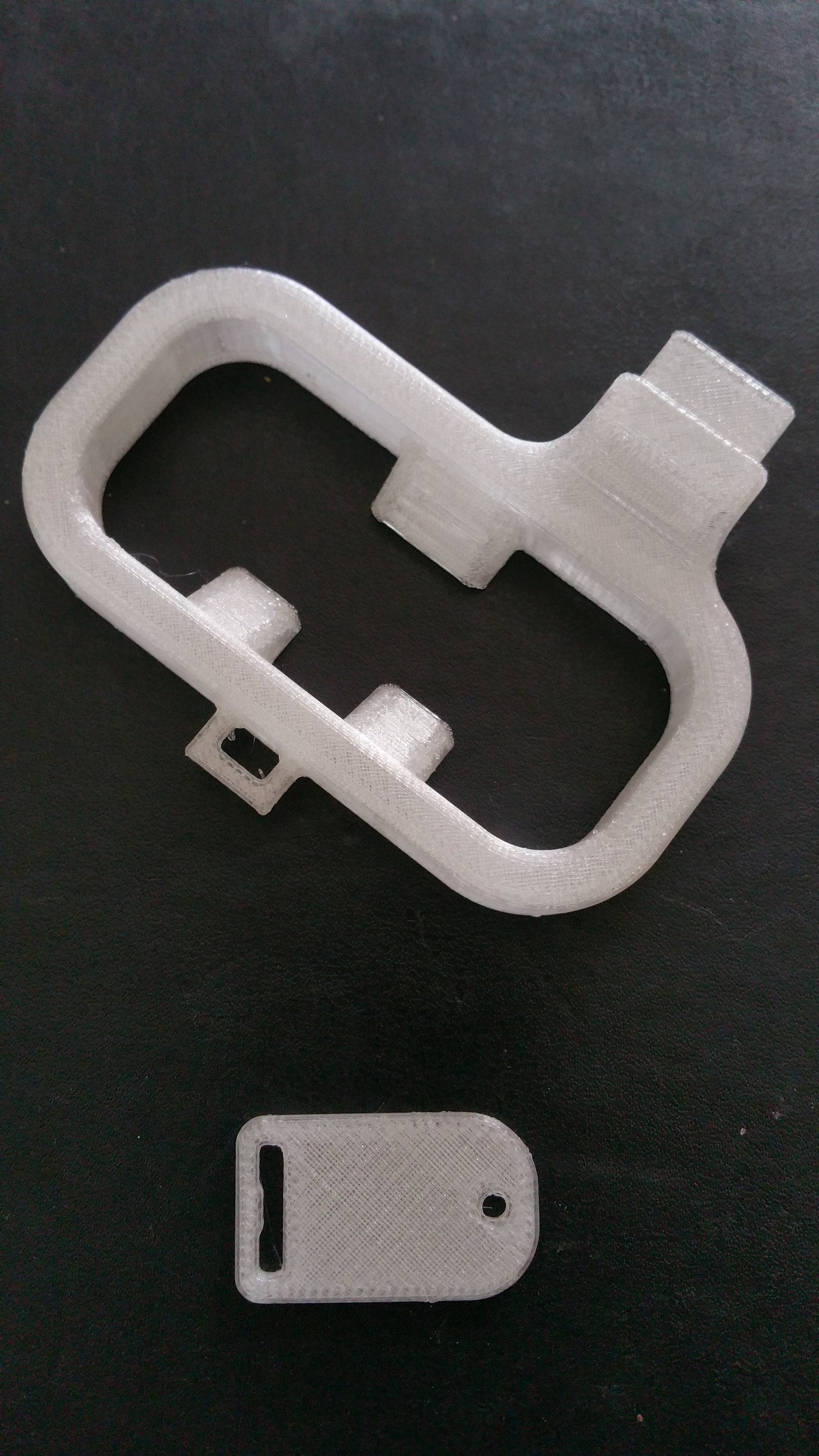

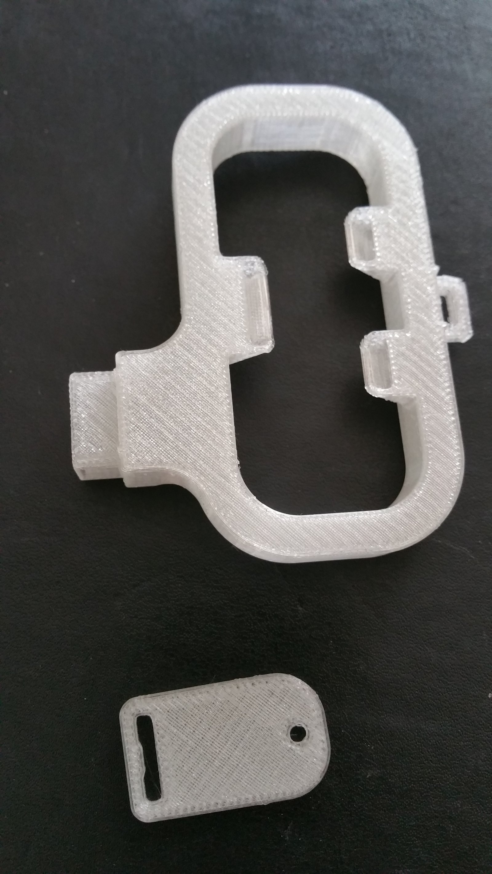

Of course, I thought I could finally start printing, but another weird problem popped up. The prints would jam from time to time and I had no clue why this could happen. I started monitoring the temperature and it turned out that the temperature was highly unstable, sometimes dropping under the melting temperature of PLA. I went to the website of Leapfrog to see how this problem could be solved. I followed the PID autotune manuals but this didn’t work. Finally, I got the temperature stable by manually inserting PID values after studying the theory of PID controllers and checking what values other types of printers were using.
Now I got the printer kind of working and started to print the parts I originally bought this printer for. The printer has a large printing bed, which is one of the main reasons I bought this printer. But now it turned out that even with a thicker first layer, I was hardly able to use the entire surface. The nozzle would almost hit the substrate in the middle while the plastic was not even touching the bed on the sides: The printing bed was super curved. I contacted the Leapfrog Customer service and they sent me a new bed. I installed the new bed but this one was curved as well. I spent hours on getting the closest to perfect configuration with a combination of bed leveling and plastic extrusion and then decided that apparently it was not getting better than this.
I started printing my parts and this was going really well. I instructed my whole family on how to use the printer, how much plastic each part would cost, which parts I needed and how many of them. I wouldn’t call it a mass production machine but we were getting pretty close with it. But then it became summer and parts started to fail randomly. I noticed that the temperature in the room was slightly raised because of the good weather and it seemed like the plastic was melted at the extruder drivers. I started monitoring this temperature and came to the conclusion that the drivers were getting very hot. So hot, the PLA started to reach its glass/melt temperature. I solved this problem by placing a fan on top of the printer.
Then, an update of the firmware came out. I installed this, and suddenly all my parts were larger. Turned out that the old firmware had a wrong amount of steps per cm. I had to resize every object I designed because otherwise it wouldn’t fit as a replacement part in my products.
