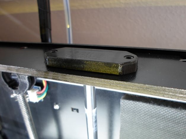

- Top corners: Covers for the CTC Dual top corner holes by DocVader - Thingiverse

\* Top outer corner covers
\* Inner Corner Covers
