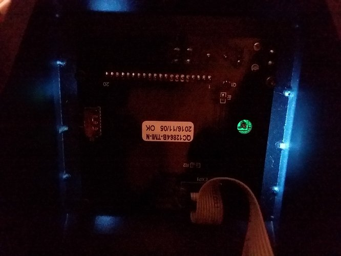

I just finished installing the mosfet for the heating bed and now I cant get the screen to show any characters. It turns on, but its just the blue background. The controls are still working but i’m flying blind in terms of trying to do anything with it. I did get it to home out the print head but that was it.
It did work fine before the install, and I did remove the ribbon cable but it all seems like its intact still…

I think there might be a potentiometer on the back of the LCD that adjusts contrast, have you tried tuning that?

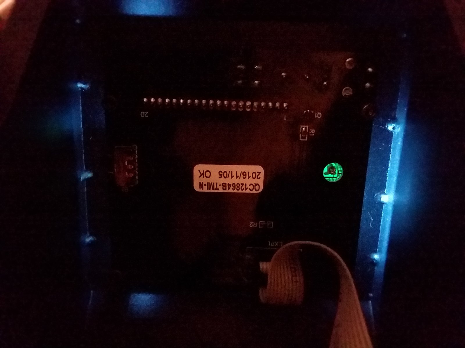

Would that be the tiny screw in the green lit up circle? If so no I haven’t touched it but would be willing to try.
It looks like that would be it - make sure whatever instrument you use doesn’t slip and tough the board, or alternatively have the machine turned off before adjusting, then turn it back on to test, etc.
Well, I tried adjusting it to no effect. Same problem.
