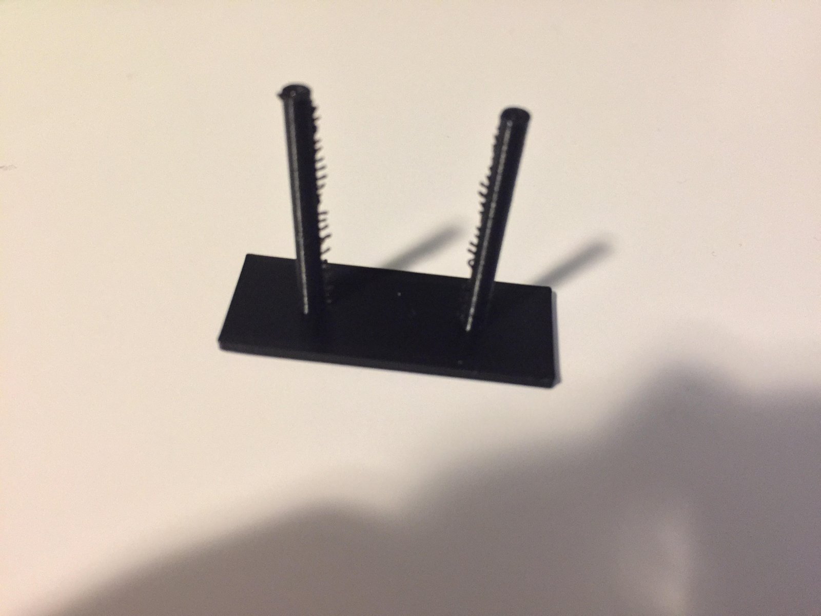

Hello, I have a Monoprice Select Mini V2 and I’ve recently been having issues with little strings that are thick and sturdy sticking off of models:
I used Cura v3.4.1 to slice this model: https://www.thingiverse.com/thing:2563909 using Hatchbox Black PLA filament
And the following settings:
Layer Height: 0.1313 mm
Wall Thickness 1.05 mm
Infill: 22%
Extruder Temp: 200 C
Bed Temp: 55 C
Retraction Distance: 4 mm
Retraction Speed: 40 mm/s
Speed: 50 mm/s
Z-Hop When Retracted: Off
Supports: Off
Adhesion: Brim
I’d appreciate any advice on how to fix this problem, thank you.
This looks like the head is moving away from the print while hot material is still oozing out. Depending on the software you can enable coast to end, and do not leave print perimeter. The issue with the later is that this looks like it happens every time the head moves to the other shaft. Coast to end will let you set a distance from the end of each line that the extruder will stop pushing in order to drop off pressure from expanding hot plastic. This should help a little.

Your 3D printer is showing a stringy appearance due to over-extrusion and this occurs due to multiplier or flow setting in your slicing software.
To resolve this, open the slicer software and check the extrusion multiplier selection. Besides, you can also decrease the flow settings in the 3D printer software to get assistance.
