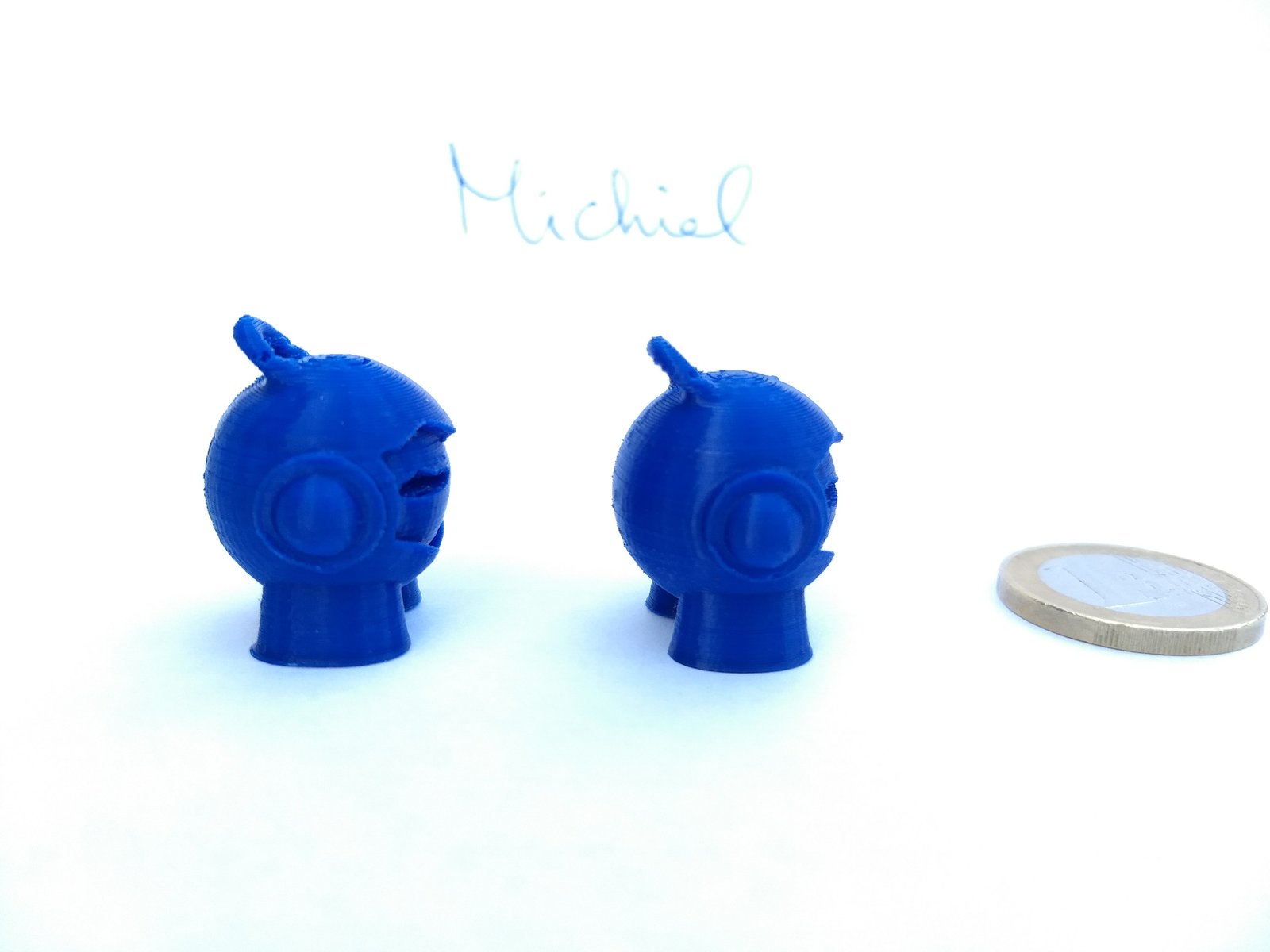

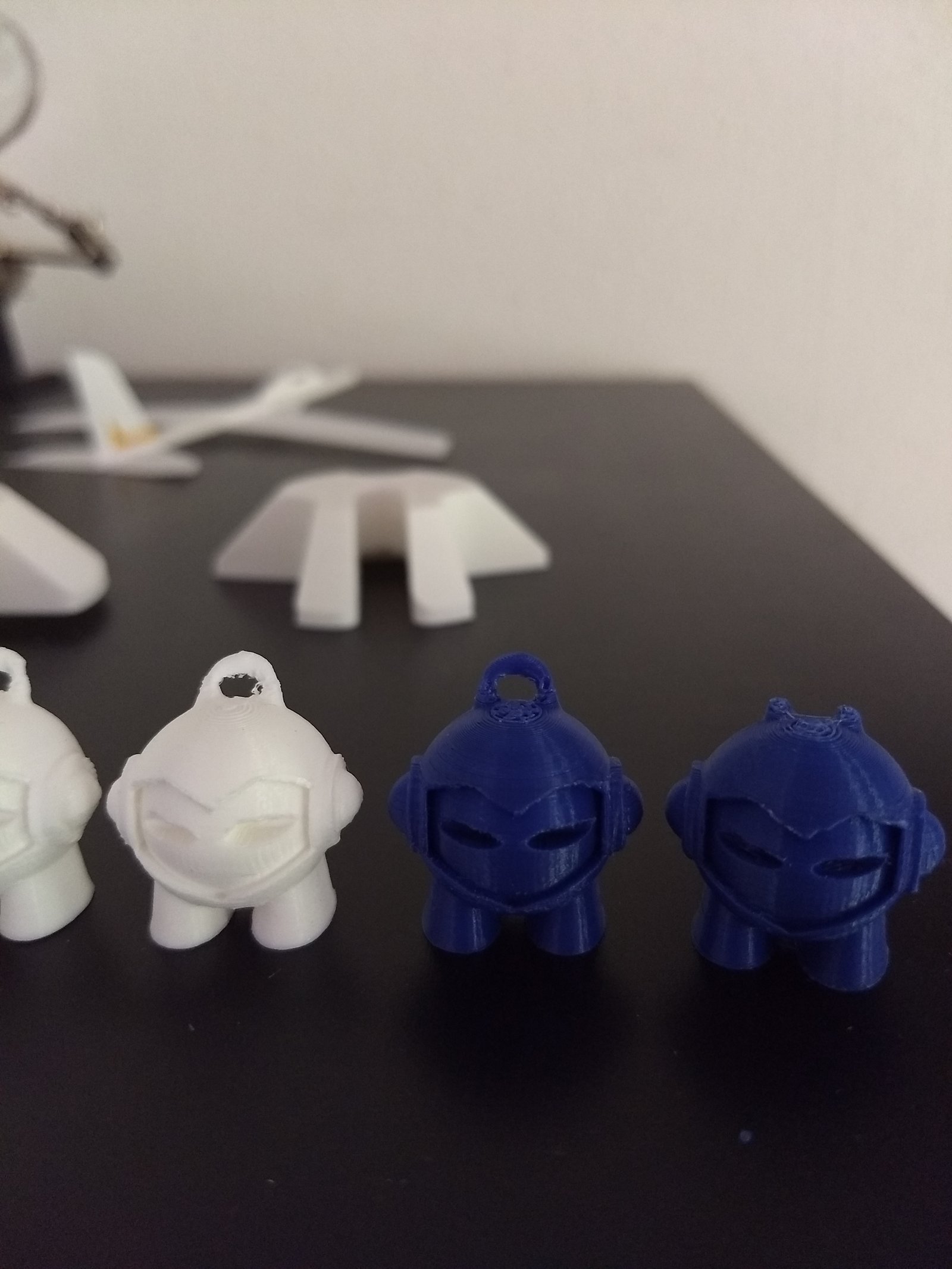

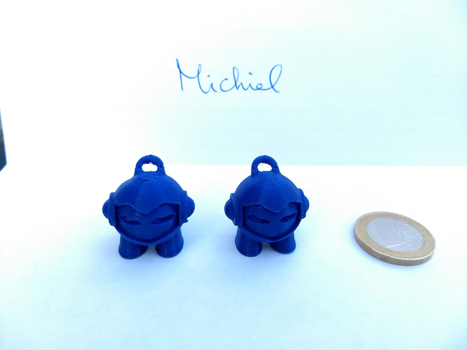

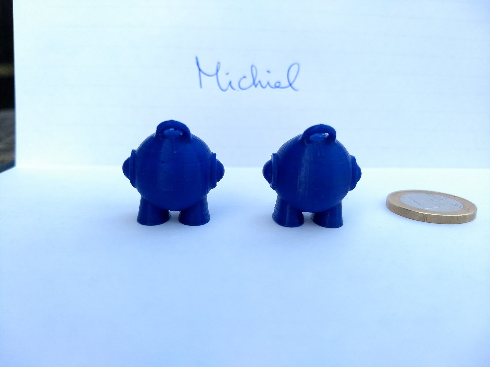

Hi everyone! Im having problems with having my printer verified due to the ring on top of the marvin not printing good enough. Atm, Im printing PLA at 100um, 190C, 30mm/s, but it still looks like a weird mess. The order in which I printed the marvins in the picture is left to right, with the last marvin not printing a ring at all… Might my rectraction of 4,4mm and coasting of 1,5mm be the problem? I didnt have time printing a marvin with these features disabled, but Im afraid I will spend another hour printing another (count is at 7 or something) failed marvin, so wanted your opinions :confused: Thanks in advance!
The layers of the ring are very small so they print very fast but each layer needs to cool before printing the next. You need to slow down (some slicers have an option to slow down for small layers), increase/upgrade cooling fan, and/or print more than one Marvin at a time so there is more time between layers.

First thing is to print at .2 until you get a good one then you can start reducing the layer height. A thin layer like that brings its own challenges and when you throw Marvin in on top of it you are going to struggle.
Heat is the biggest problem. The simplest thing is to print three or four at a time.
You don’t say what printer or slicer but your retraction seems extreme.

Use .200 layers and 15mm / second and it should work.
