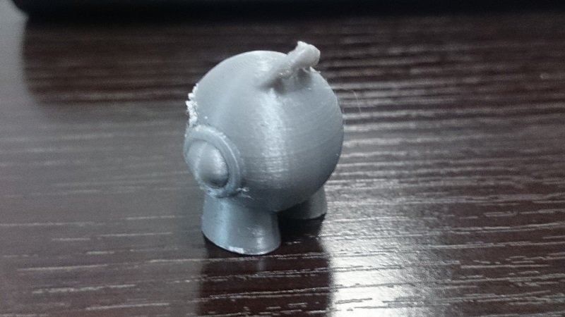

I’m a newbie here in the HUBS, and I’m printing the famous marvin keychain, I have tried many times, but never with successful results…Here are my photos

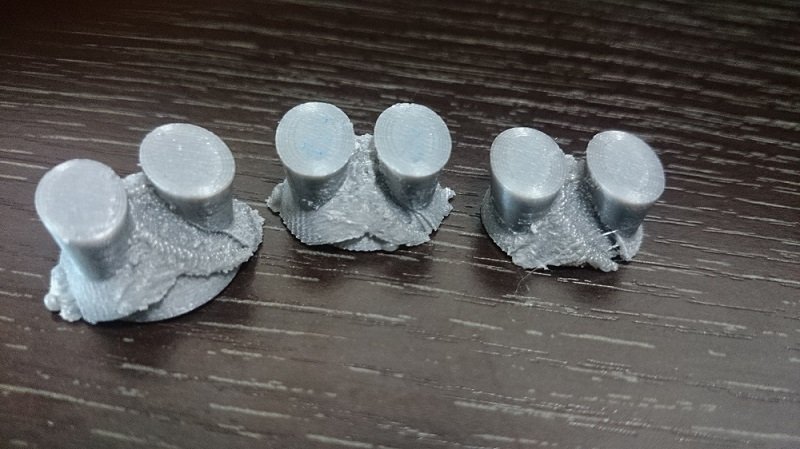

At the very beigining, I tried with no support, but it never happened to me, all failed
My printer is a Deltabot Dforce, with extruder of 0.3mm, slice software is CURA
PLA: 0.05mm, temp. 200C, walls 0.9~1.5mm, print speed 20~45mm/s, travel speed 180~210 mm/s, fill 15~20%, fan ON, no support, etc…
The results were too bad…

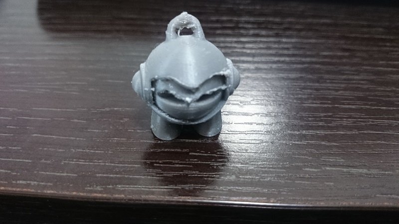

Then I thought without the support I could never finish it, so I added the support and changed the layer to 0.1mm, print speed 25mm/s
This is what I got at the end, I’m still not satisfied with the detail, but I think layer 0.1mm seems OK, and I wonder how you guys finish this test printing? For me it is really strange, I have spent two much time to print such a tiny thing!
Do you think this will pass the test??
Thanks for a feedback

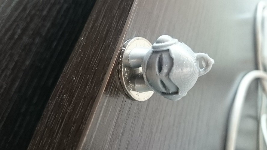

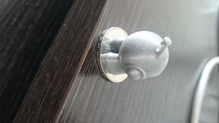

Hi Arnoldas,
Yes, you are right, this morning I found out that 0.2mm is really better. I printed a single one using a speed of 20mm/s and the results are much better, you can check it in the photos below.
Thanks for your support :wink:
Cui
