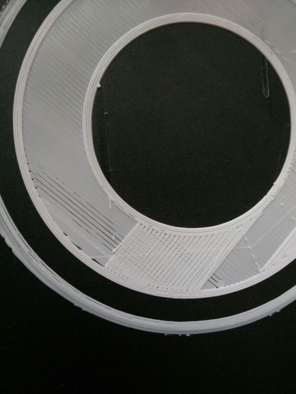

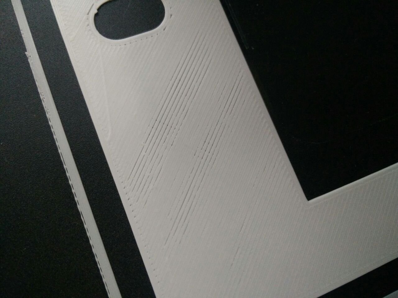

I have an E3D v6 1.75mm bowden.
When I print, there is a gap between infill lines, and also when printing rectilinear/hexagonal infill lines seem to be pretty slim.

Here you can find some pictures that show what I’m trying to describe:
I built this printer taking parts from my old i3 printer, which worked perfectly with the exact same filament. The difference is that it had direct-drive extruder while this one has a bowden extruder, and also the i3 had Repetier while the new printer has Marlin.
While printing I tried to release the extruder motor clamp and push the filament by hand: it extruded 1mm thick lines, so the extruder is not clogged and is perfectly capable of extruding the required amount of PLA.
Is it possible that the VMax E parameter is preventing the extruder motor to extrude properly? I mean, could it be that it’s trying to extrude at a higher speed than the maximum allowed? Seems weird to me, because comments in Marlin’s Configuration.h file say Default Max Feed Rate (mm/s) for that parameter, so if the limit is set to 80mm/s it should extrude just fine. If this is the issue, how should I solve it?
