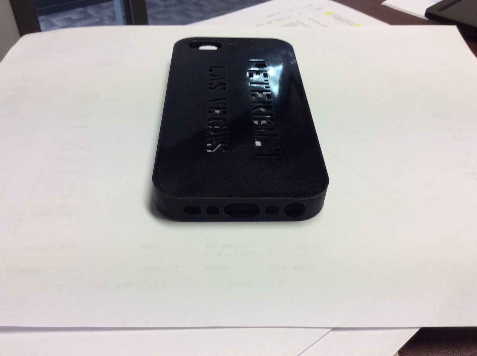

I have not printed with Ninjaflex but I have printed with TPU flexible filament which works very well with the Makergear M2. I have printed iPhone case which turned out great. I believe Ninjaflex is a little more softer than TPU. Hope this helps .

Do you have a photo of the phone case?

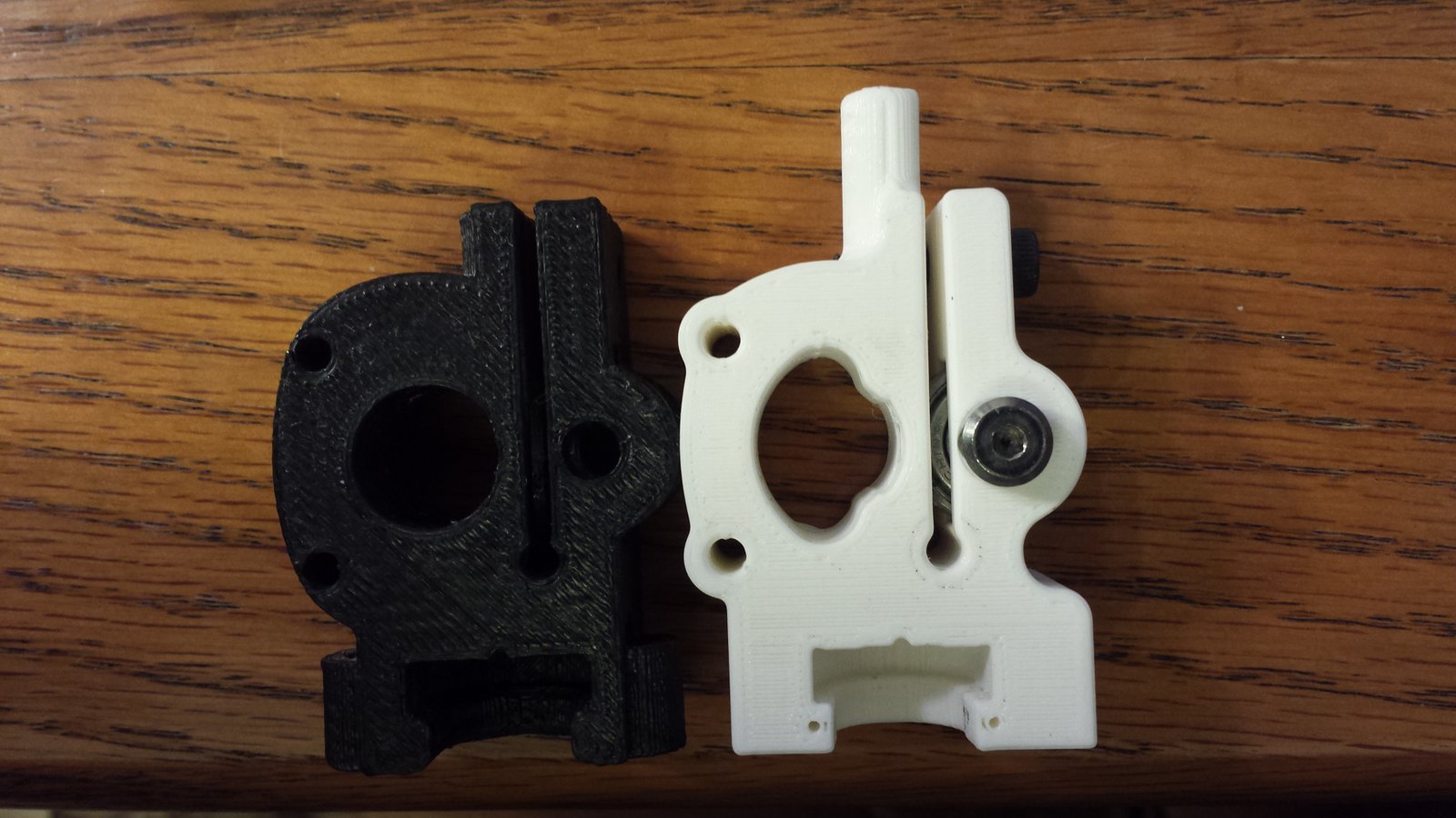

It prints… but its a ton of trial and error… 220 to 255 degrees is the range depending on your situation, thus you probably should get the v4 extruder on it. The v4 bunches up less but if you just get a v3b I had to redesign the extruder to get it to work. Ninja flex is a novelty filament in my opinion… ton of effort to get ok looking parts at a slower then tar pace. Thin walls DONT support themselves.
I use Sainsmarts flexable TPU. I wanted to test flexible filament but I did not want to spend $50.00 for the Ninjflex.my settings are extruder temp: 225c bed temp: 35c print speed: 1800mm/s reaction speed: 1800mm/s. Attached are some pictures of the iPhone case. Got the stl from thingiverse.com
That case looks great. A little note… the speeds listed are in mm/min, not mm/sec. Converted they are 30 mm/sec
Oops, I checked my slicer program and it is mm/min. That’s what it get for relying on brain matter.

Yes I have done it on the old version v3b hotend and extruder drive. I needed to modify the plastic extruder drive bit to add a Teflon tube so the filament would slide easier. I recently upgraded to a v4 dual hotend and haven’t been able to get it to work yet, not because it won’t but because I haven’t been able to get time to solve the issues.
So in summary yes it will work, but you will need to make some modifications. Hope this helps, I can send you pictures if interested.
It is a great printer btw the only problem I have had was a worn out extruder drive gear after about a year of use.
origional extruder, and the one i modified… there is only about the thickness of a sheet of paper between the gear and the part… its also tapered for better feeding of the filament… it was the only way to get ninja to feed without problem no matter how big the part is. honestly i think it works better then the v4 at feeding but the v4 works most of the time as well
