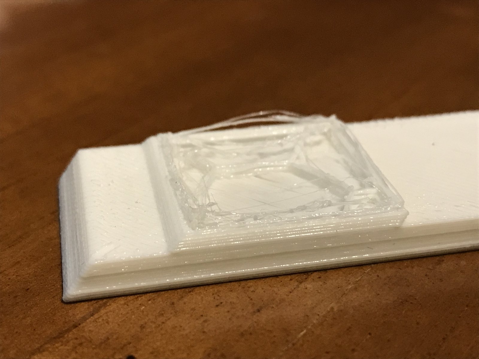

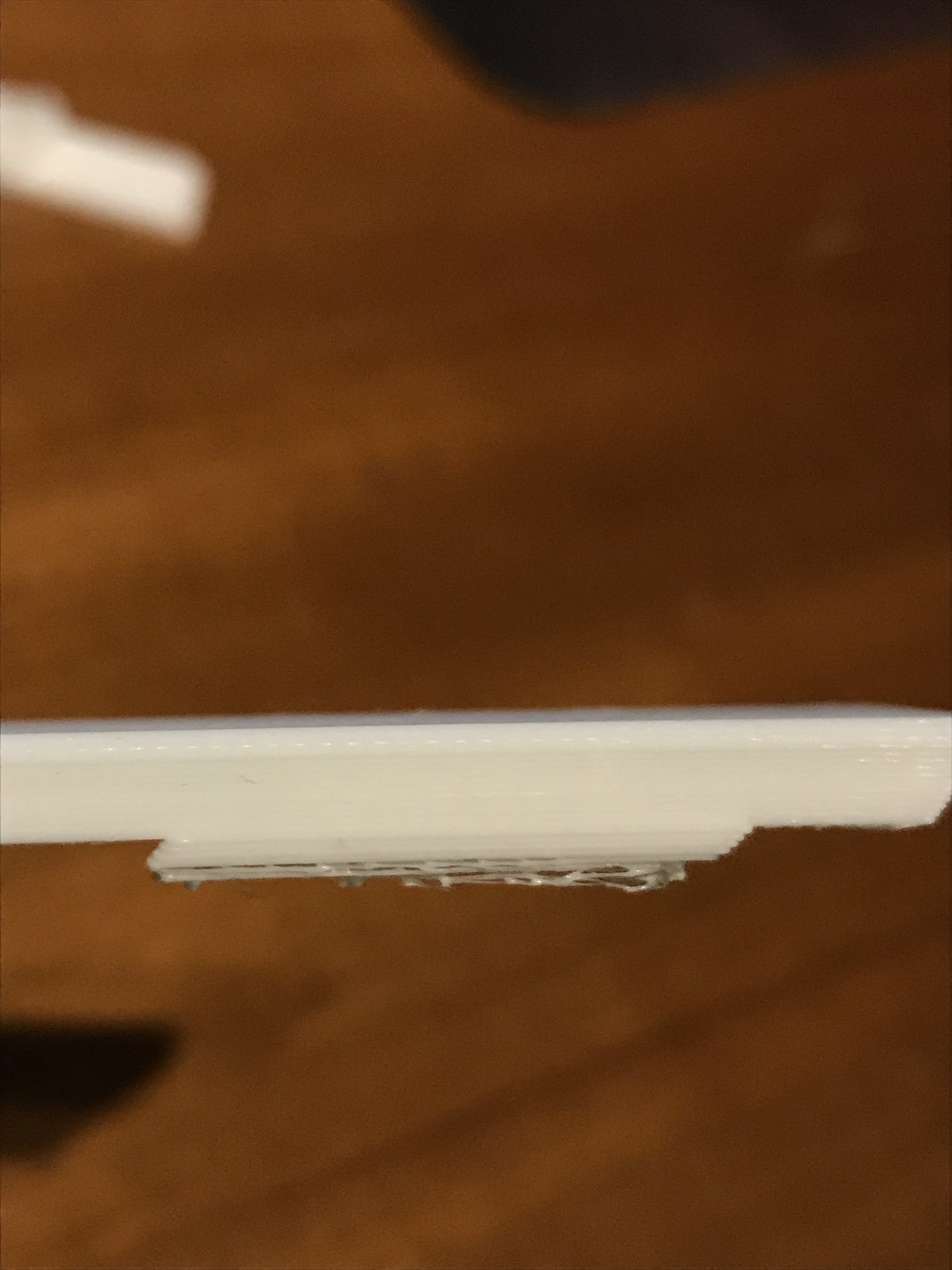

Ok I’m about to give up. It’s been several weeks that I’ve been trying to do a decent print but unfortunately my printer stops extruding the plastic after 15-20 mins of printing. I already replaced the nozzle several times, check the correct installation of the ventilation fan, check different printing settings, leveled the building plate. I think I’ve tried all now. Does anybody have an idea of what could be the problem??
In the pictures you can see how the extruding layers slowly disappear.

Sounds like heat creep- heat moving up the heat break and causing the filament to
expand and clog.
I had the same problem, it was because it is summer and I am in the garage at around 100 degrees F. I fixed it by pointing a floor fan into the printer and the prints finish now.
yeah like @Frantic says.
The thermal break tube did you replace it when you changed the nozzle? some times incorrect installation wear on the PTFE lining or using one that doesn’t have a thermal break in the threads has ptfe tube through the whole throat of the tube, or no ptfe in the tube at all will cause symptoms like you are describing.
I am using this one it has a partial ptfe lining and the thermal break in the threads, it has a tapered inside diameter on the filament inlet side too.
http://amzn.to/2v0Z2sn
Did you try to print a calibration cube? Try a print that you’ve printed successfully and see if it’s still doing the same thing.
Make sure extruder fan is pointing in right direction and you might need to change the cable that connects the extruder to the board.
Mine has started this as well. 3 years old now so I am going to replace the heater extruder block assembly to see if that does it as I have done all the other simple and cheap replacements. So now I am going to try the $300 dollar one and just replace the main block.
Did a replacement on the stepper motor, stepper chip, nozzle, fan, and extruder drive wheel so now time for the big change up.
This usually happens when the nozzle gets hot and somehow dissipates the heat into extrusion mechanism. Make sure feeder teeth doesn’t get hot, otherwise it skips. Turn off the fan and try to print very slowly with lowest temp (like 180C for PLA at 10mm/s), give it a try and see what happens. If it happens after like an hour later then that’s it. You need better isolation.
I tried these and my problem continued. Went back to the old tube instead.
Honestly though I think when winter hits your problem will disappear.
