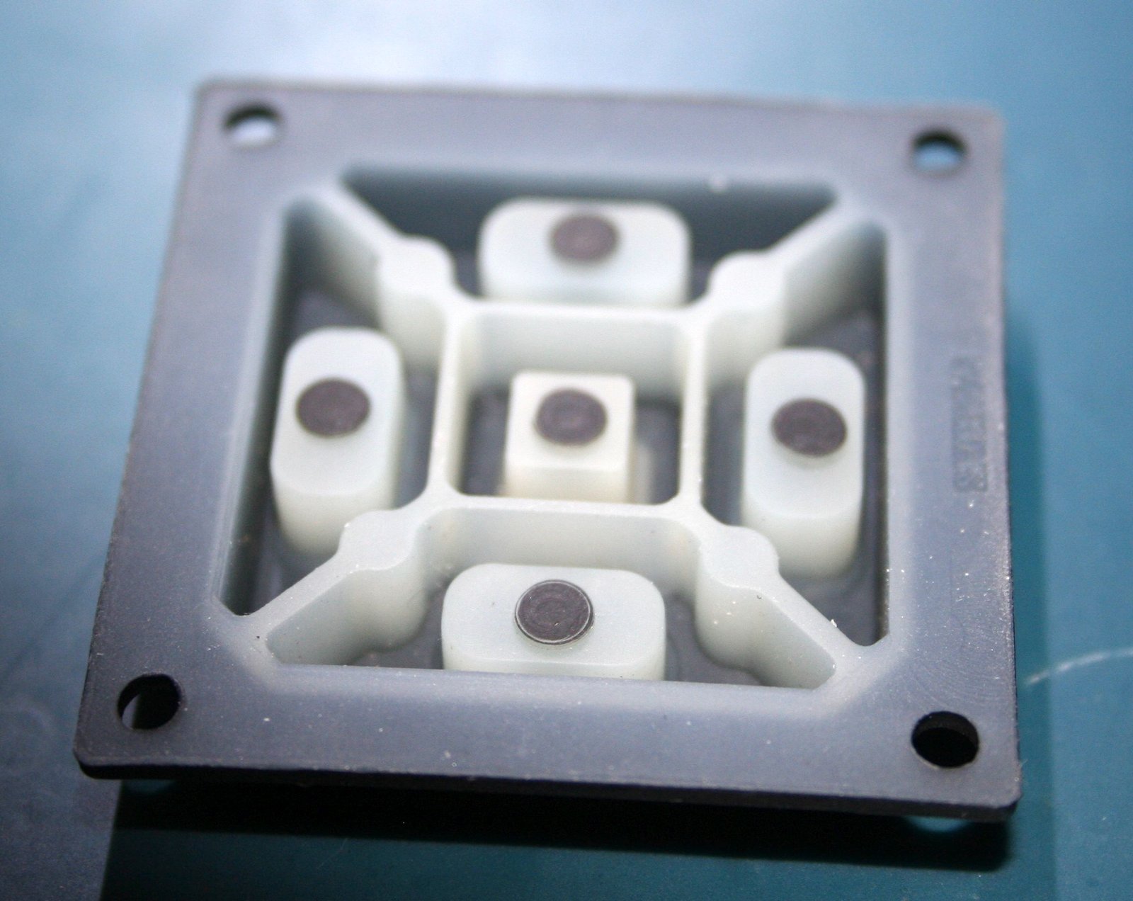

Original Keypad…

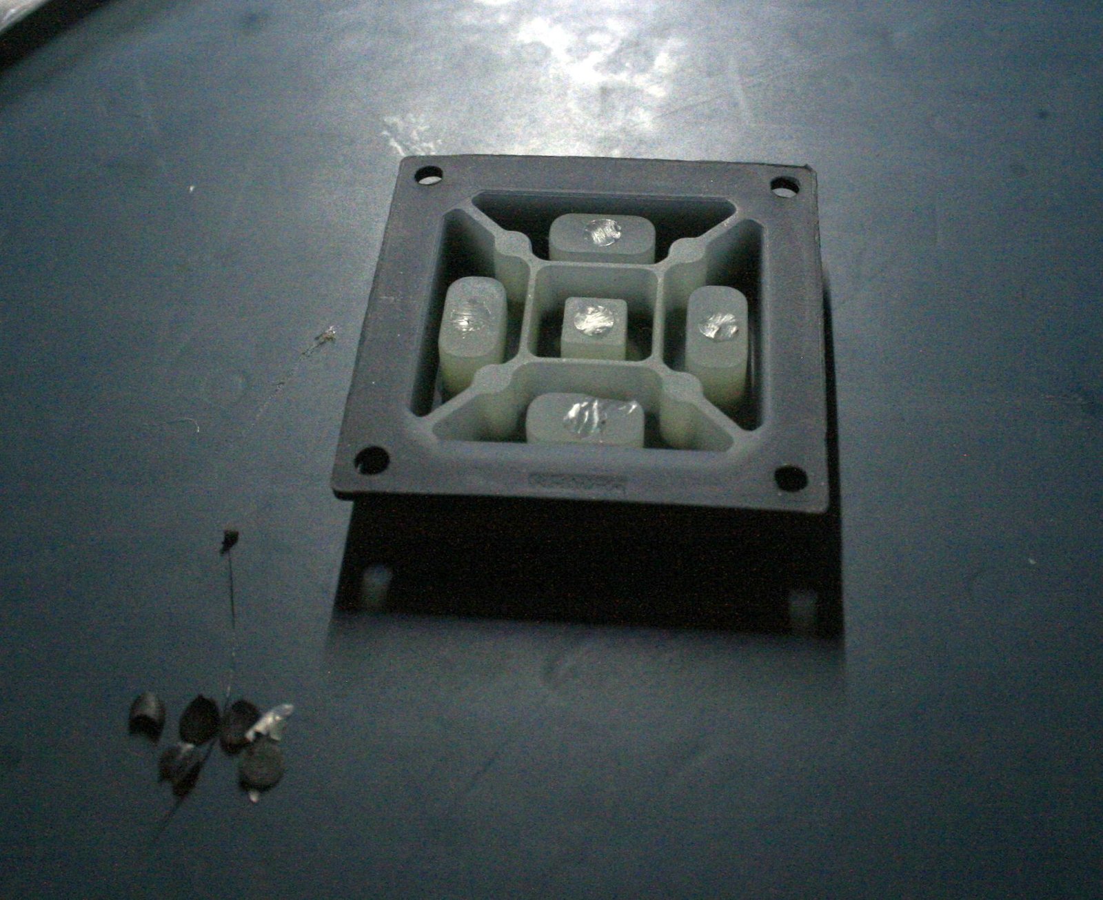

Pads cut off…

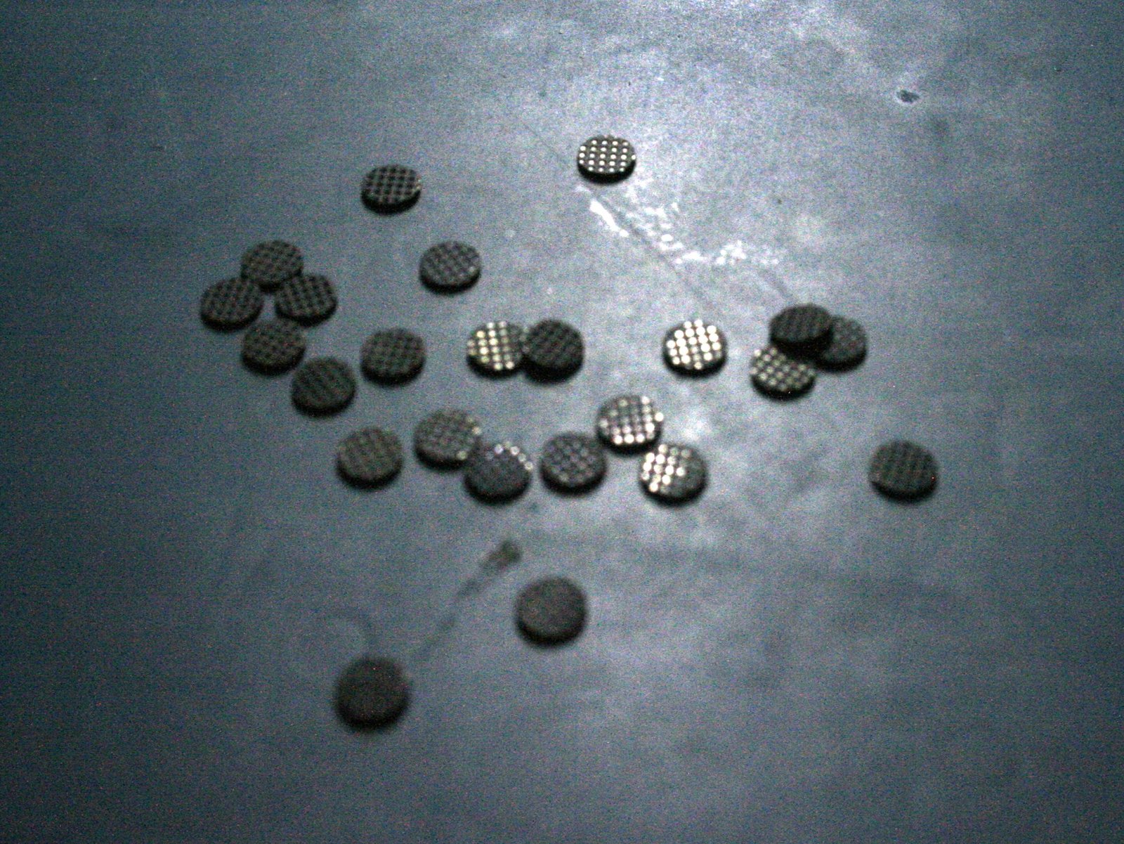

Replacement conductive pads…

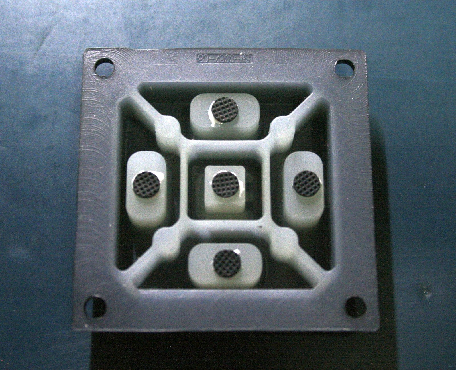

New pads glued on…
Thats all there is to it, let it cure a hour or two, re-assemble the keypad and install it back on the printer, i usually give it overnight to fully cure before really using the keypad but then its back to perfect working order. These replacements last a lot longer then the originals. I have one thats been repaired for two years now and still going strong without issue. I have fixed remote controls like this for even longer.
