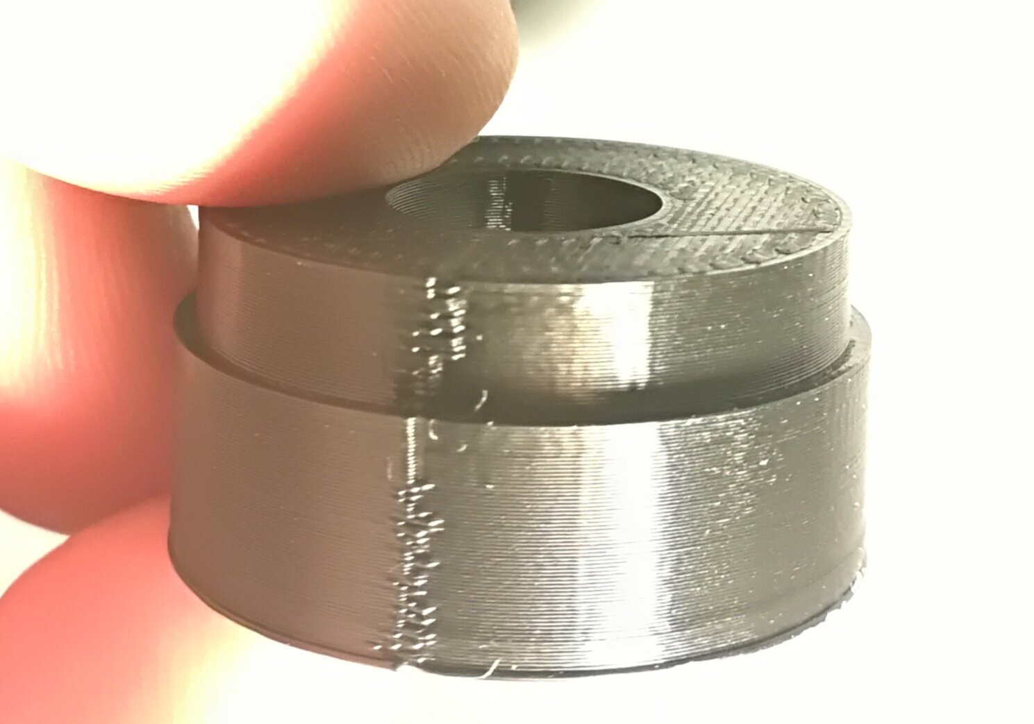

I did some tests and the print quality of the print is actually really good but i still have the Z scar or seam on the outside of my cylinder type object.

2* as mentioned i still have the Z-scar.
i know it’s something that cannot be completely removed bu i think my prints show it too much.
i found this setting in latest cura version TAB> Shell. called:
Z-seam alignment: you can choose, Random > User Specified > Shortest. Standard setting in Cura is Shortest i set it to random?
Z-seam X 140
Z-seam Y 840
Ignore small Z gaps, ive checked the info box next to it but for me it’s not clear what it means, do i need to enable or disable it, it’s enabled in standard cura settings :slight_smile:

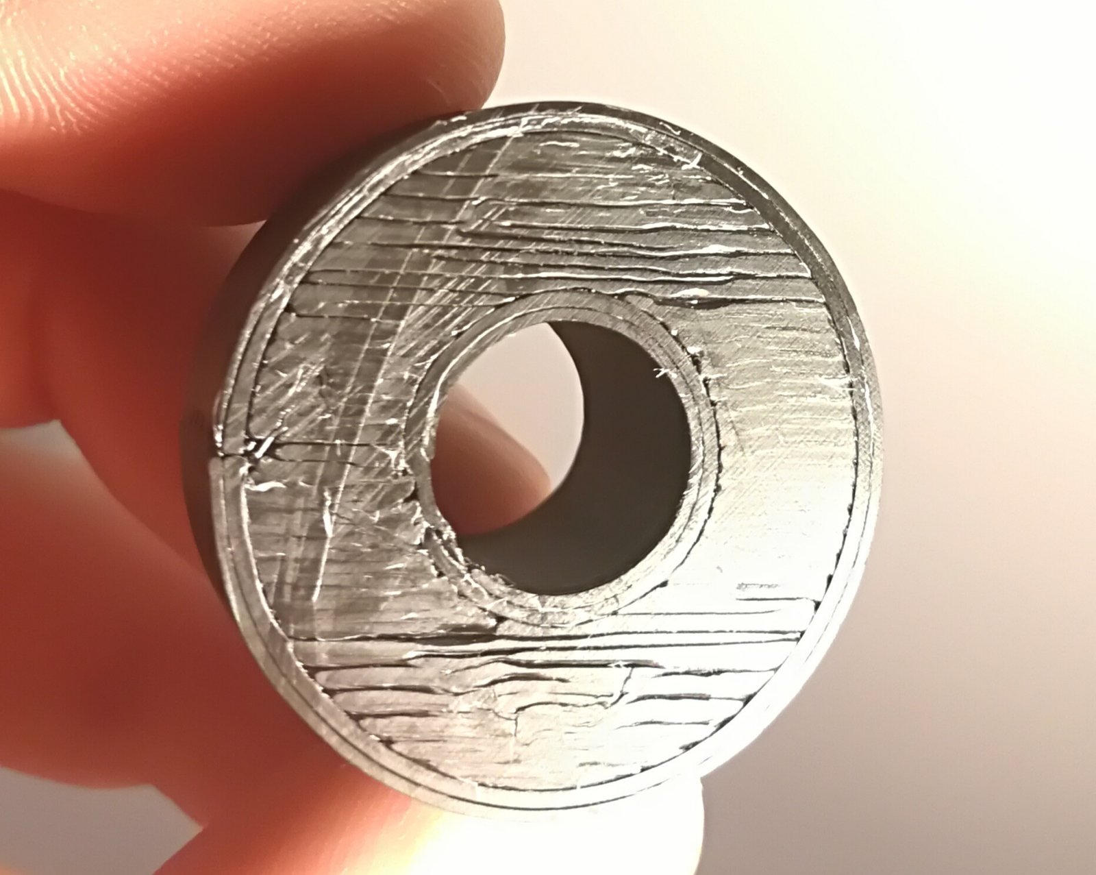

4* look at my picture in the attachment, the bottom of the object i want it to be a bit cleaner but i think i still need to use blue painters tape regardless the PEI sheet of my TAZ 6?
i have also added my .gcode of the printed part in attachments.

Hi
The only time I ever see artifacts that look like loops is
if the model is not solid.
I use an older version of CURA so I can’t comment on your other troubles.
I also use a TAZ6 machine.
