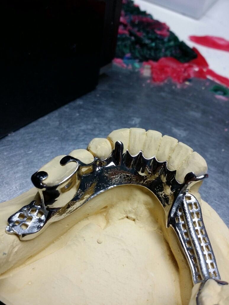

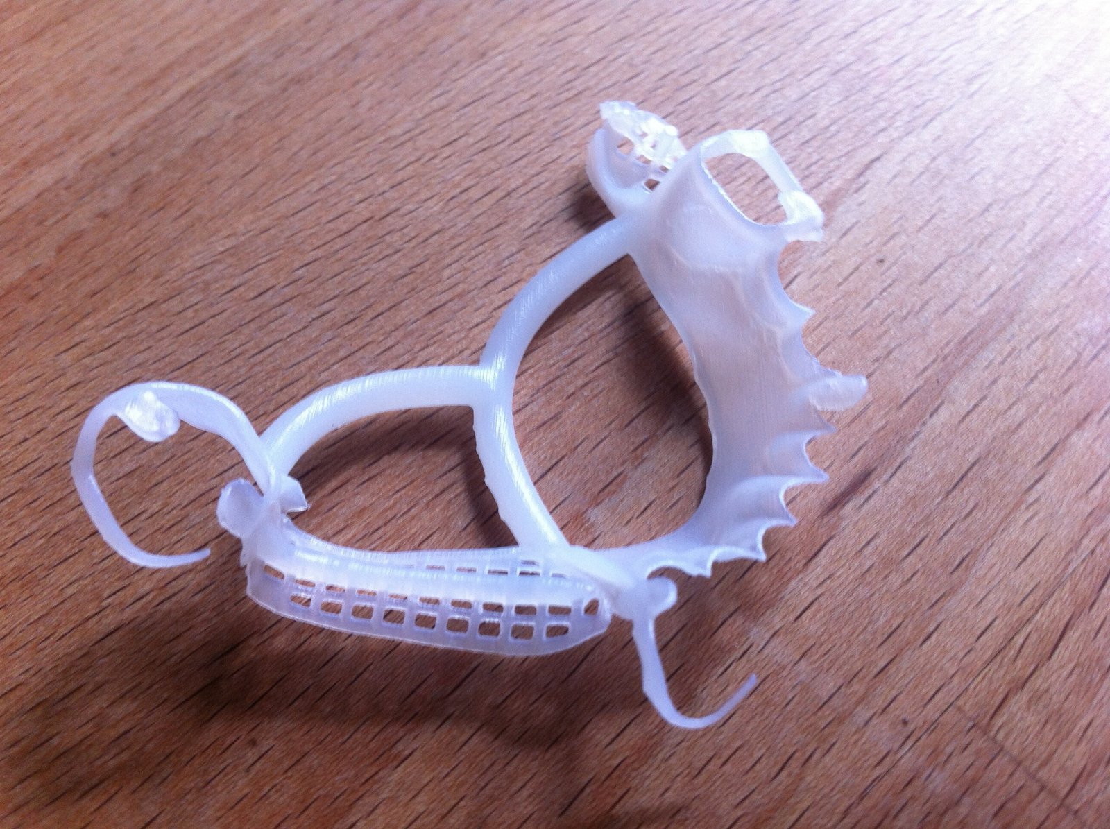

I’ve had great results casting white and also black resin that aren’t supposed to cast well.
But the reason is that I was using a Crome-Cobalt alloy combined with a high temperature oven and high temperature investment usually used for dental plates.
So it really depends on many different aspects.
Ill attach a photo of a dental plate casted with formlabs white resin.

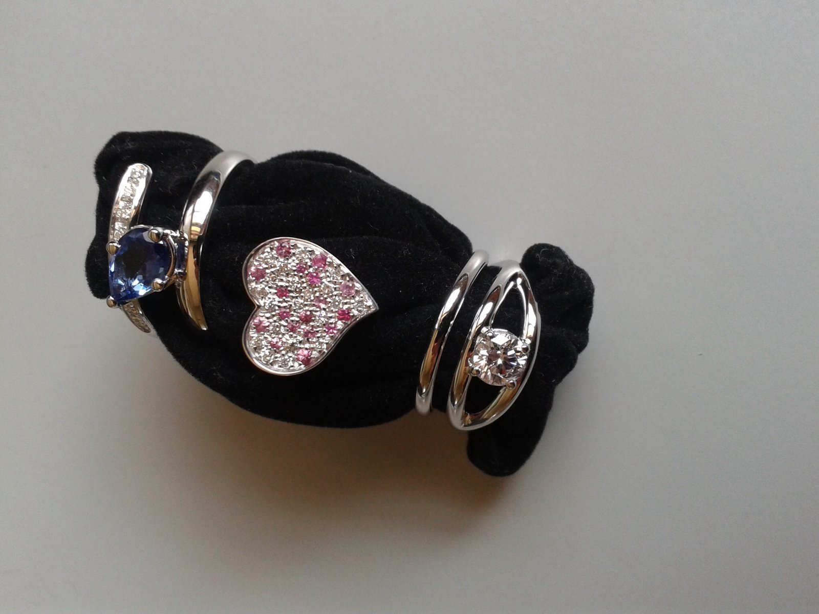

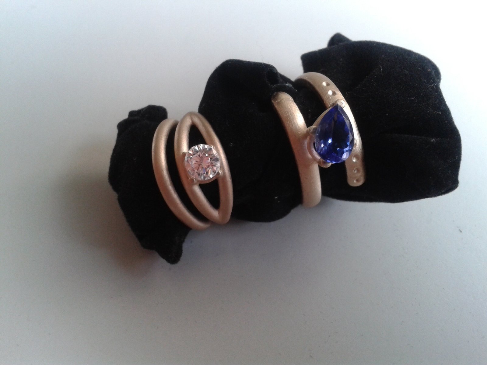

Here are a few photos of two rings and a little heart shaped jewel casted using the formlabs castable resin. The first one in after sandblasting the gold 18kt. The other photo after a good polish and rhodium plating.
Best
luke
