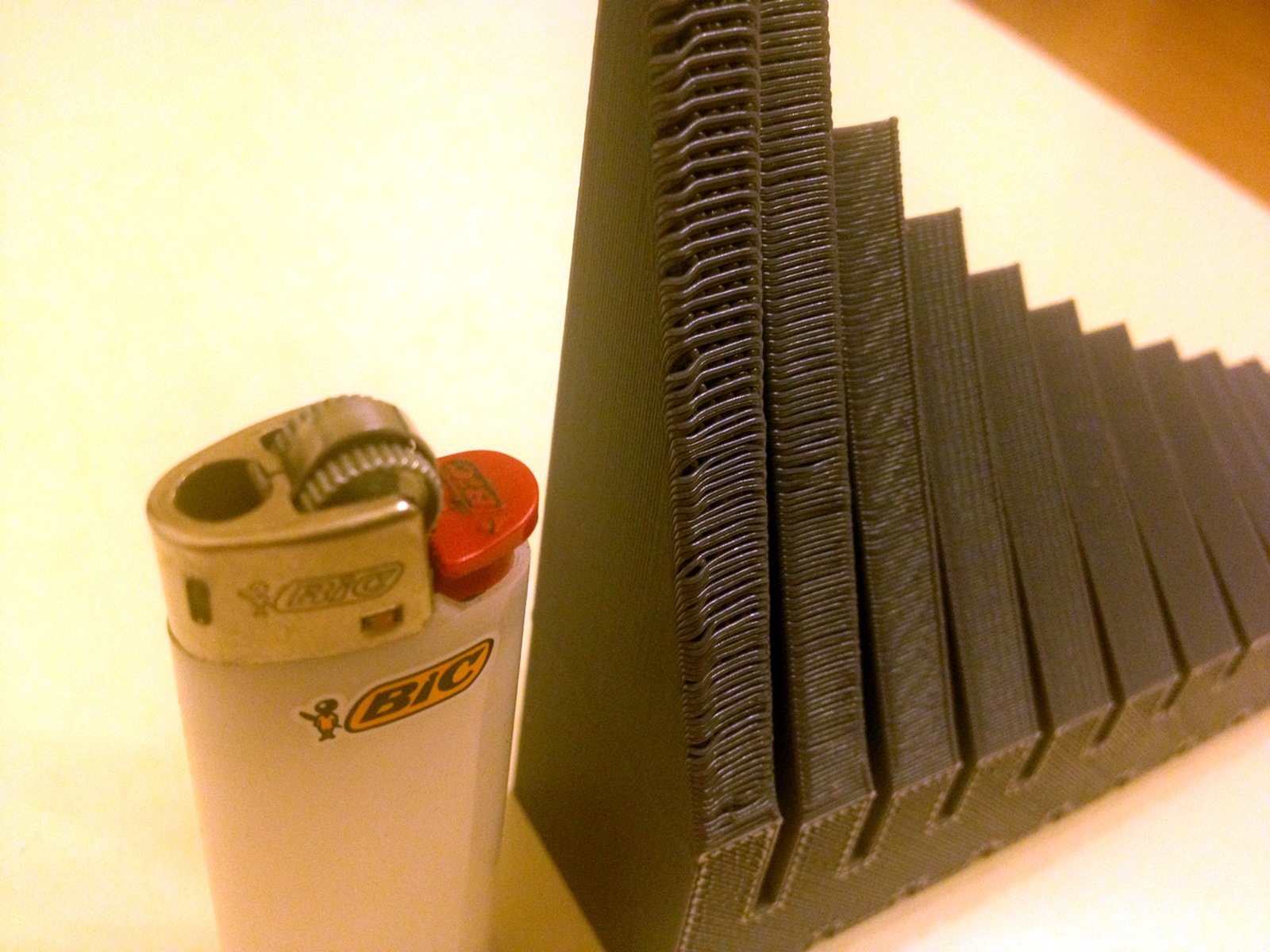

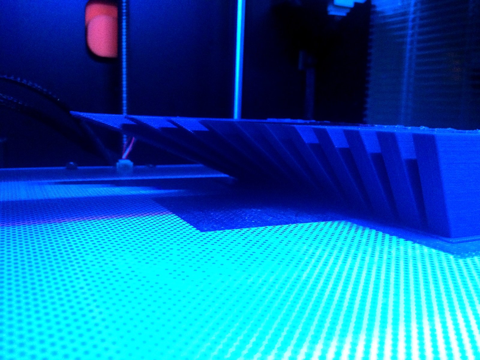

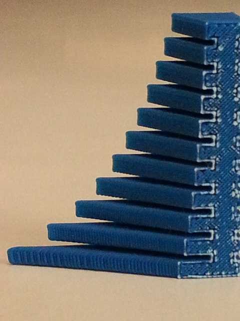

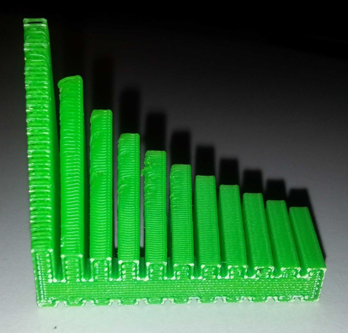

I think zortrax deals better with overhangs than Ultimaker 2. Have you ever tryed to print the Overhang Test Print | Overhang Test Print (Customizable) by walter - Thingiverse with Ultimaker/Ultimaker 2?
This are the results with the Zortrax that i found in the zortrax forum:

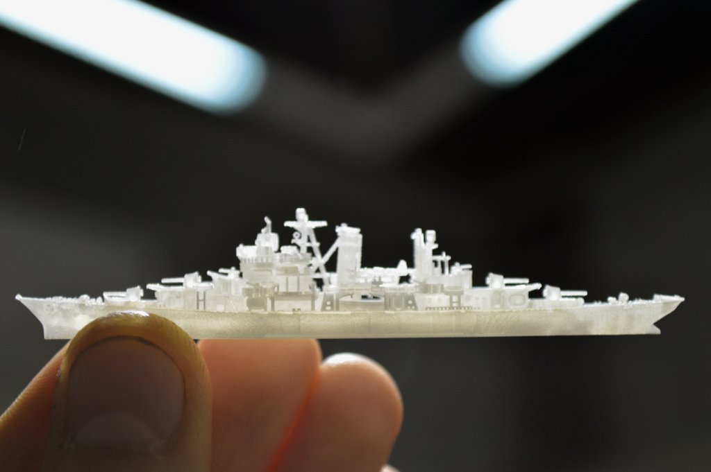

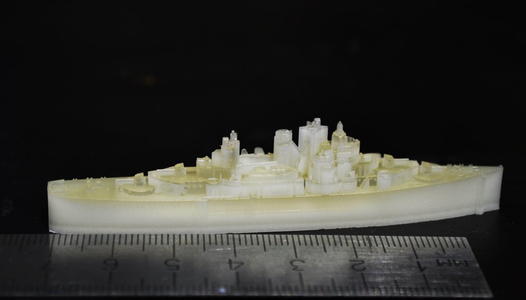

try us :slight_smile: projet 3500 hd max with xtreme resolution can helps you
check out photos of recent order from germany
