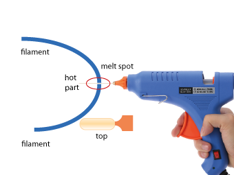

Dunno if it works, bu you can try to weld the filament parts together by using a hotglue gun with a flat end that looks like a knife pressed between the two parts…
