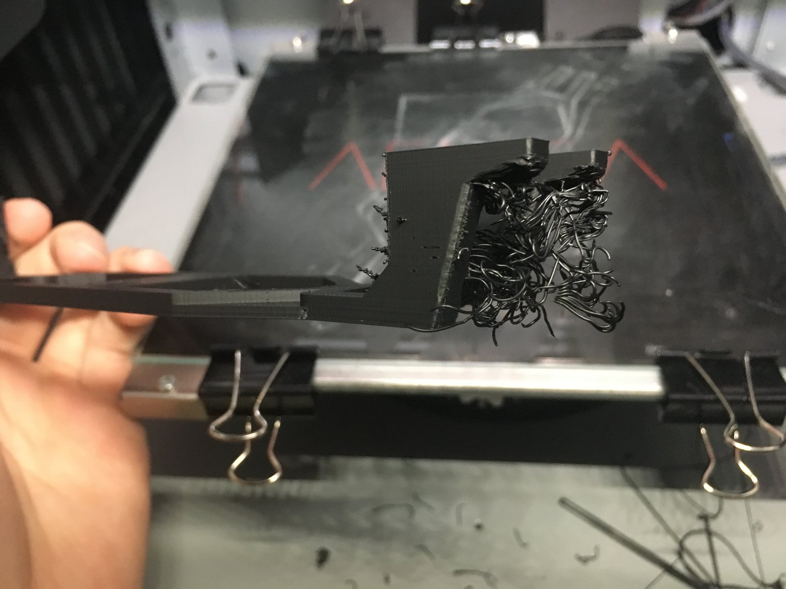

The picture below show the position with the biggest resistance on the y-axis. It is actually so big that it is difficult to move it by hand.

Hey Christian, You might want to try and print this ‘calibration stick’. It helped me a lot on fixing these kind of x,y issues. Velleman Vertex K8400 XY carriage alignment helper by h60 - Thingiverse Greetings,
Thanks,
Clever, as long as your printer at least can print the parts correctly to align itself :wink:
