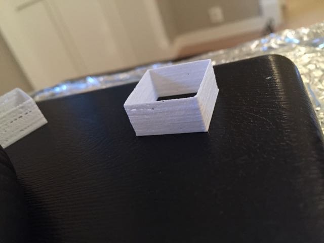

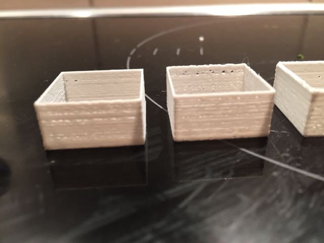

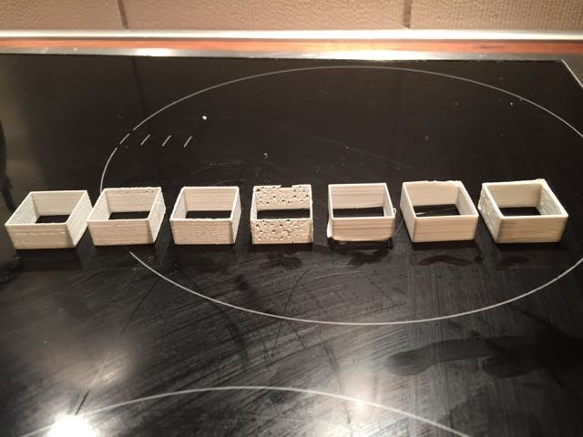

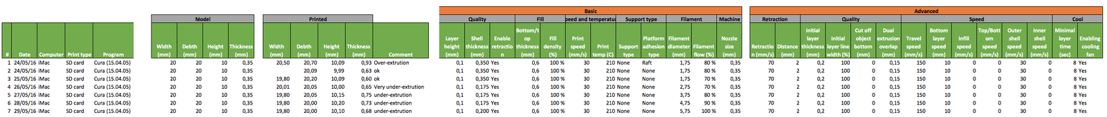

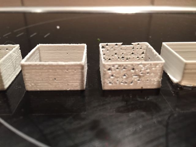

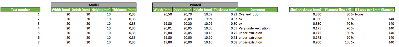

I’ve done some testing.
Results and settings attached.
Pictures of the prints attached
Will test this tomorrow. Thanks for support
I did the testing and came to 149 being the golden number for my estep/mm. Based on this I’ve now been trying to print 0.35 mm walls with both Cura and Slic3r. I’ve read a few tutorials and printed more than 30 examples, however Im not able to print 0.35 mm walls without sever under-extrution.
I’ve tried to adjust (current setting):
- Filament diameter to 1.72mm (which is the average I get when I measure about 10 times)
- Nozzle width is set to 0.35 mm (not tried to change this)
- Extrusion multiplier - tried between 0.7 and 1.1 - Anything below 0.95 give under extrution with the current “extortion width” settings
- Extrution width - tried between 0.25 - 0.5, seems like below 0.35 only result in under-extrution.
- Temperature - tried 200-220, seems like 220 is the best option so far.
Setting where I get 0.35 mm wall, but under extrution (two walls at 0.35mm and the other to around 0.4mm)
- Filament diameter 1.73 mm
- Filament multiplier 0.80
- Extrution width 0.30 mm
Settings where I get 0.4 mm wall, and a slight under extrution
- Filament diameter 1.75 mm
- Filament multiplier 1
- Extrution width 0.35 mm
