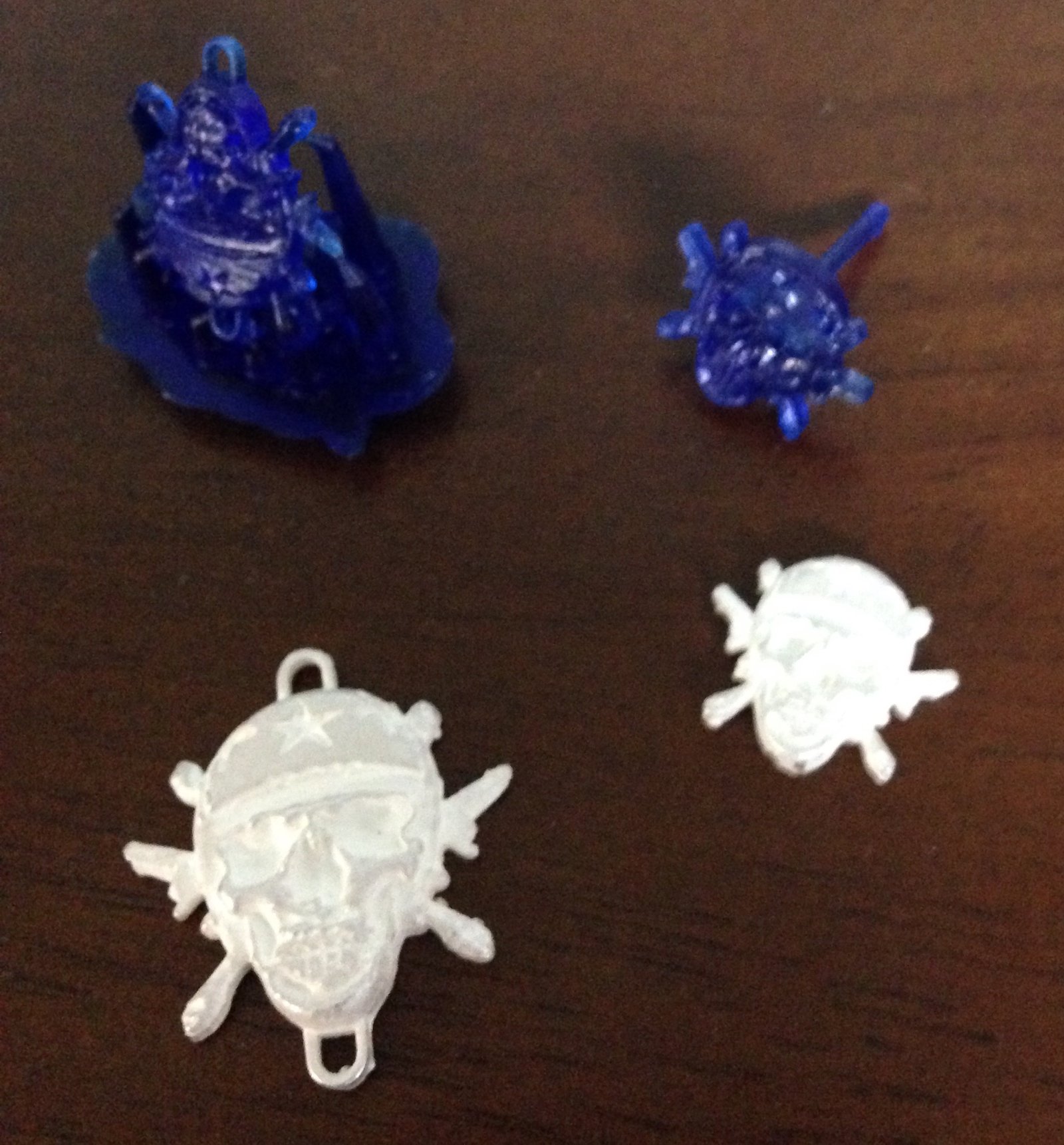

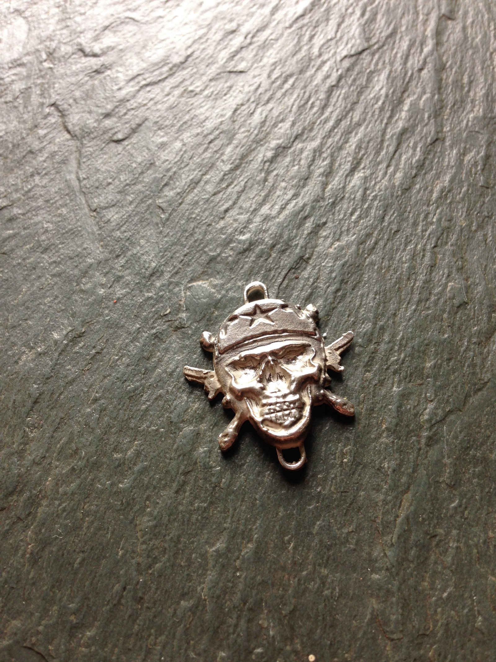

I use a Castable resin which I use to do lost wax casting with. The results from the prints seem to work quite well!

Hi, I print in Emerald Green Resin from B9 Creations and in WaxCast from Makerjuice. If the models are cured well and the foundry sticks to the burnout cycle then result are perfect. Surface quality of the printsouts are allready perfect with no stepping visible for the naked eye.
