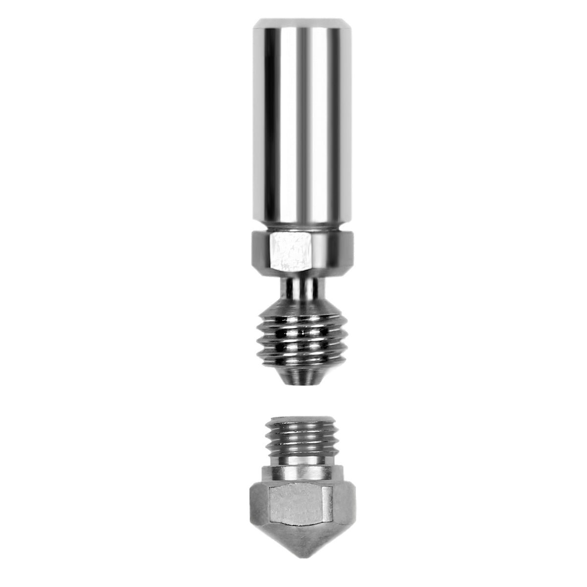

Seeing as the powerspec has Teflon tubes, I highly advise against hot/cold pulls of the filament as you don’t want to get filament stuck in the tubes and damage them. It is always best to push the clog out instead of pulling it out as the pulling method can lodge a clog higher up in the extruder and worsen the situation.
Good point, I missed that part. I upgraded mine with all metal tubes from micro-swiss which makes it a lot more robust. Totally worth it, and once you go through about 10 teflon tubes (which I did) you might as well spend the extra money on the upgrade.
