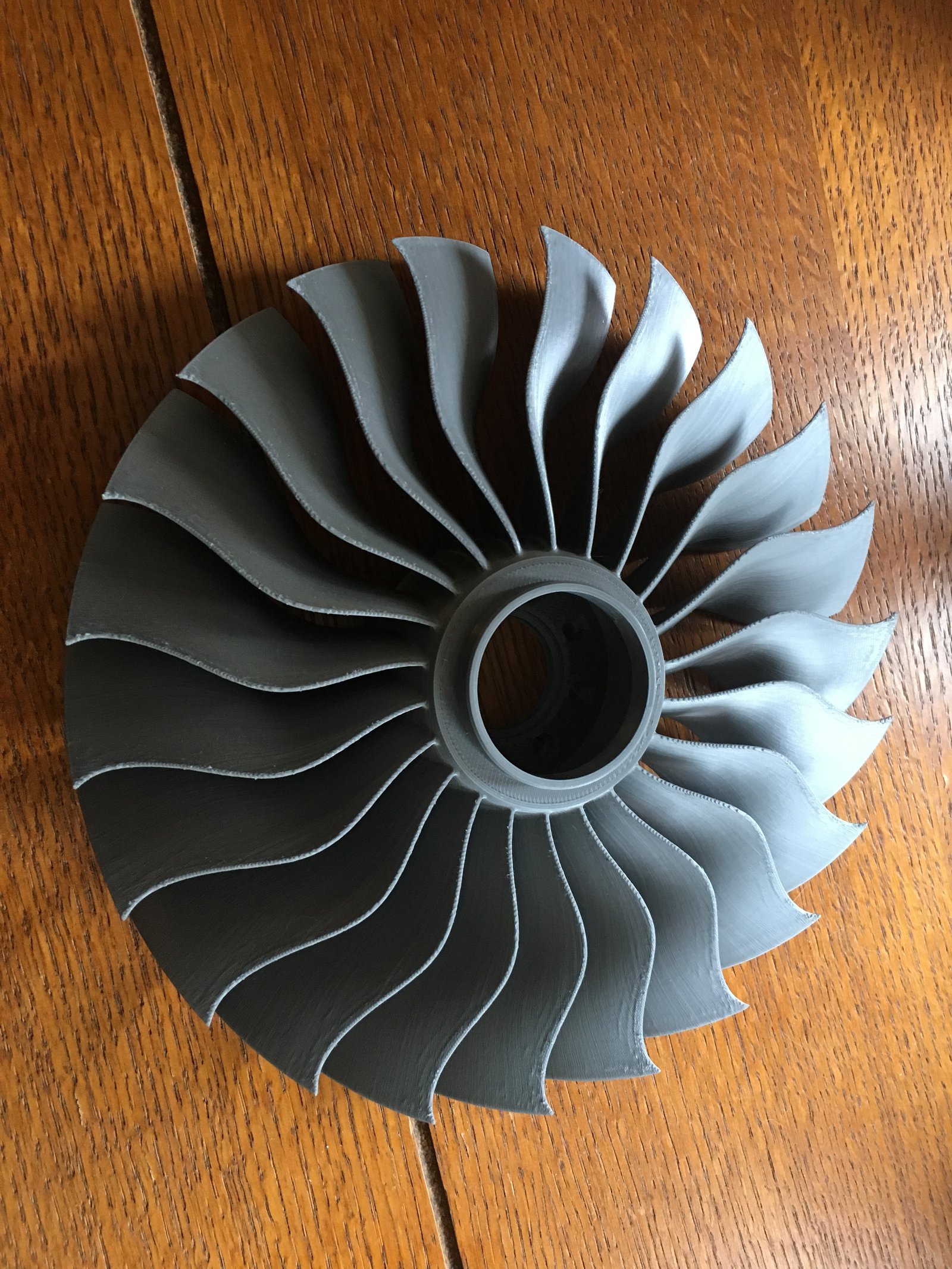

Of course! 3D printed parts can be actually used quite effectively as working engineering components if they are printed with care and in the right material. As a matter of fact, some companies have even turned to 3D printing parts for their machines if a part breaks. 3D printed parts can be very rigid, flexible, and durable. The reason that 3D printers are (generally) not used in the manufacturing business is due to the terrible time efficiency 3D printers have. For example, attached is an image of a turbine I printed for a model jet engine I’m working on. The piece is quite sturdy, and although printed in PLA, will hold up to some decent wear & tear. If I had printed it in ABS or some Ninjatek filament, it would be even stronger. The issue with it is not in the quality of the finished part, but in the time that it took to make it. This print took over TWENTY hours on my Prusa i3 MK2, when an injection mold machine could have made just as good a part, if not better, it in seconds. For this reason, you will not see many 3D printers in the factories. However, there are special cases where 3D printed parts are actually the better way to go. Specialized parts, such as custom medical devices, can be generated relatively quickly. 3D printers are capable of producing wonderful working parts, but right now, they’re just too slow to be an effective solution for manufacturing. Further down the road, as they get faster and faster, we may see more in the manufacturing business. Here’s a link to one of the fastest 3D printers in the world right now. Definately check it out. They’re a 3D printing company that’s looking to turn 3D printing into a fast manufacturing tool: Carbon M1 Super Fast 3D Printer Demo! - YouTube But as for right now, they’re just simply not a rapid production tool.
