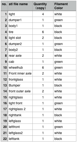

I upload the .STL files on shapetizer.com and you can stream print the parts. It means that you can print it any time using your account and printer.There are 22 .STL files that will be loaded, some of them need to be print more than once. For your convenience, I made a worksheet of parts to be printed, check it.

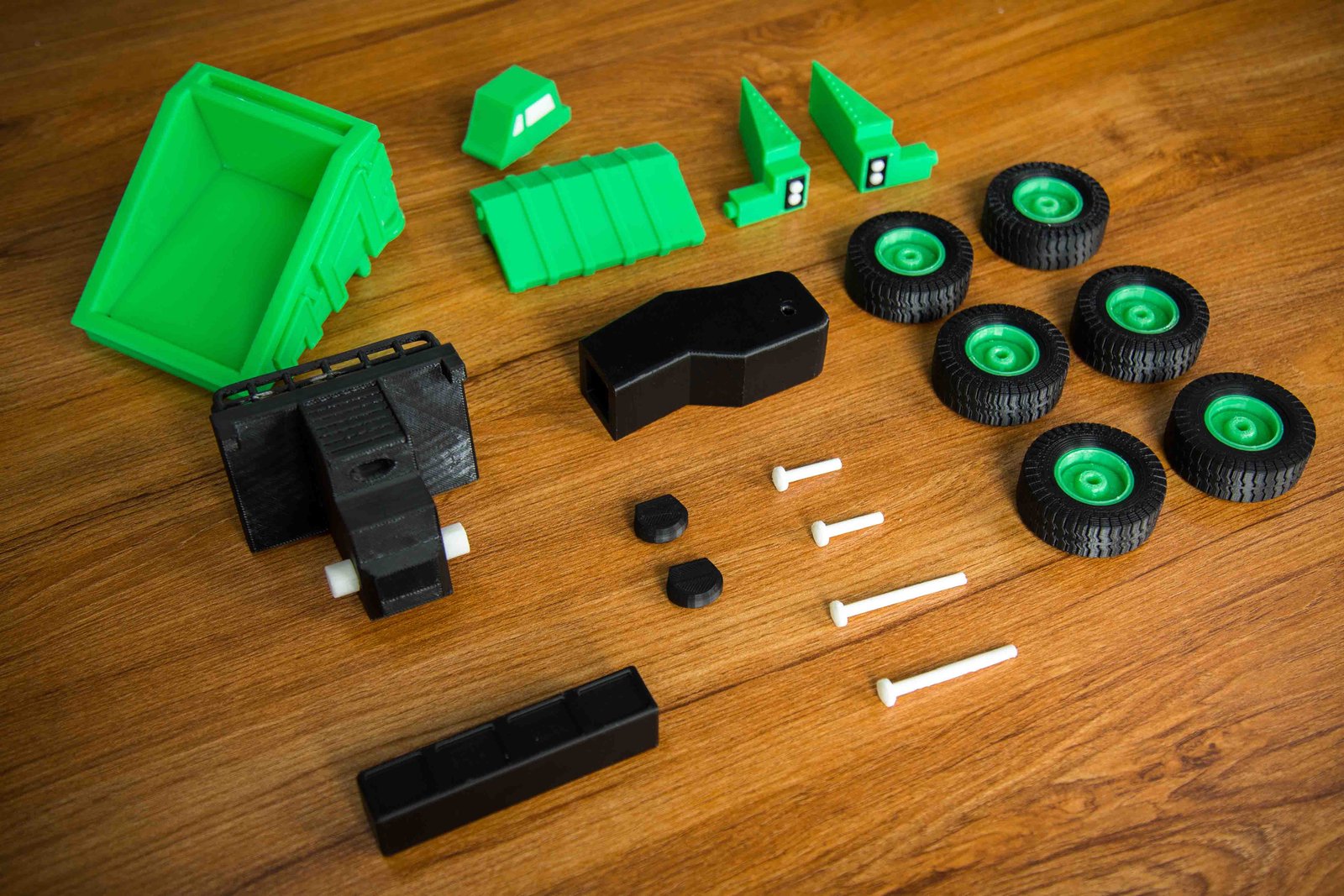

Just follow the worksheet to print! Don’t forget to change the filament with different color, and to add no.1,no. 4,no.5,no.8, no. 10, no. 11, no. 14 stl file in the print platform.And finally ,you will get all the parts needed (check picture parts)

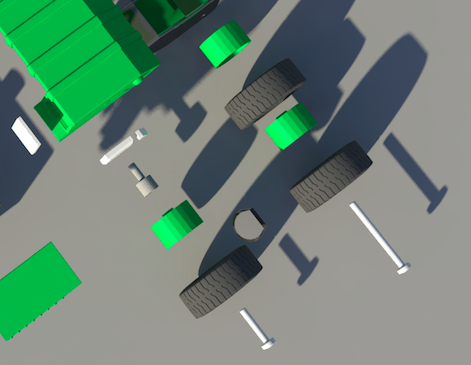

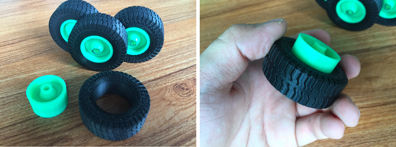

1. Assemble the Wheel
Insert the wheel hub into the tire. 6 wheels are all the same.
2.Assemble the front wheel system
Insert front outer axle through the wheel hub, and into the inner axle. You may need some glue, but remember the wheel cannot be cemented.

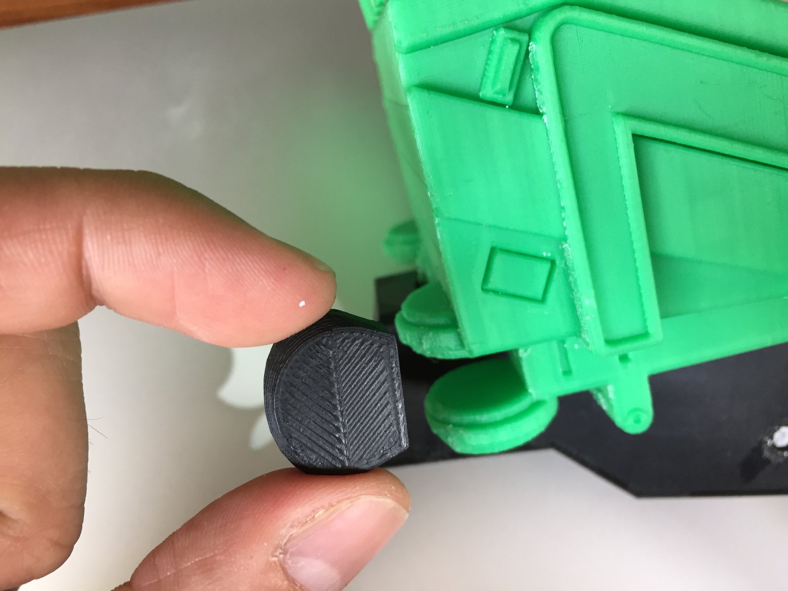

4.Finish the dumper
2 simple parts join together with glue. As shown in the picture, the dumper parts should be assembled with “body2” part.

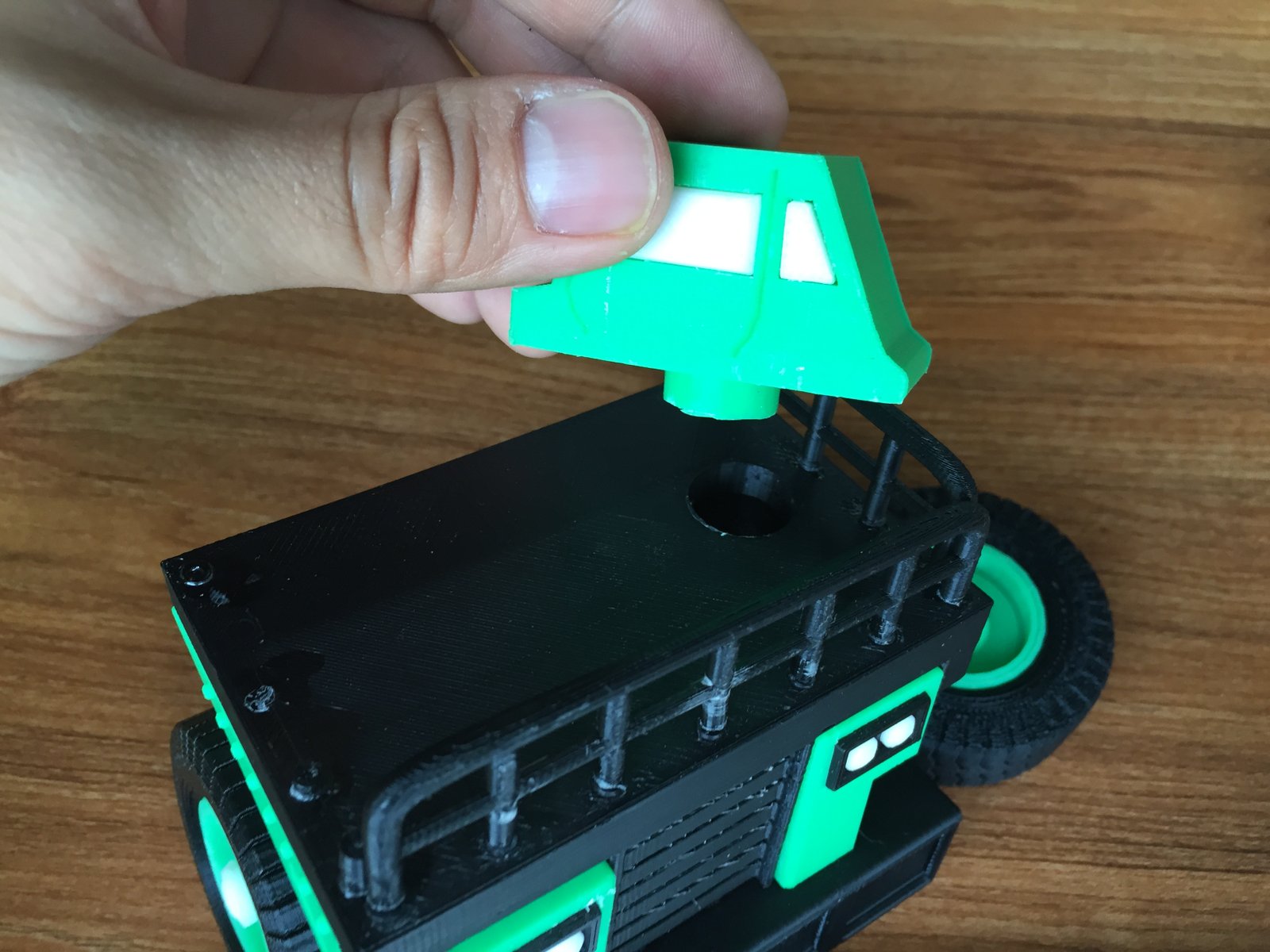

7. The Cab
There are 5 glass widget to be put on the cab. Each has an individual stl file. The cab could be assembled easily.

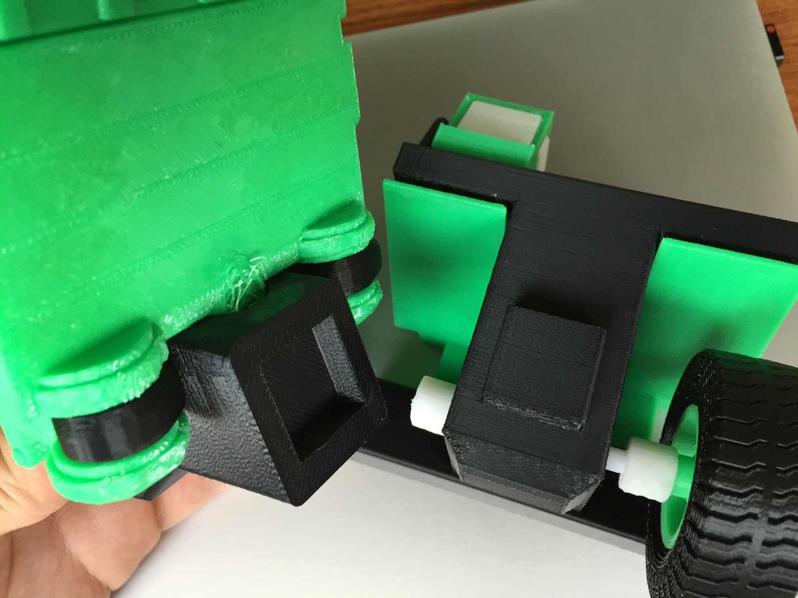

8. Finish the front wheel
Glue is needed here again.
9.Join the front and back part together
