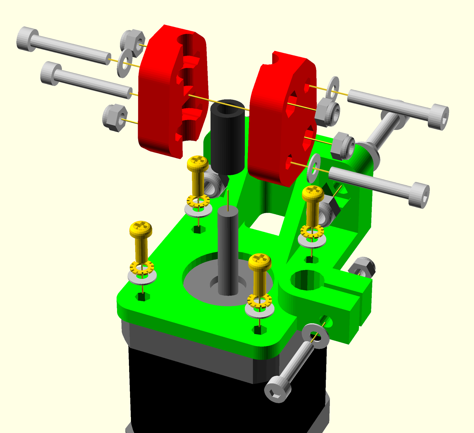

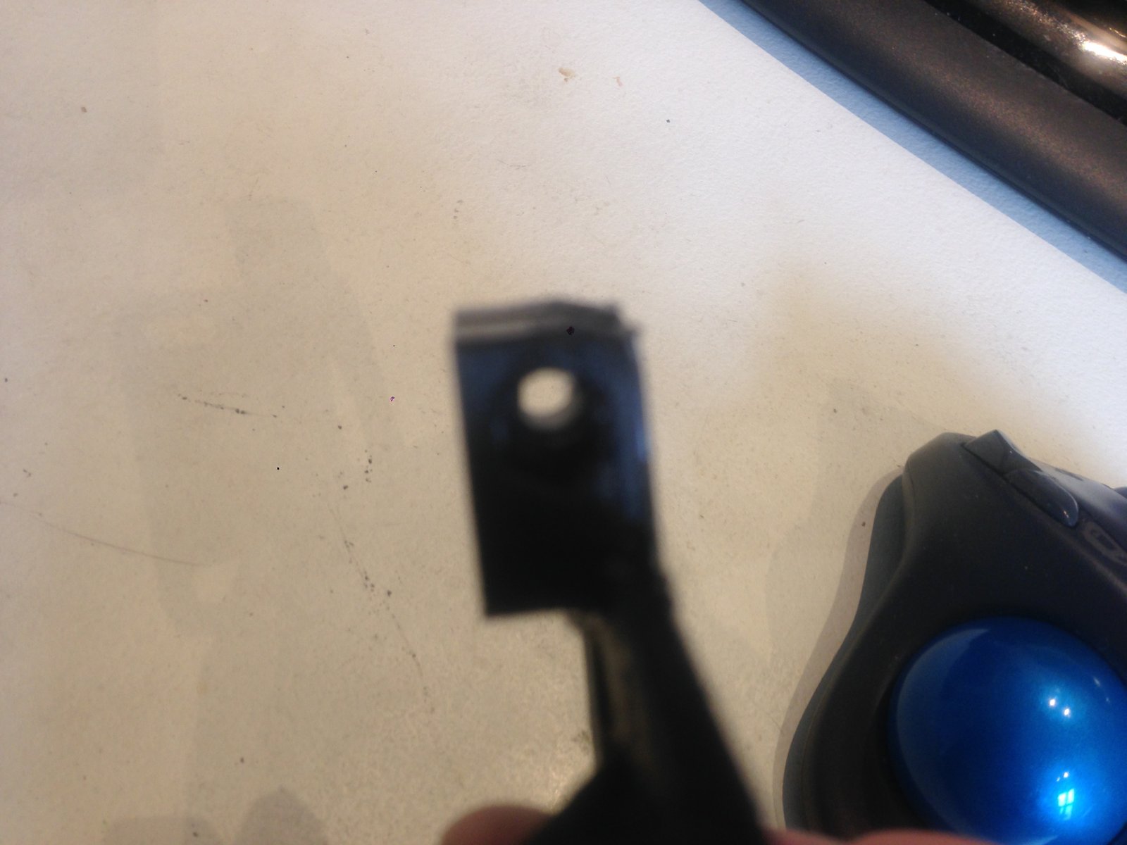

Next is the brackets that holds the Z steppers… hole where the stepper axle pokes through are perfect circle round.
But there are one nuttrap on it that are not perfect, its like it has been pressed a bit flat
Any suggestions why that might be? to high print speed? i have attached an export from openscad and a pic taken with phone of the print…
As an experiment i have lowered the speed and printing the other Z stepper bracket

Hmm - Do you have a couple of print examples with those settings?
