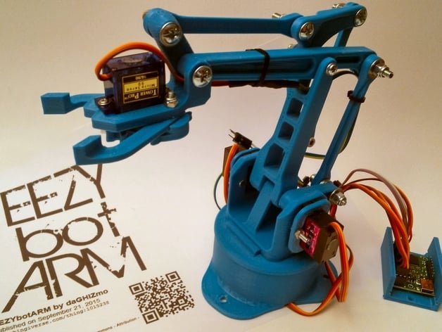

If you want a 3D Printed Robot, I highly recommend the EEZYbotARM:
It’s based on the very popular MeArm and aimed for the first timer, so you can use the plentiful sources for it to build your own robotic arm :slight_smile:
I recommend buying legitimate servo motors from a hobbystore and not eBay, because there’s a lot of fake motors that could be too underpowered.
And go for the metallic ones such as a real MG90s because plastic ones like SG90 can break inside.
