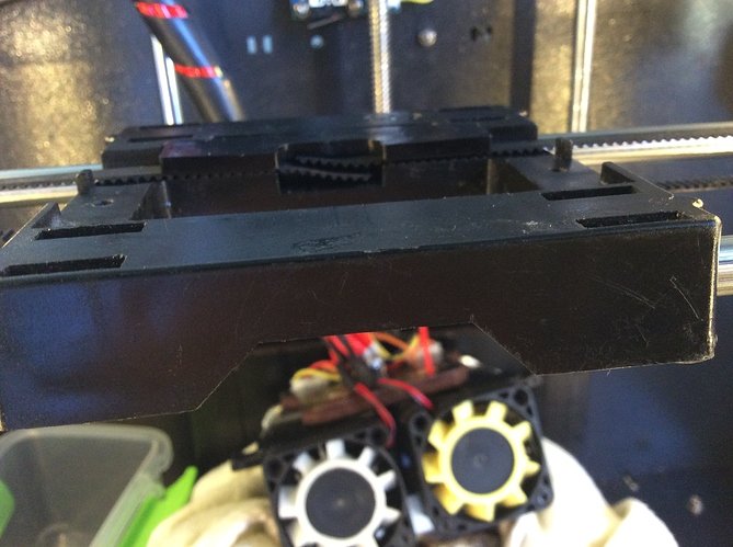

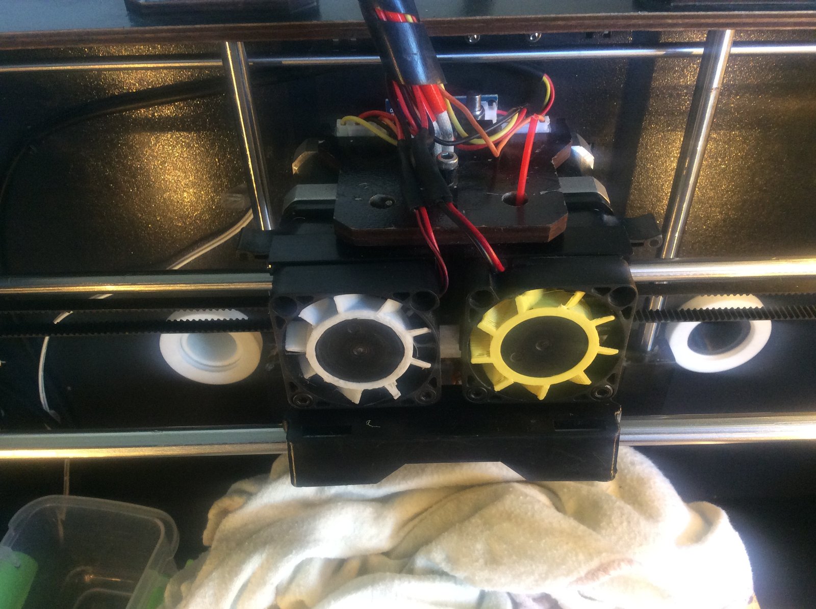

Once the screws are loose leave them in place and remove the extruder of the carriage and place onto something soft don’t directly rest it on the nozzles.

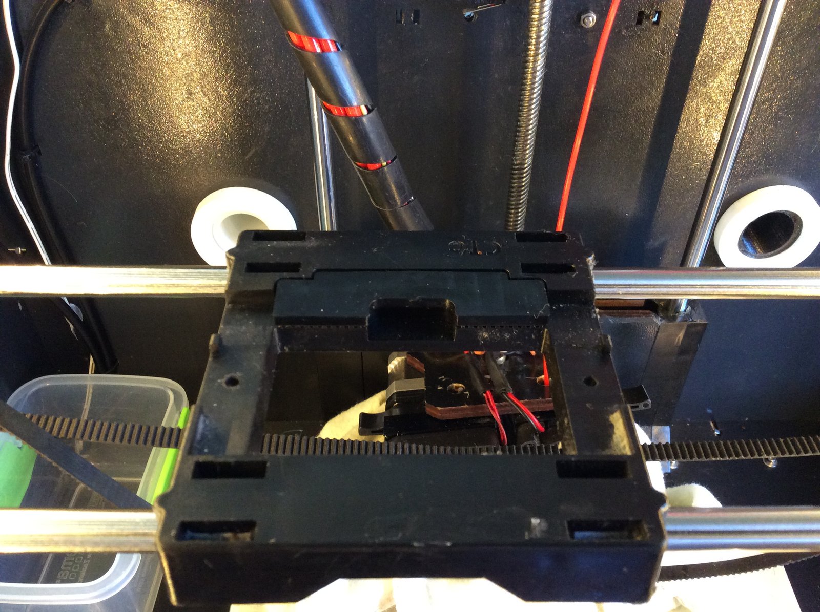

Step 3
This is where it can get quite a handful and help from a friend would be quite handy, once the extruders are of you must loosen the X-Axis belt this can be done by either undoing the 4 stepper screws on the end of the carriage or by removing the belt clamp which are the other two screws underneath the carriage

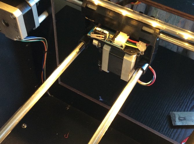

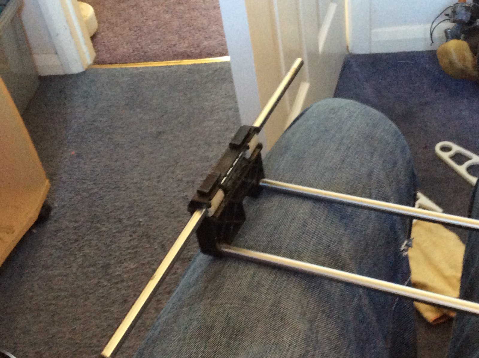

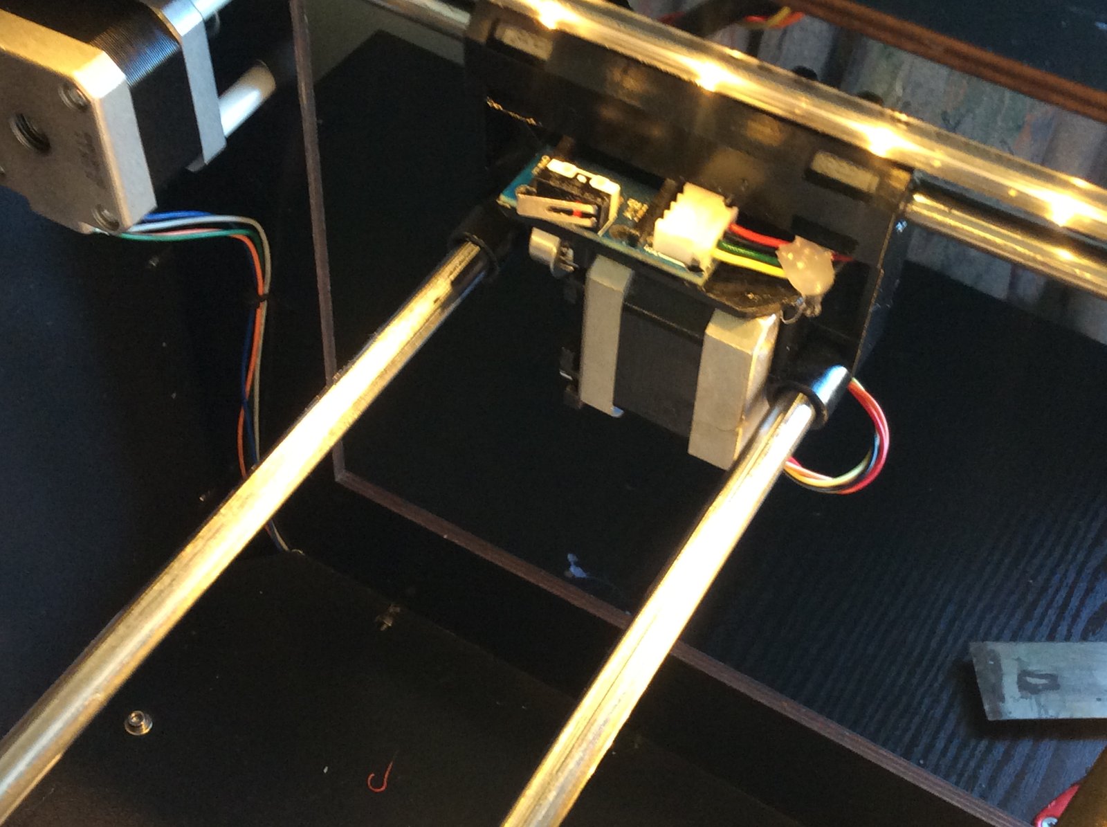

Once loosened completely remove the screws in the left hand side of the machine and put them in a box of some form so you don’t loose them ! Now comes a tricky part, removing the x axis rods can be quite tough but word of caution don’t just pull or push one axis as you can damage the machine this way, hold firmly the stepper side of the axis and pull the left side away from the right this way you are supporting both sides
Step 4

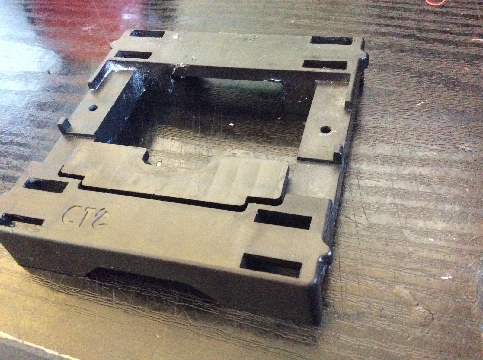

Either before you take the axis out you can remove the plastic X carriage of the rails by pushing down on the rails lightly and up on the front portion they will snap out and repeat for the other side. While disassembled it’s a great idea to clean your axis’s up as i first replaced my Y-Axis bearings as they were making horribly annoying noises and so there was still lots of grease on the arms of the carriage.
Don’t forget to take out your bearing on the left hand X-axis end !

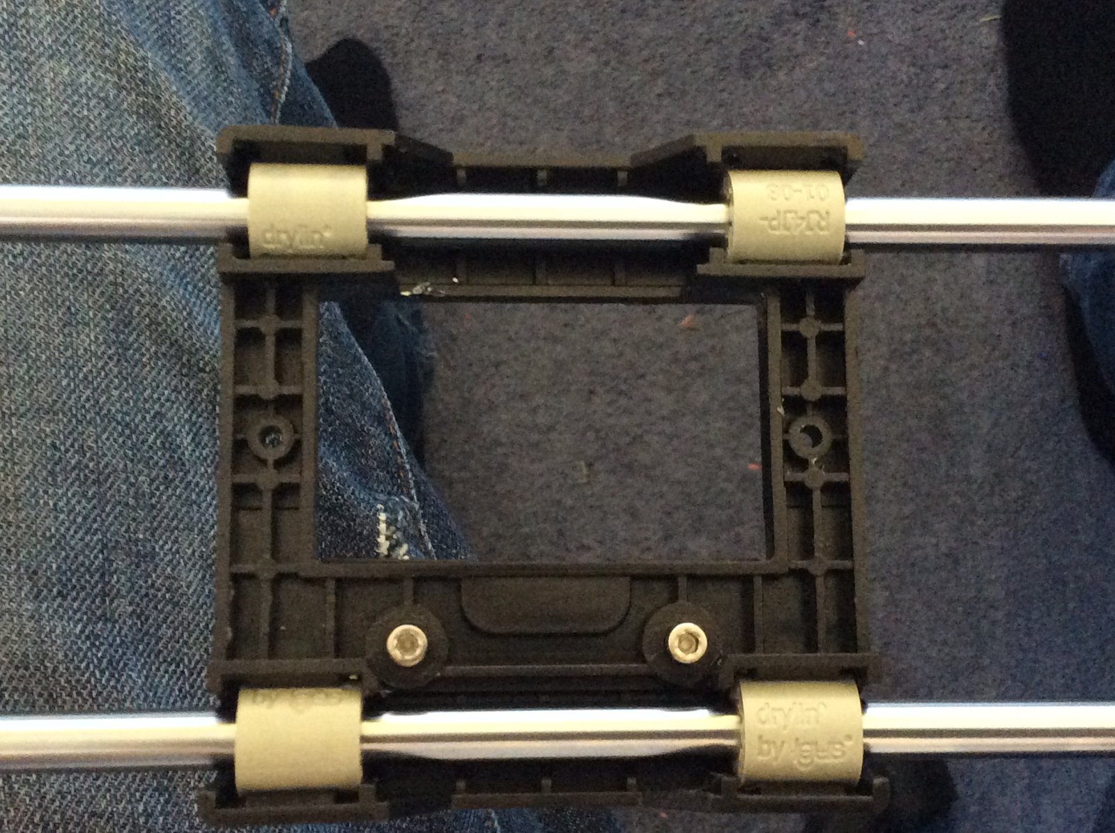

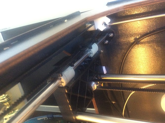

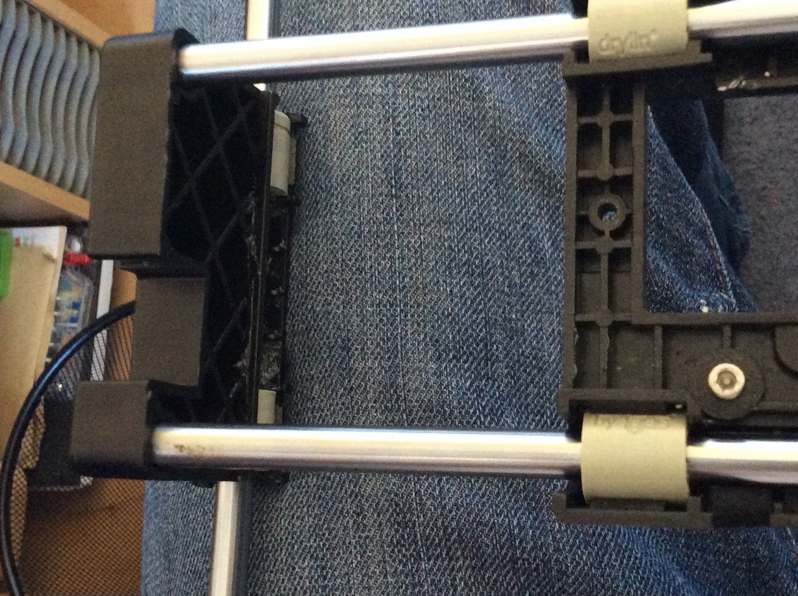

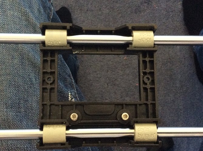

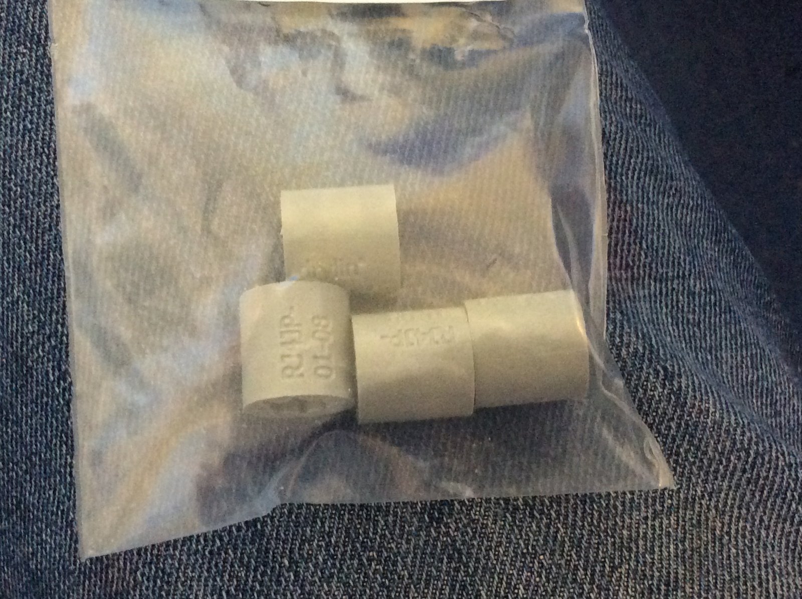

It’s time to take those horrible “Linear” bearings of and say hello to the new smooth IGUS Polymer bearings.
At this point you have two choices you can either buy standard size LM8UU bearings and cut them from 25MM down to 17MM or buy them from the same supplier as i got my second set from i can vouch for these and they are already pre-cut to size
http://www.ebay.co.uk/itm/Makerbot-Replicator-2-2X-IGUS-Lager-wartungsfrei-leise-maintenance-free-bushings-/252011586572?hash=item3aad0fa40c
You can either install them on the axis and snap the carriage on to them but it is easier to just install them in the carriage and then slide it on to the axis rods.

This step is just the reversal of the removal make sure the carriage isn’t installed backwards then just install the axis and rods into the stepper assembly side.

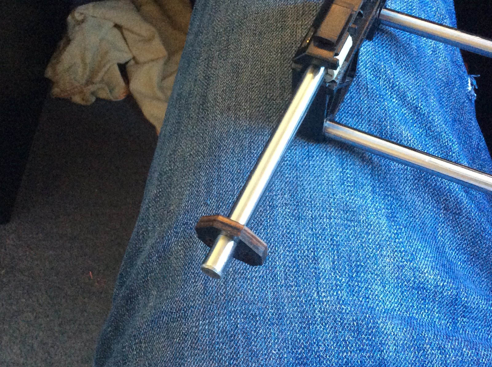

Make sure you put the ends on the rods to attach it to the frame!
Install the screws and nuts and tighten lightly then push each rod up and tighten fully by doing this you know that both of the rods are perfectly straight and true to each other.
Re-install the X-Axis belt, if you took the stepper out to release the belt put the belt around the gear before reinstalling the stepper into the frame otherwise you will never get it back in. Once it is back in place push the stepper away from the x-carriage to put tension on the belt and tighten the allen screws.

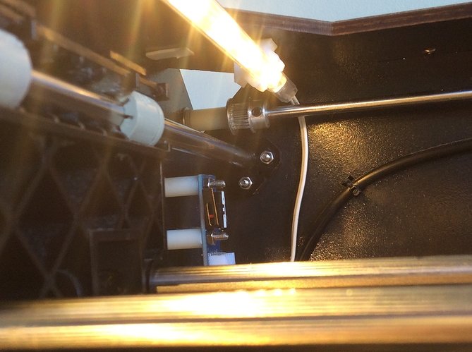

When reattaching the belts for the Y-Axis push the axis from the centre to the back until the limit switch clicks then wrap the belts around the top of the gears and slide it into the first or rear slot on the x arm.
Do the same for the other side so when you pull the other side of the belt taut both sides will have equal load and tension and the axis will run straight and true to each other and make sure the top of the belt is taut to do this when installing the second part of the belt use the pliers to pull the belt as you will have better grip and pulling power and will be able to get the belt as tight as needed just don’t over tighten it!

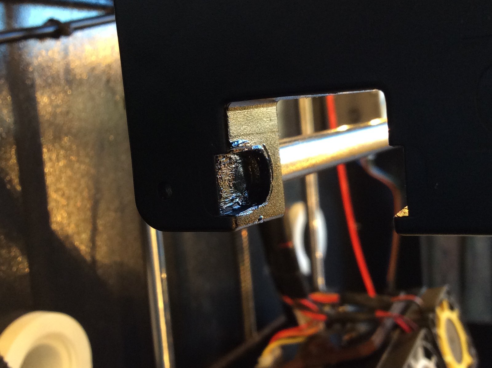

Re-installing the extruders is as simple as taking them of 2 allen screws into the block and tighten gently… this is when i managed to strip the right hand thread of the block so be carefull if you manage to do what i did get a 3mm bottoming tap and re-tap the hole and use a slightly longer m3 screw so it has more of the block to bite into and you have less chance of stripping the screws !

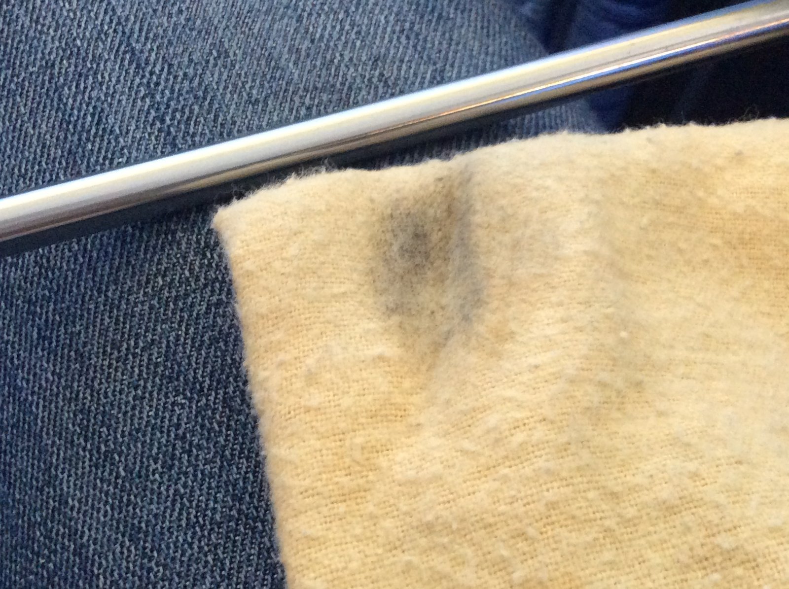

Forgot to mention when you have the rods of if you have used any sort of grease / lubricant use some acetone to wipe down the rods of any contaminants this will ease in binding and sticking.

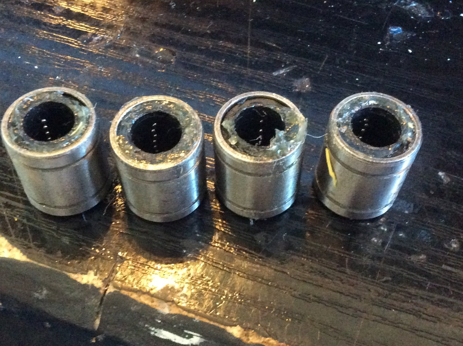

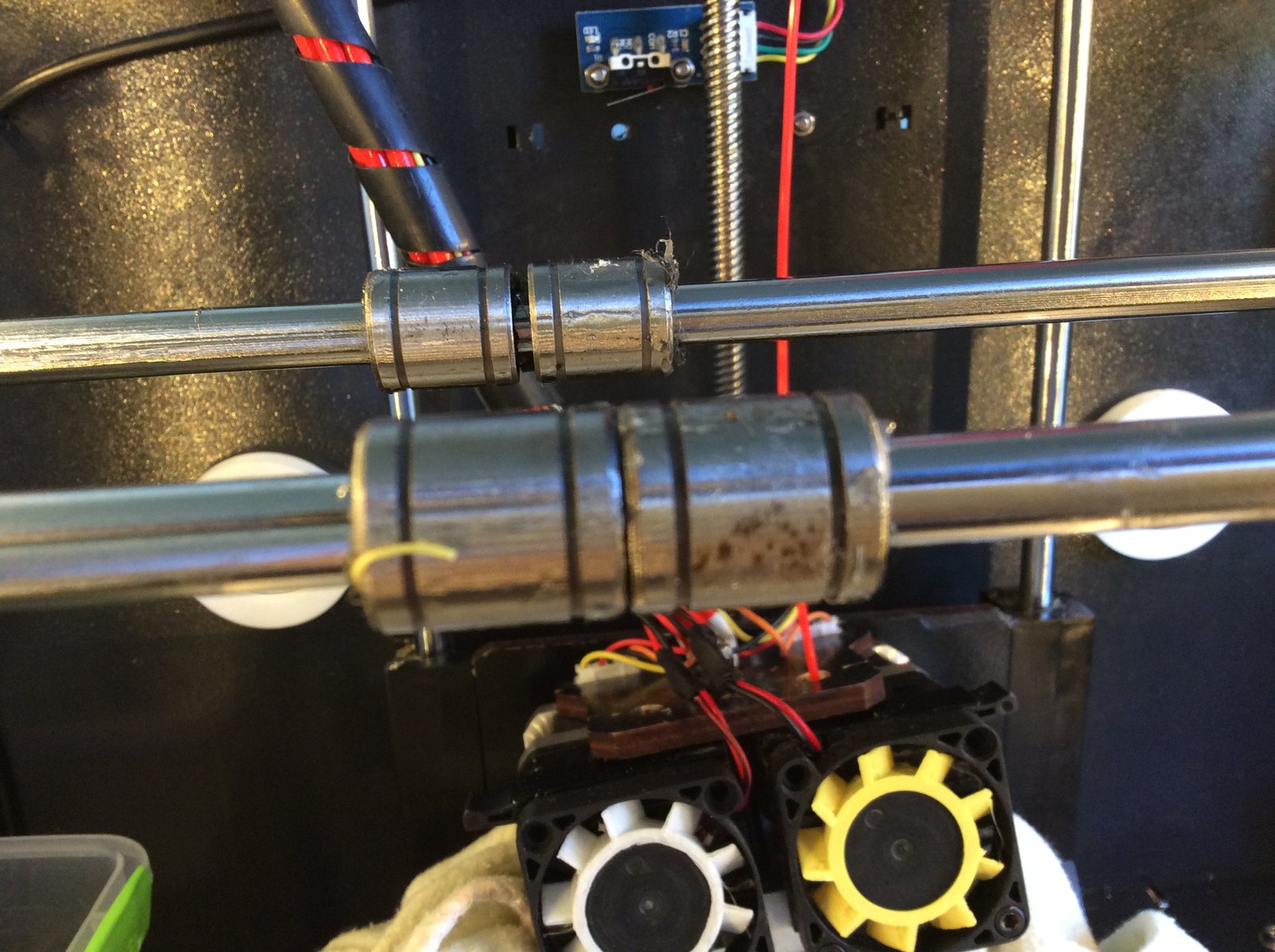

You have now gone from these horrible manky not so linear bearings

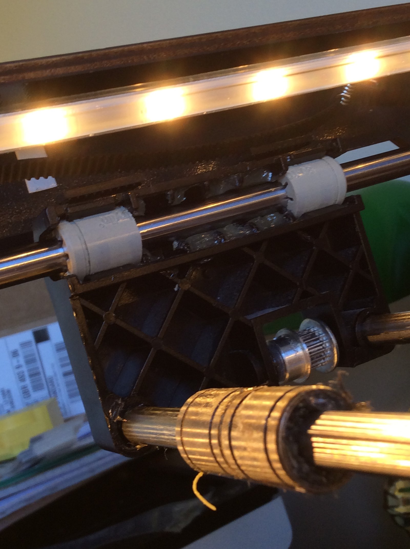

To these lovely, quiet very linear polymer bearings
This upgrade will help with ringing on parts, noise levels and generally make you love your printer that little bit more while the machine is apart you can also replace the Y-Axis bearings for even more stealth.

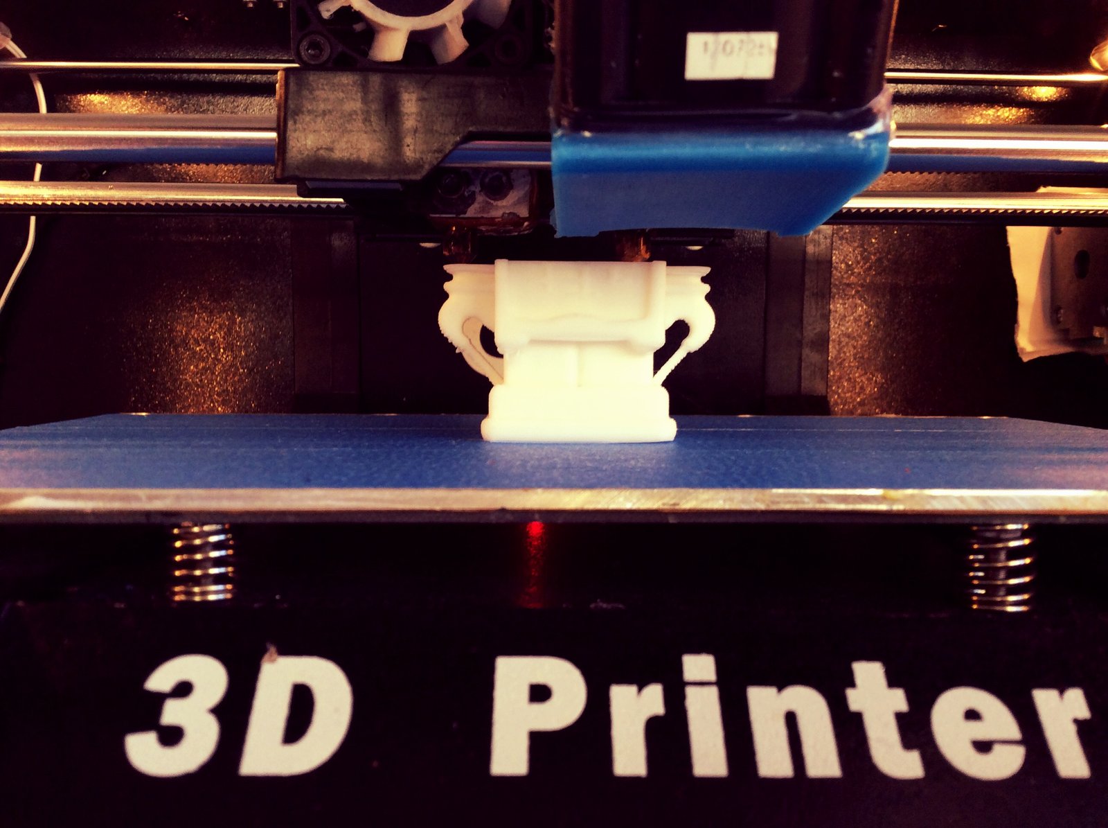

Print quality after upgrade!
0.35mm Layer height looks better than ever and so precise !

Done this mod but I put the bearings into the housings 1st and the rods wore stiff. I thought this aint right and put the bearings on the shaft 1st and now they are there silky smooth

I am looking to switch my Flashforge to Igus bearings. It’s worth noting that Igus lists their RJM-01 solid bearings as being for press-fit applications. They will be slightly loose if not press-fit into a housing. For what we’re doing it’d probably be better to use RJUM-01 or RJUM-21 lined bearings.
