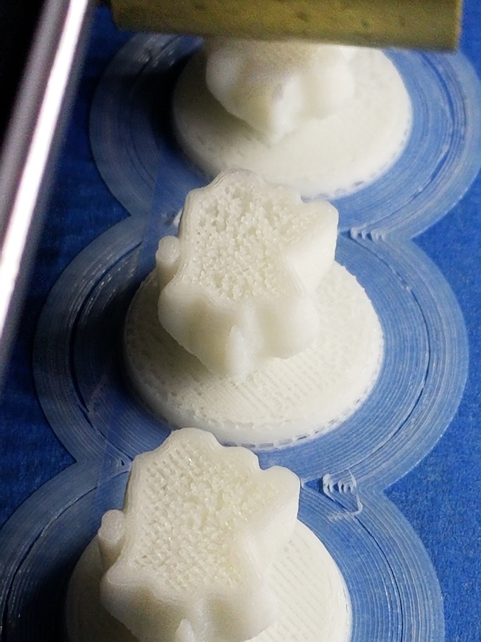

I think this might be under extrusion but I am not sure
I recently had to move my printer and in the process snapped the filament. After getting everything cleaned out I have been attempting to do a few test prints. I have been dealing with barely any plate adhesion, to which I did a bed leveling. I am noticing now though that on my print I am getting unsmooth areas, something that I haven’t gotten before.
I am using the Monoprice Ulitmate
Anyone have any ideas?
UPDATE:
I was able to resolve this issue by upping my temperature from my normal 195 to 225. I havent an idea as to why I had to up my temperature since I have been using 195 for a while now, any thoughts?
