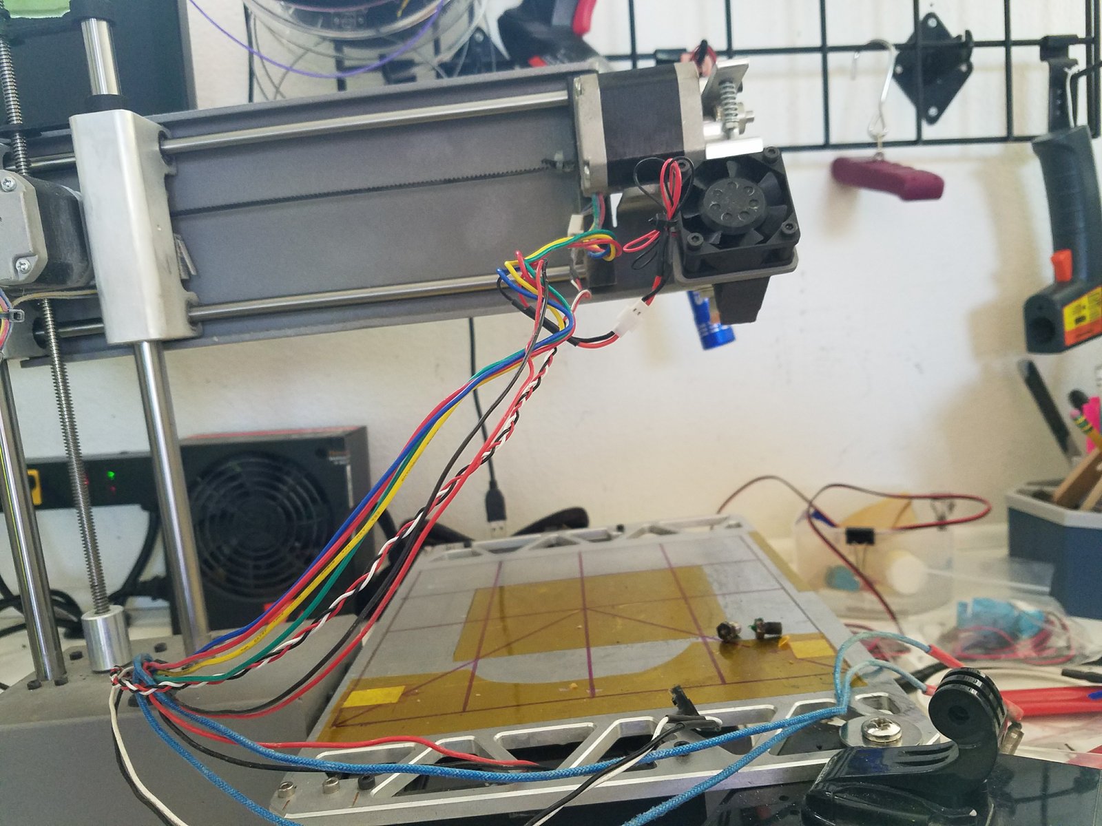

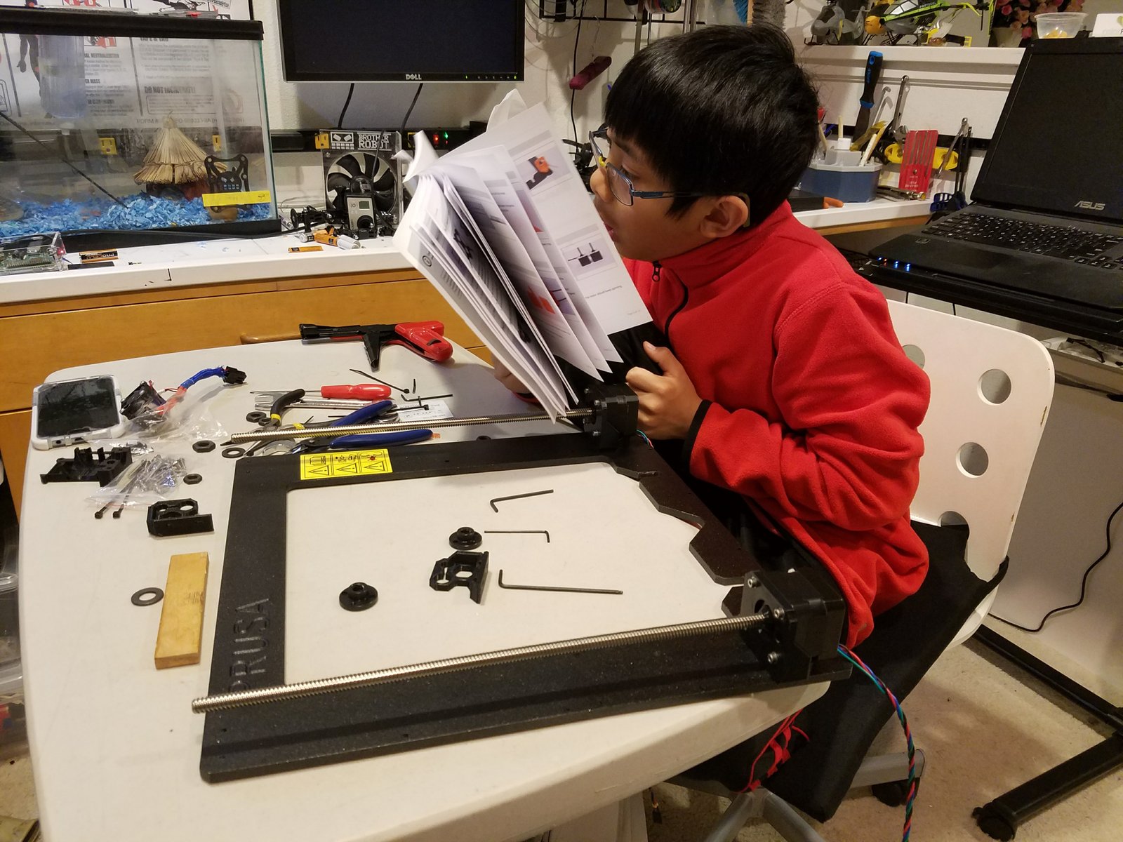

Hello! I’m going to share what I share with every school and teacher who ask me and my brother what 3D printer to buy. Buy a Prusa i3 Mk2 to build or buy an R2 from Robo 3D. I built all the printers I use for my 3D Hubs. It is not easy and takes a lot of time, but you learn a lot. Robo 3D has the best support and you can visit them.
I would build them though for 3 reasons.
1. 3 Printers. Machines can break down and waiting for parts is sad.
2. 3 Printers with E3D Hot Ends. E3D Hot Ends can print anything.
3. Knowledge. If you can fix your own printer you don’t have to wait if you break down.
