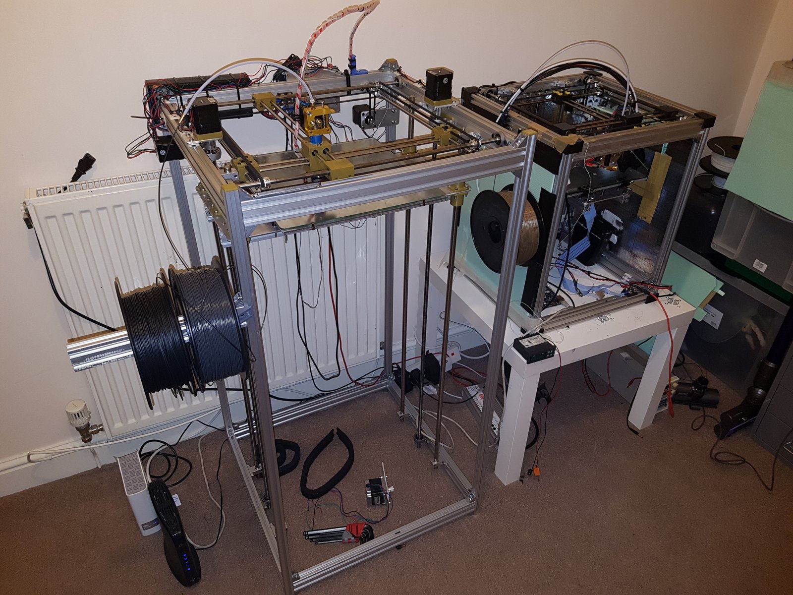

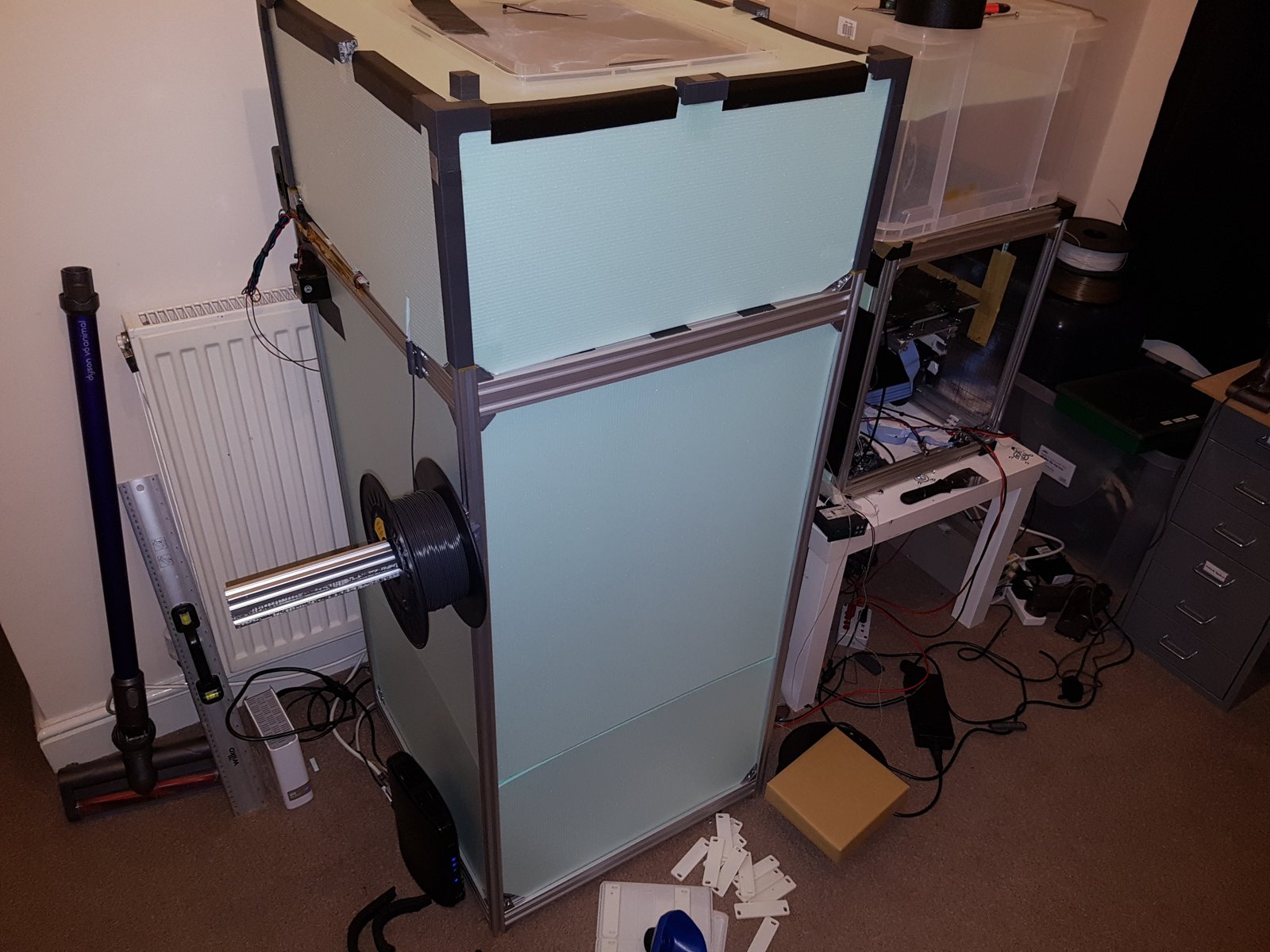

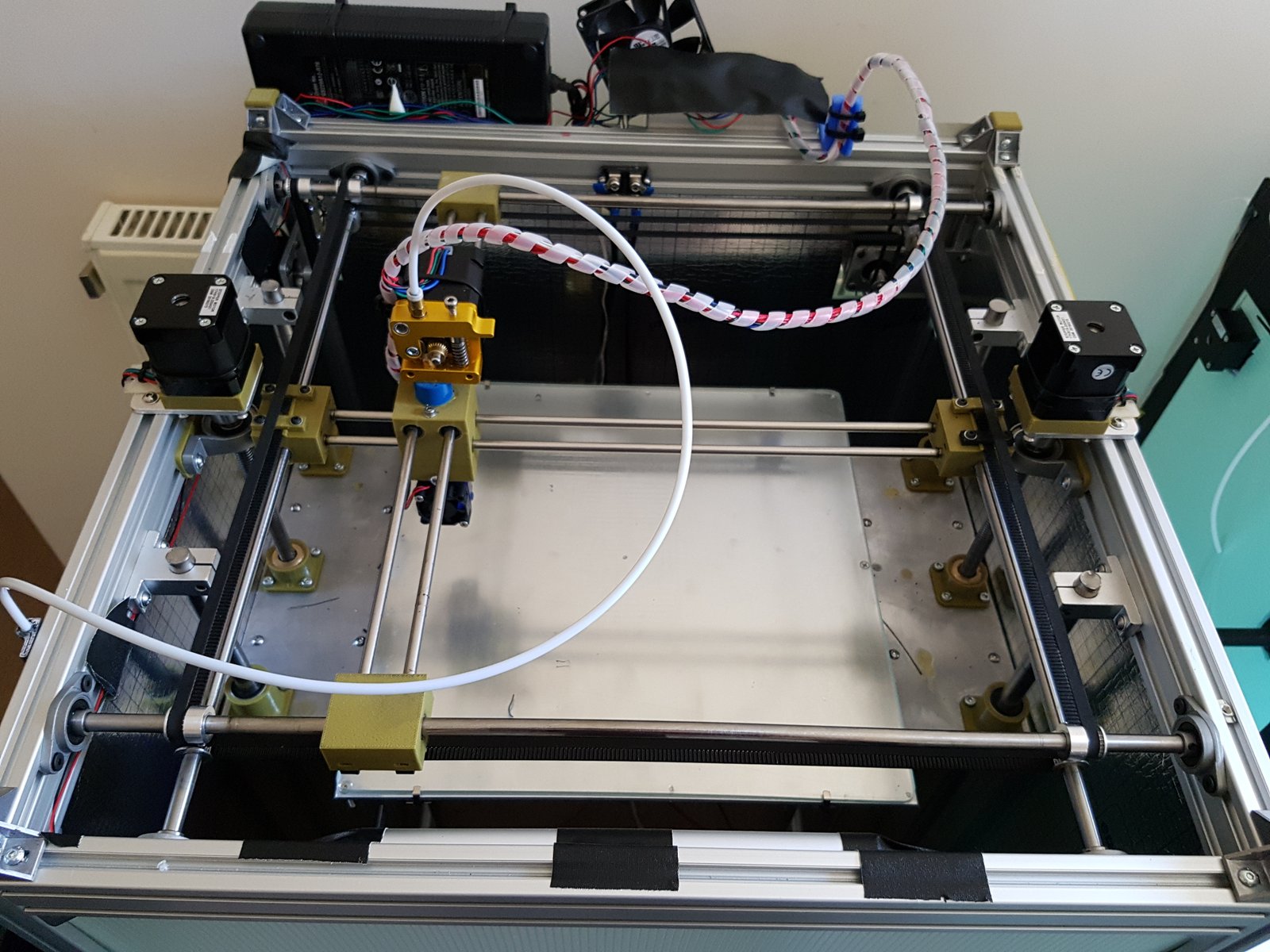

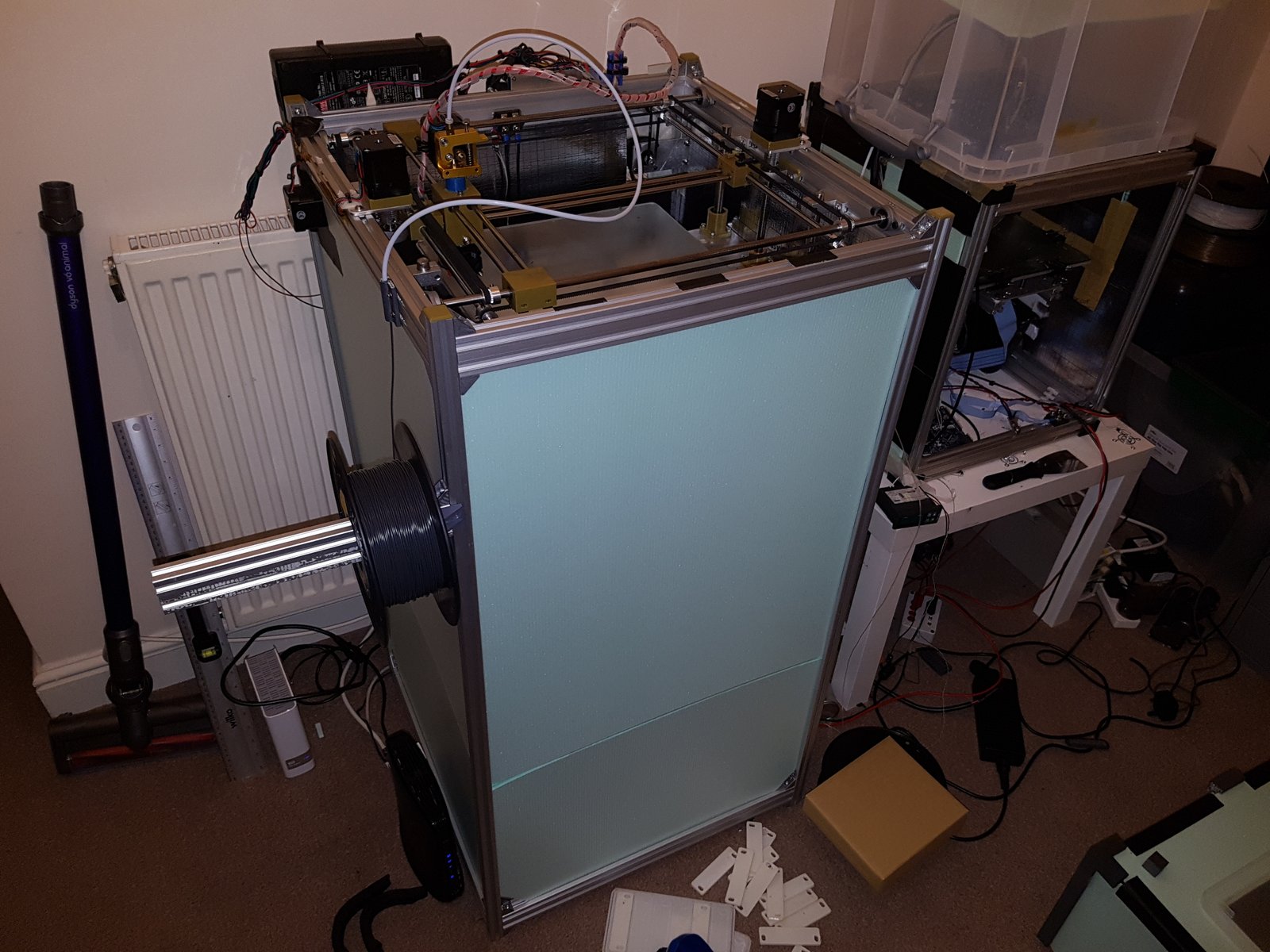

I own 3 Zortrax M200’s and was looking forward to printing larger parts on the M300 until i found out they were asking over 4K for one. I decided to design and build my own large scale 3D printer with a heated chamber after experiencing warping issues on the M200. I built this monster in less than 2 weeks and for less than 1K. It stands 1.35M tall and 0.55M wide with a build volume of 300X300X750mm. Get in touch with my Hub if you think you have a large scale project that will put it to good use!

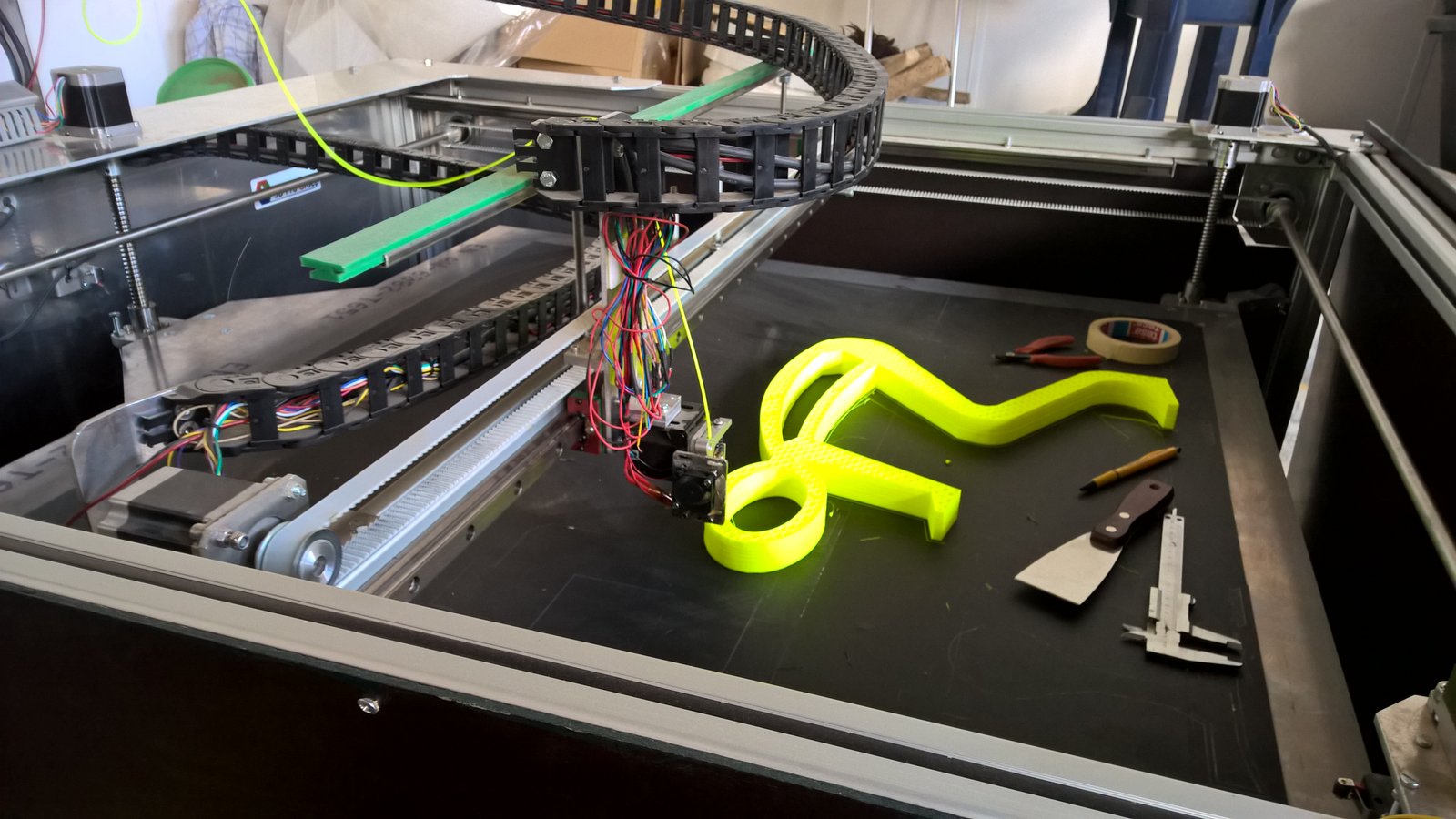

We are building a 3D printer with a build size of 950x950x950 mm just for printing PLA. First test prints have been done.
That looks great! Nice setup and made use of high quality parts like bearings etc. Where did you order those? Misumi?
peter I have a Raise N2 Plus and after several month now my findings are that this printer is the worst piece of scrap i ever had in my hands, air printing is regular, losses of prints due tu mutual failures of nearly all parts in this printer are adding up to over 90 %, quality is pessimum, the rods are to weak, the head with his weight is bending them several mm, the ventilators where falling apart during the first few prints, clogging of nozzles is his middle name, fuzzy prints which look like a cat under electroshock is normal, even the guys at Raise could not print a sellable model with flex material after i send them a file, this is one of the examples where a company gets the cheapest and not apt parts and throws them together into something which does never have the chance to work just to make a fast buck, its a so called hit and run business model. Sorry but i had a Zortrax 200 for nearly 2 years you can not even name the two at the same quality level, my lawyers are preparing to sue this company for fraud at the moment. But its the sellers which by transmitting unproved bulls… like vastly superior without having worked with the machine thats how those companies make money, some 800 companies pop up every year and the same number is gone after a season when clients who where tricked into buying this technical crap where pulled over the table, this is fraud, smells like fraud and tastes like fraud, period.
All the bearings were sourced from bearingboys.co.uk. I used olite bushings on the X/Y axis as the blocks slide along the rods and the rods also rotate.
