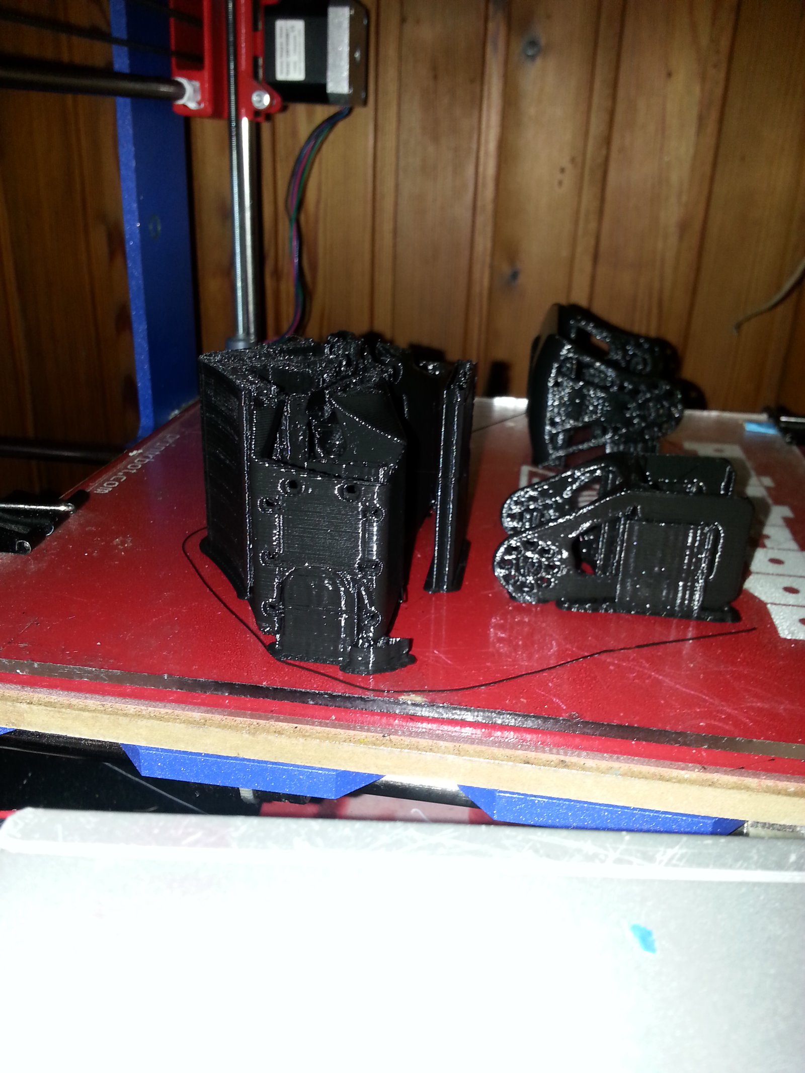

We’ve all experienced it at some point. Your prints just randomly stopping, your extruder getting clogged mid way, or anything else, the result is the same: when you come back to your printer all you see is half a print.
This happened to me this morning so I decided to make a quick post on how to make the best of the situation.

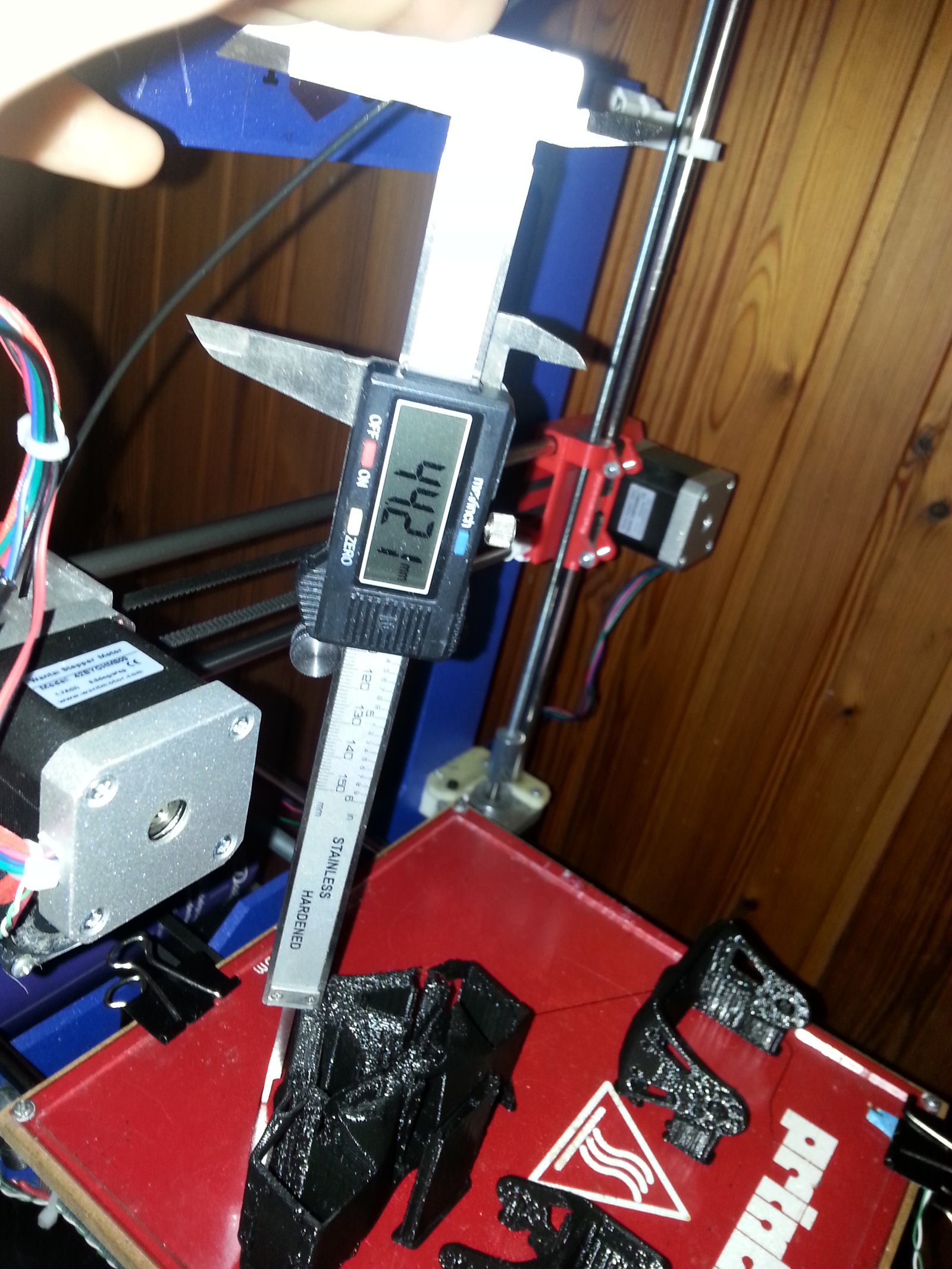

  • Measure the height your print managed to achieve.
The height measured was 44.2mm, in this case I am using a layer height of .32mm with a first layer height of also .32mm.

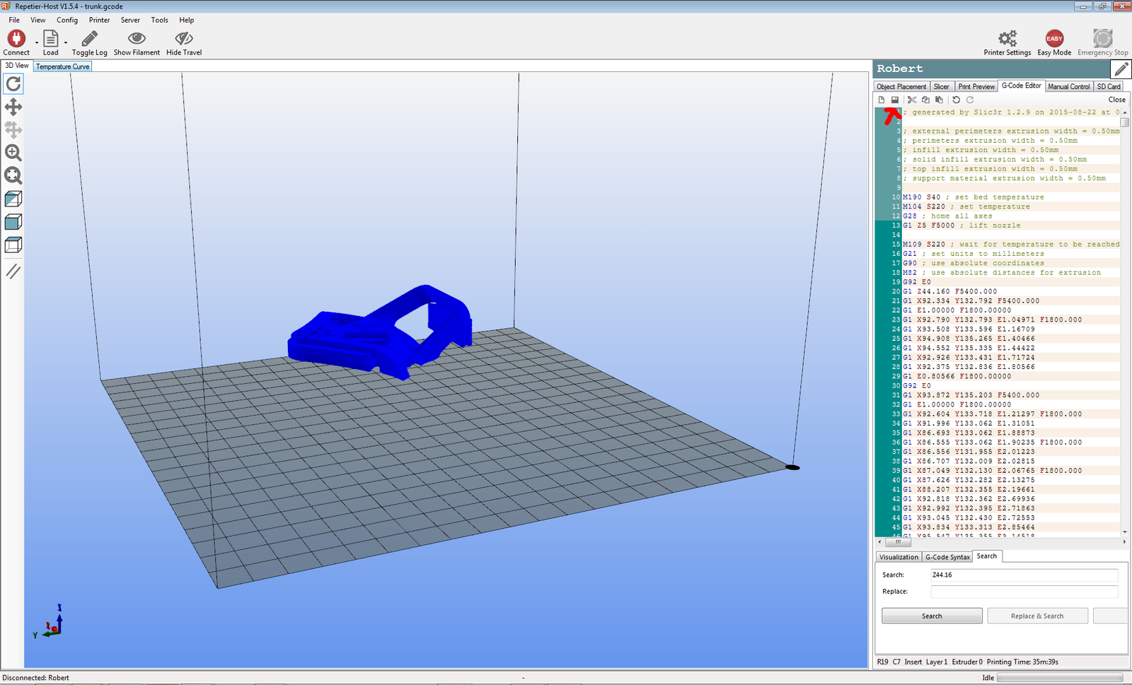

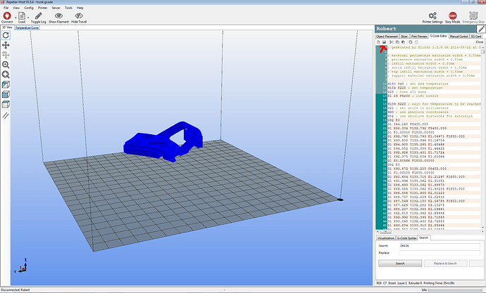

Edit your Gcode. In this case, I am using RepetierHost, but you may use any program to edit your code.
  • Search for the line of code indicating the Z-value. Add a Z before the calculated height
In my case, I need to search for Z44.16
  • click to select the end of the previous line of code
  • Then scroll up and, while pressing shift, click on the end of your start Gcode (all the descriptive code)
  • Delete the selection. You are now left with what you need to continue printing. Save it.

When your print stops give the command M114.
This gives your exact z- height.
Look for this number in the g- code.
When you found it delete everything before this.
Load the code and start printing.

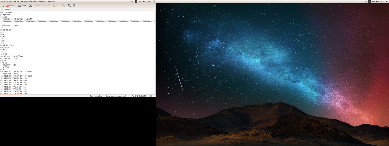

I wrote a python utility for doing this. You just have to load the output.gcode file back into repetier.
@TURush3D that’s simply amazing, thanks so much! I’m trying right now to edit the gcode of a failed print
Can I ask you a question? Until where I have to delete the code? Because the first lines are different from the rest of the program body.

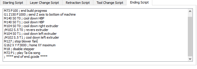

Just for precaution, standby to immediately stop before the nozzle crash onto your model and re-adjust your pre-setting. For me, I need to relocate manually the nozzle at X & Y axis before it goes down (homing Z, refer below). Attached the pre-setting for example. Change if required.
M106 S0 ;make sure fan is off
M18 ;turn off motors
G28 Z0 ;homing Z
G1 Z105 F18000 ;move nozzle up
G28 X0 Y0 ;homing X/Y
G1 X115 Y300 F2000 ;move heated bed forward for easy access to clean
M190 S60 ; set bed temp & wait
M109 S230 ; set extruder temp & wait
G1 X115 Y150 F2000 ;move extruder to the center
Hopefully it might help others. Sorry for my English.
