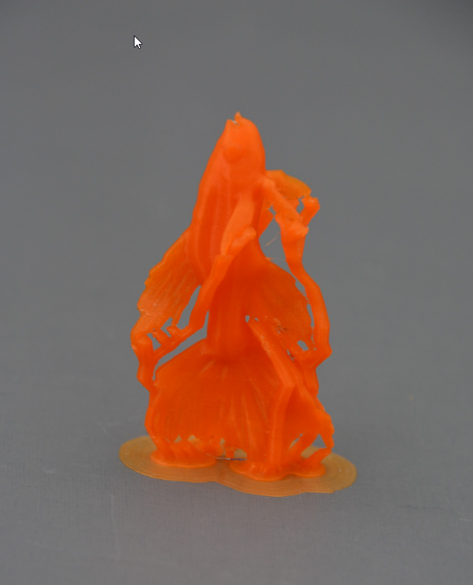

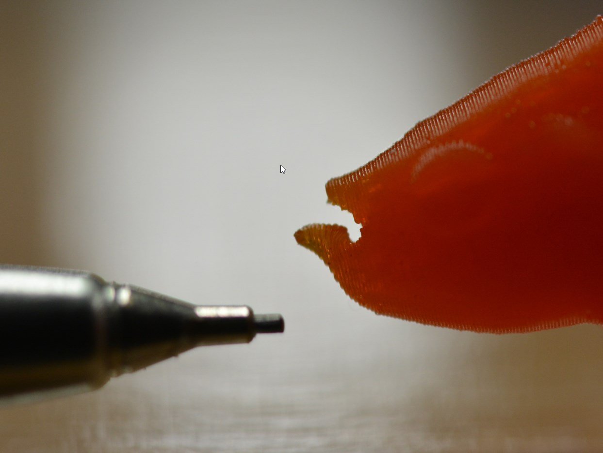

Incidentally one of the very first prints I did after buying Simplify 3D would have had this issue, but I was blown away by the job it did right out of the box. Check out the pics. Not saying it can’t be done in other software though…

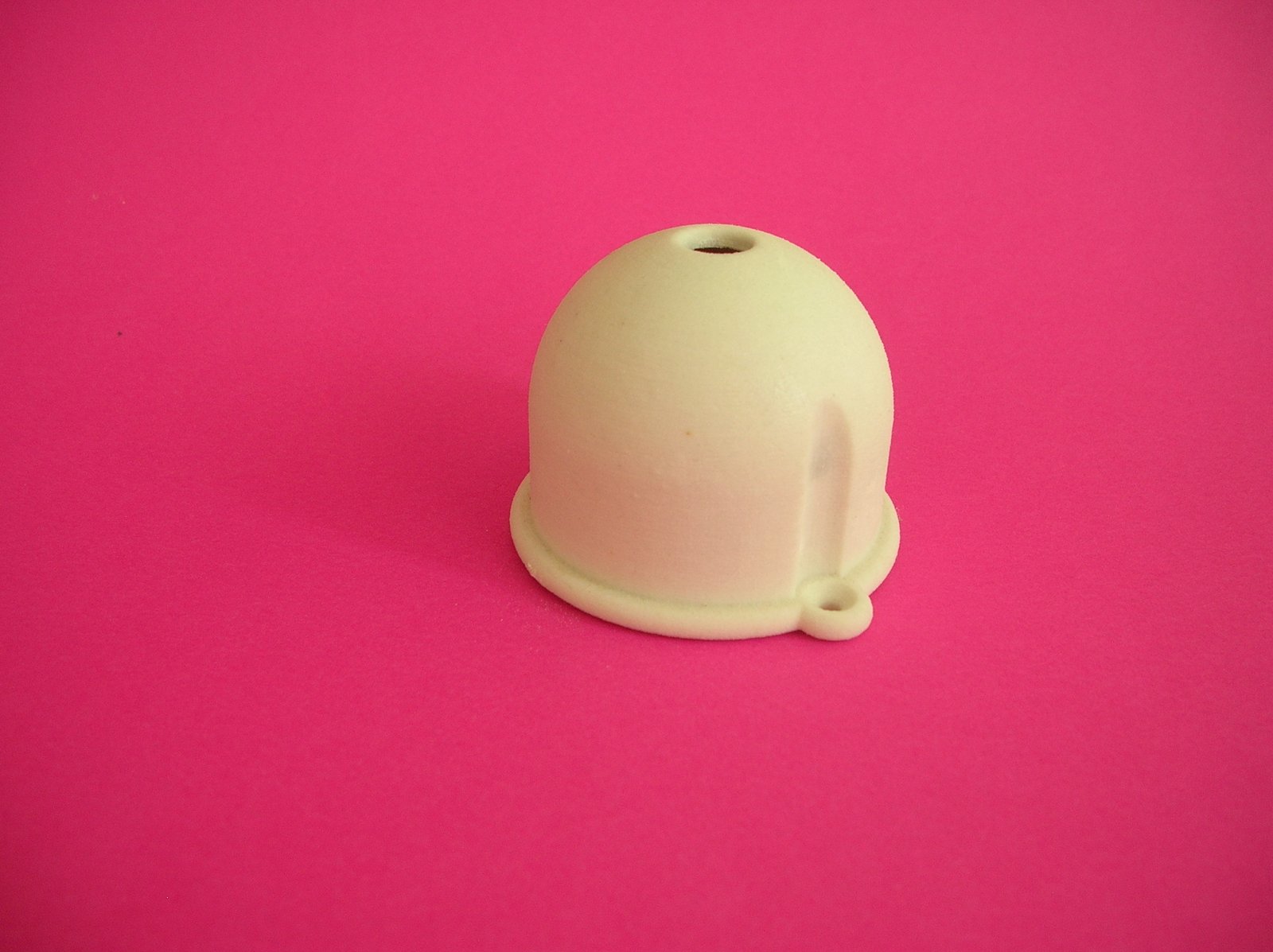

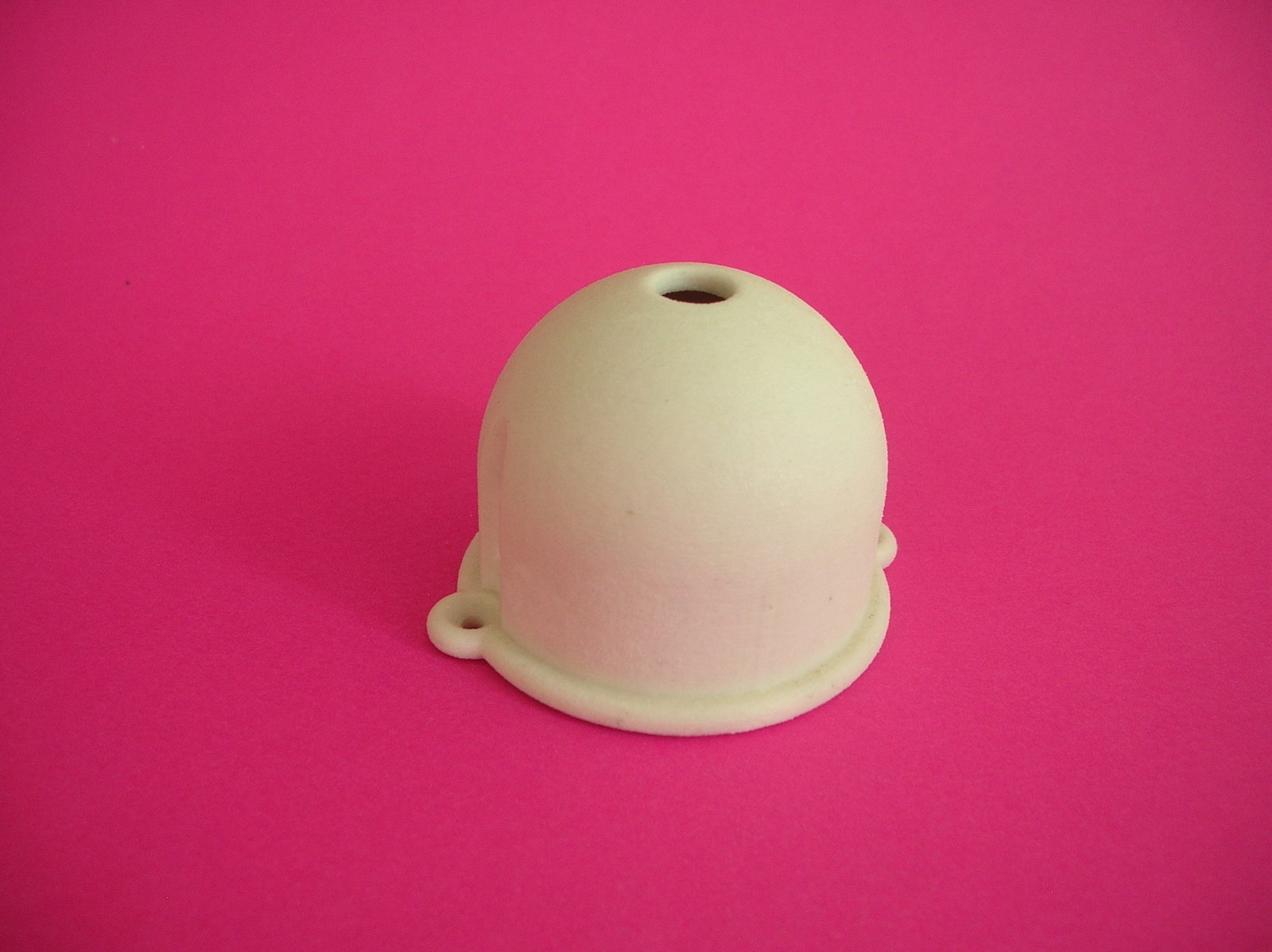

I did similar work but with the Project 360 in chalk dust. The model has a diameter of 50 mm. about (I am attaching photos). But long ago I did it with the ABS and came pretty well. The diametrro dell’uggello is fine to 0.4, you probably need to set the best 3d printing values.
There, hello good job.
wow the finish of this is great
